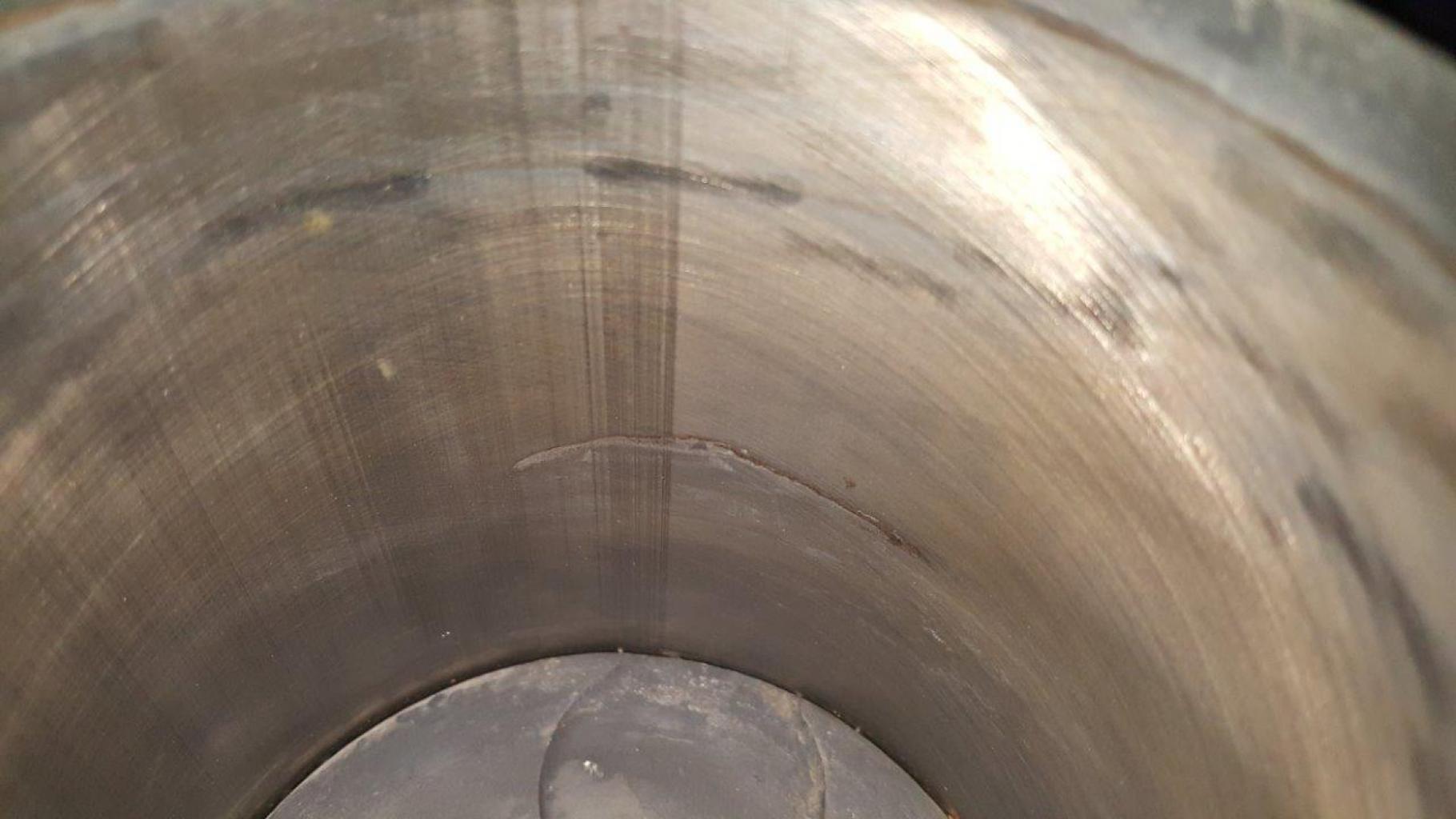

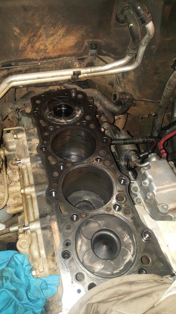

Are these pictures of the inside of the head or the block? Sorry, might be silly question but I am not mechanic. I am still intrigued to know why my old Snoopy never got right perfectly after my rebuild and it seems you are walking the same route unfortunately
If this is the block and the head is OK then maybe just get new block? Dont know cost on that? If this is the head then a new head is not that costly in the bigger scheme of things.

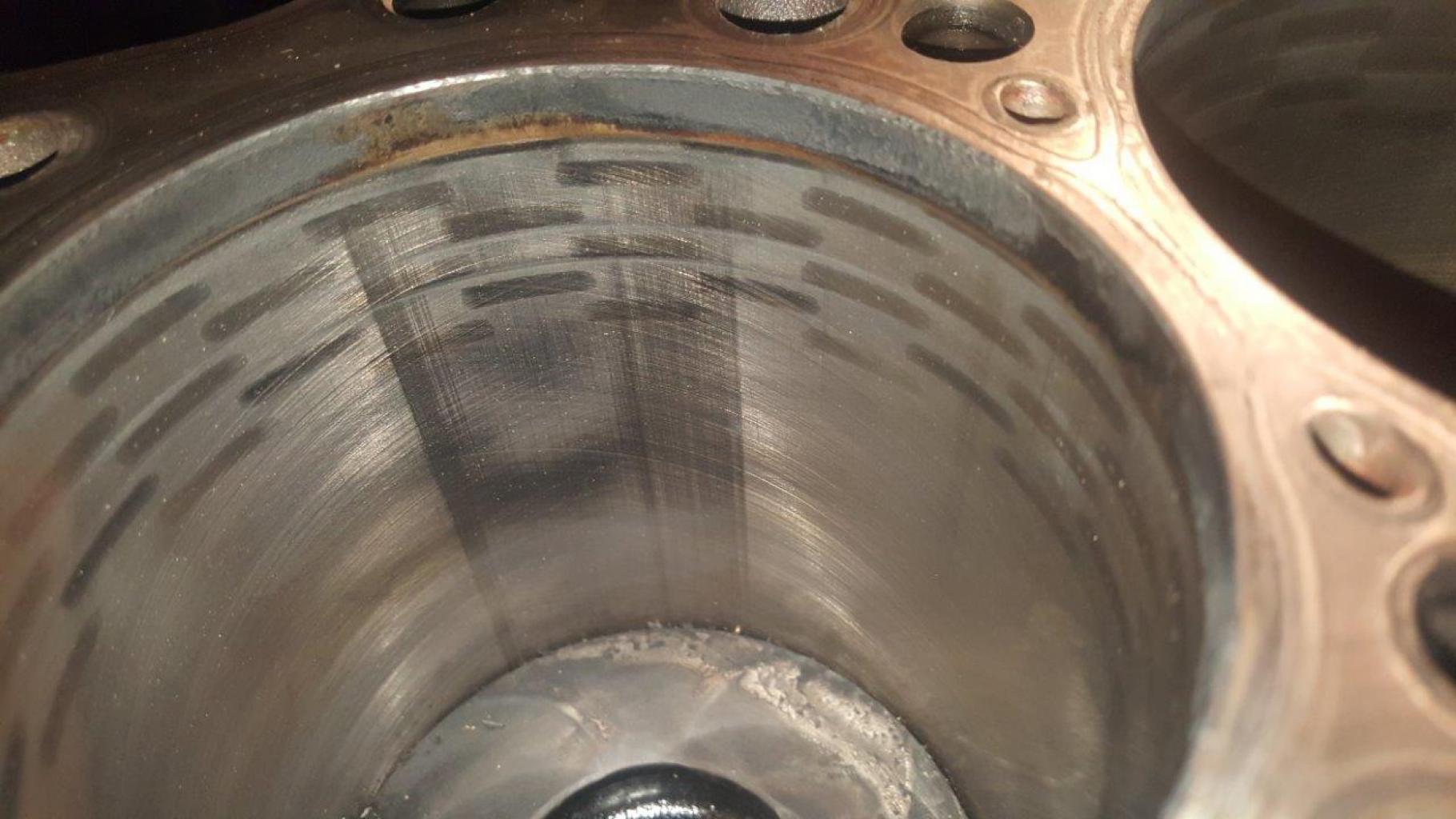

Cats,

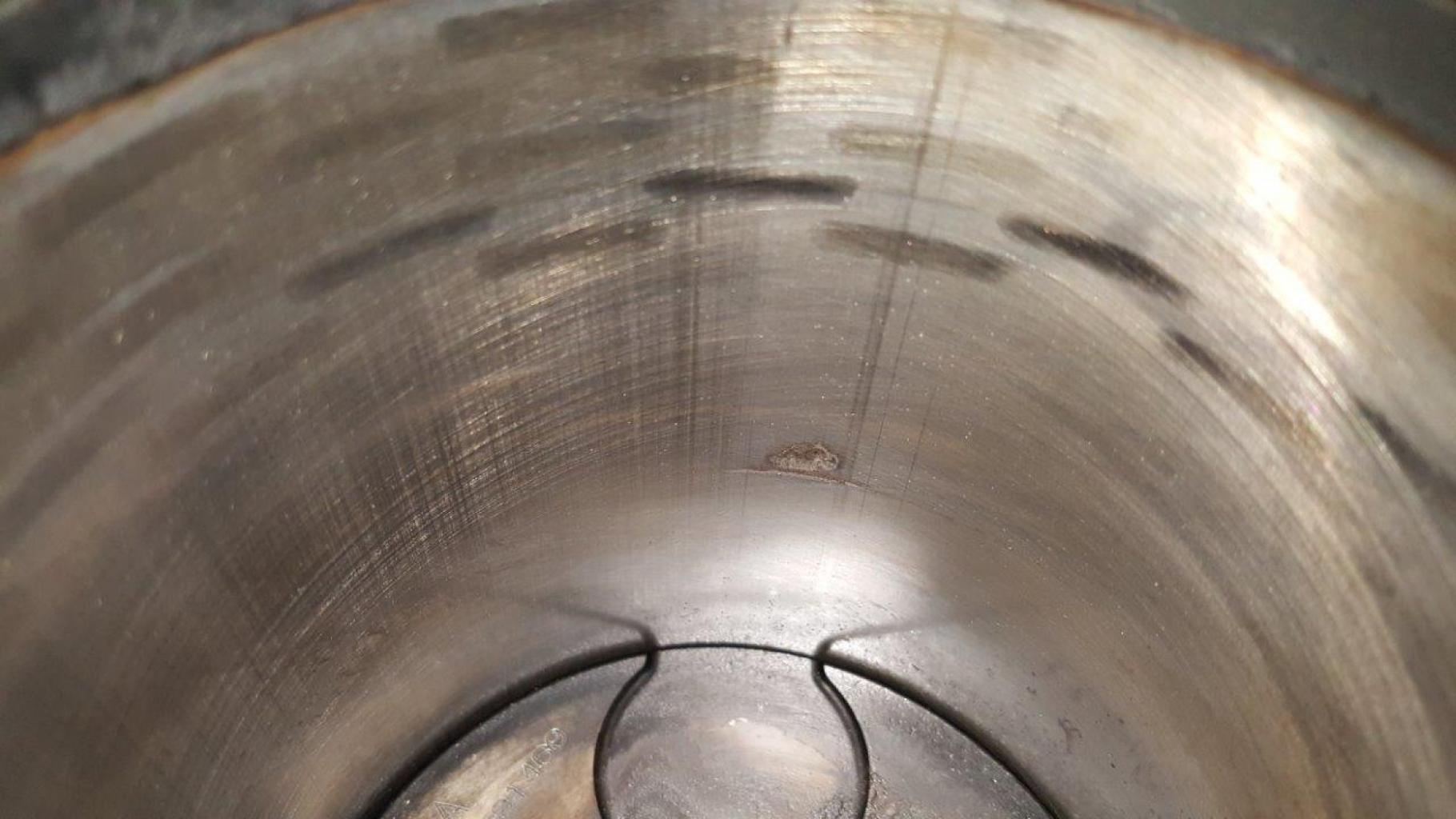

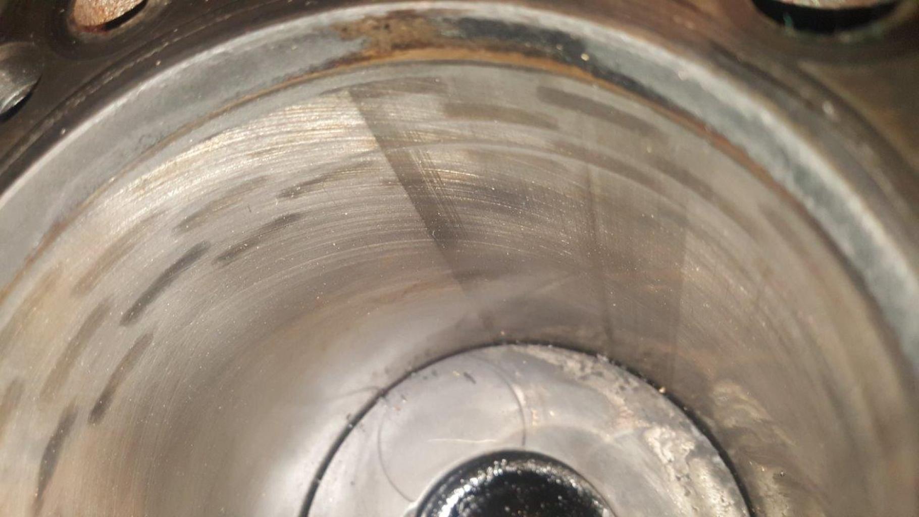

Those pics were taken of the engine block, looking down into the cylinders, with a piston just visible at the bottom.

Is that damage from overheating or coolant entering the combustion chamber?

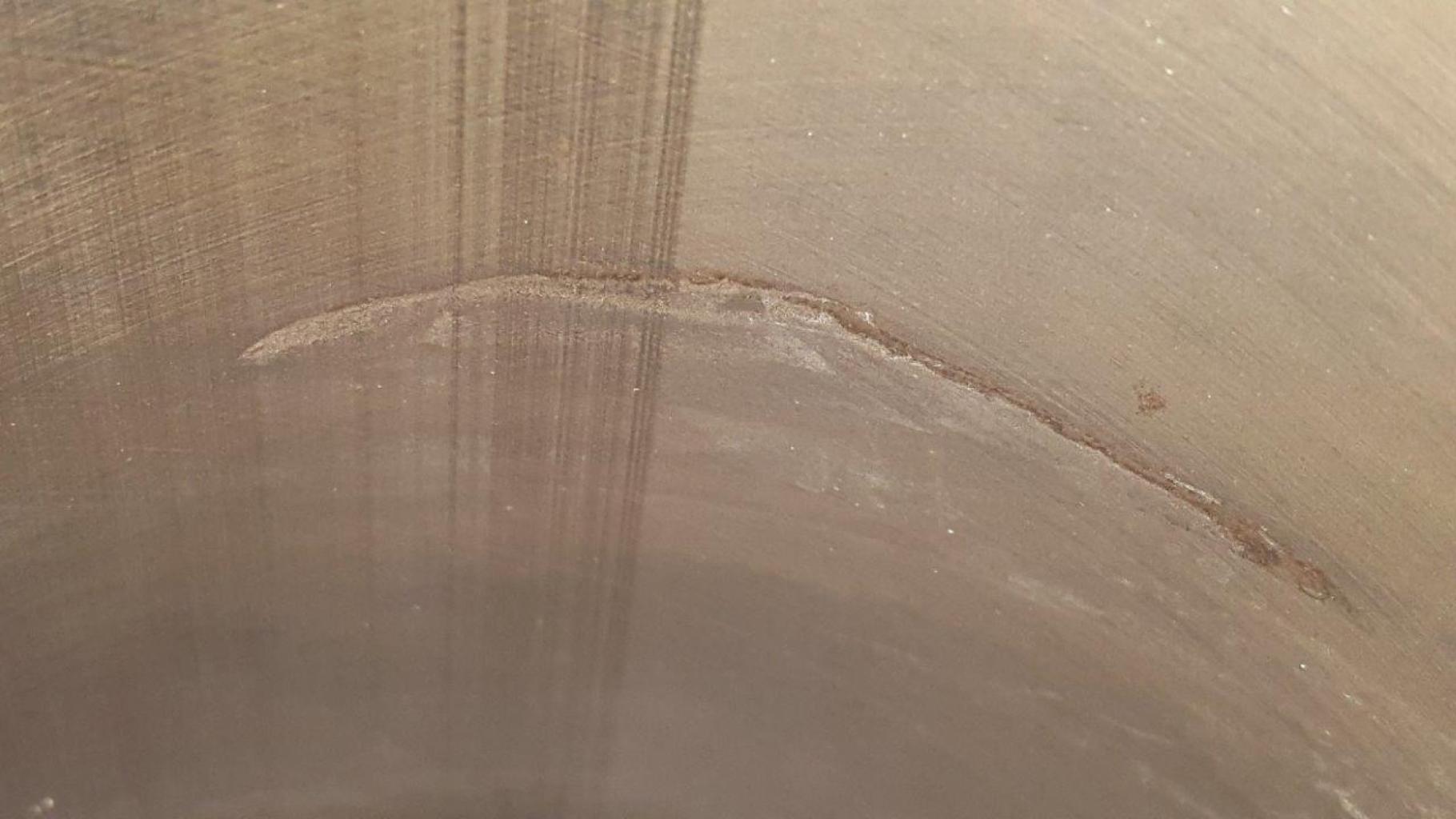

I am definitely having the injectors tested again but unfortunately I have been a bit busy this week at work, it looks to me like the pistons hve damage on the top.
I had them tested at the beginning of the year and they were still in the dual pop pressure spec, and all had good atomisation of the diesel- maybe they had deteriorated faster than I anticipated. I am not sure why the sleeve cracked, but it and the pistons really look to be in a bad way...

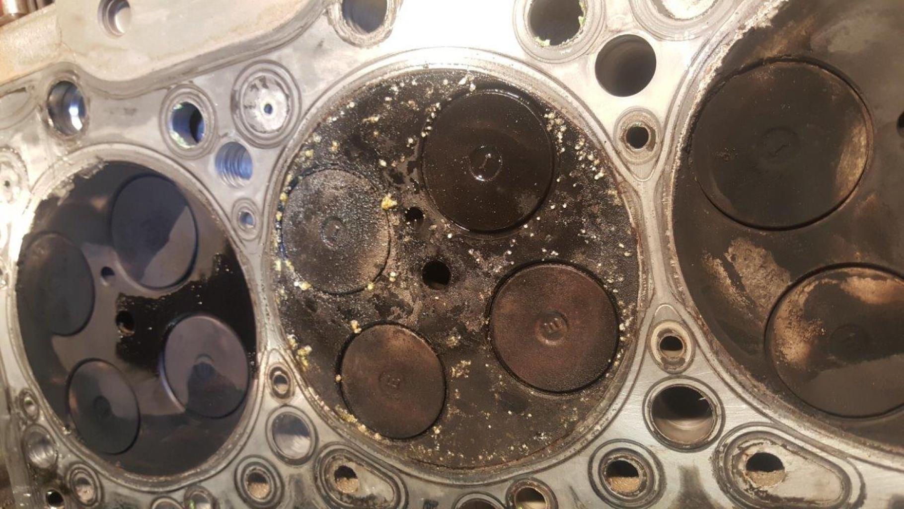

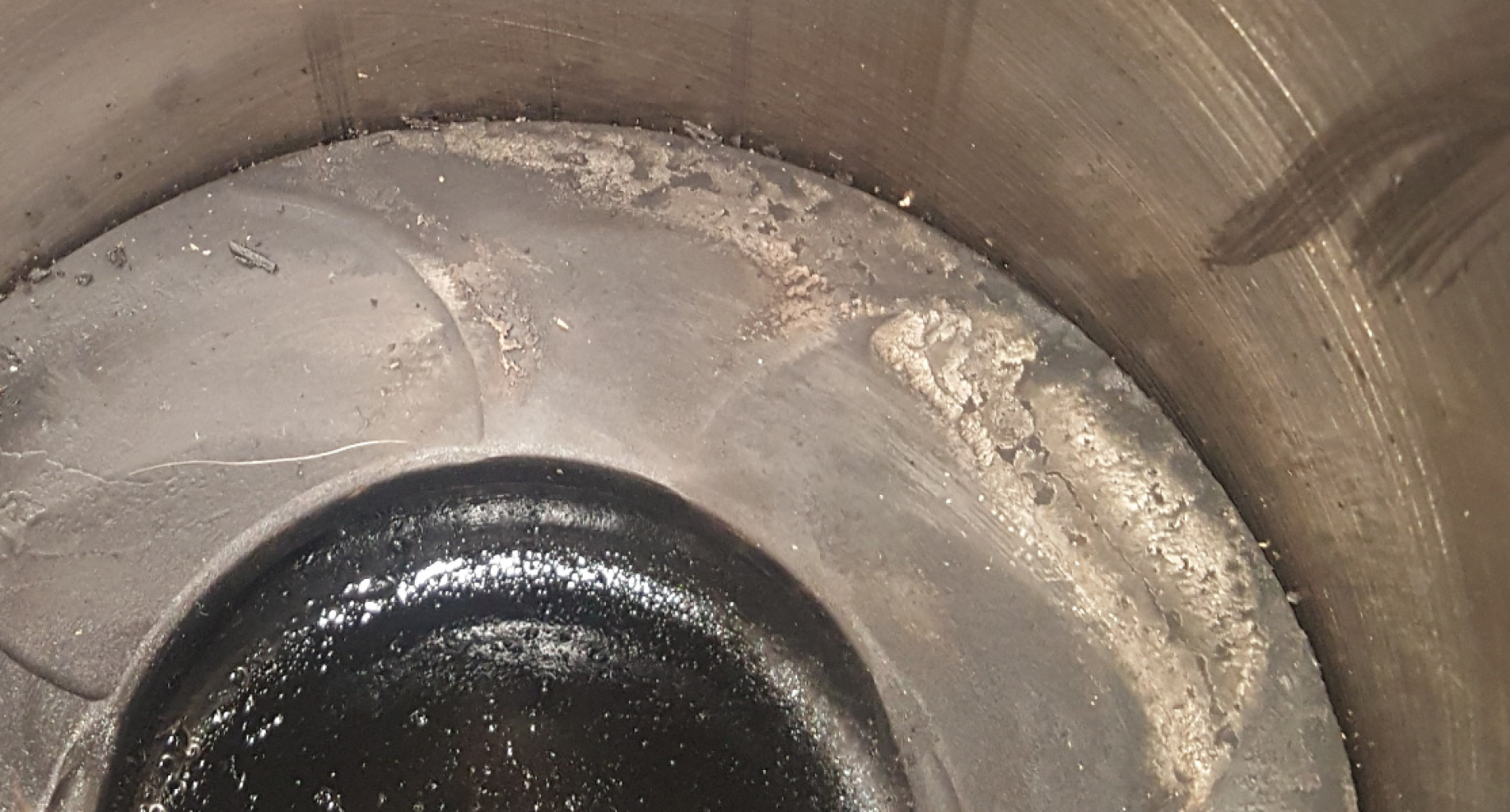

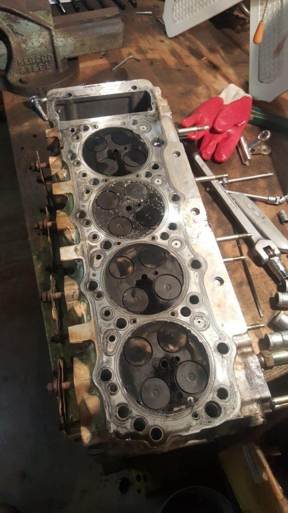

So those crystals are probably left over antifreeze that seeped in there and burned away? The pistons don't seem to have any holes or cracks in them as far as I can see on the picks. Are you sure the water did not just get in through a stuffed gasket?
HI Cats
Yes, those crystals are left over from the Anti-freeze, they are also in the exhaust port of that cylinder. I am going to try to take the head in for a pressure test for interest sake and also the injectors to be pop & spray tested again. I will take a video of the test for prosperity sake and post it here as well.
The gasket looks fine and I cant see any cracks between the valves, so at his stage I doubt it is the gasket (& hopefully not the head either).
See close up of piston damage here:

I have seen this happen on other vehicles before and have had a few motors re-sleeved before.
I made use of Automotive Dynamix in Brackenfell next to Goodhope Spares.
I done 4 sleeves and had it decked for R1800, The sleeves were like R75 each
Most engine re-builders/ engineering places should be able to assist you
Depending on the state of the side/skirts of the pistons I don't think the damage on the piston face is too bad, they might be able to clean that up and balance the bottom end for you when they done smoothing things out on the piston face.
The whole block would need to be sent in for the re-sleeving so the assembly would need to happen on a bench or stand making it much quicker and getting timing setup a dream.
