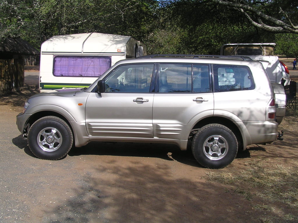

The 15" rims worked for me on my 2003 DID. I like the extra rubber for the looks and the softer ride. The 31x10.5x15 in stead of the 265x70x16 tyres makes a difference of about 0.1% on the speedometer. What I like the most is that the difference in price for BFG's will be about R600 cheaper per tyre for the 15" rims. You must do some shopping because you need a rim with a bigger offset than standard. The one I've used come from my previous Pajero (Gen 1 1987 WITH 3.2 DID motor)Waldo Fourie

I am about to buy some 15" Ford Ranger rims for my gen 3. I fitted one rim to the front to check for caliper clearance and this is fine. The rim sticks out about 25mm more than the original rim. Is this acceptable or will it cause fouling of the tyre on the fender?
