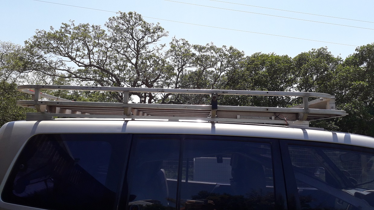

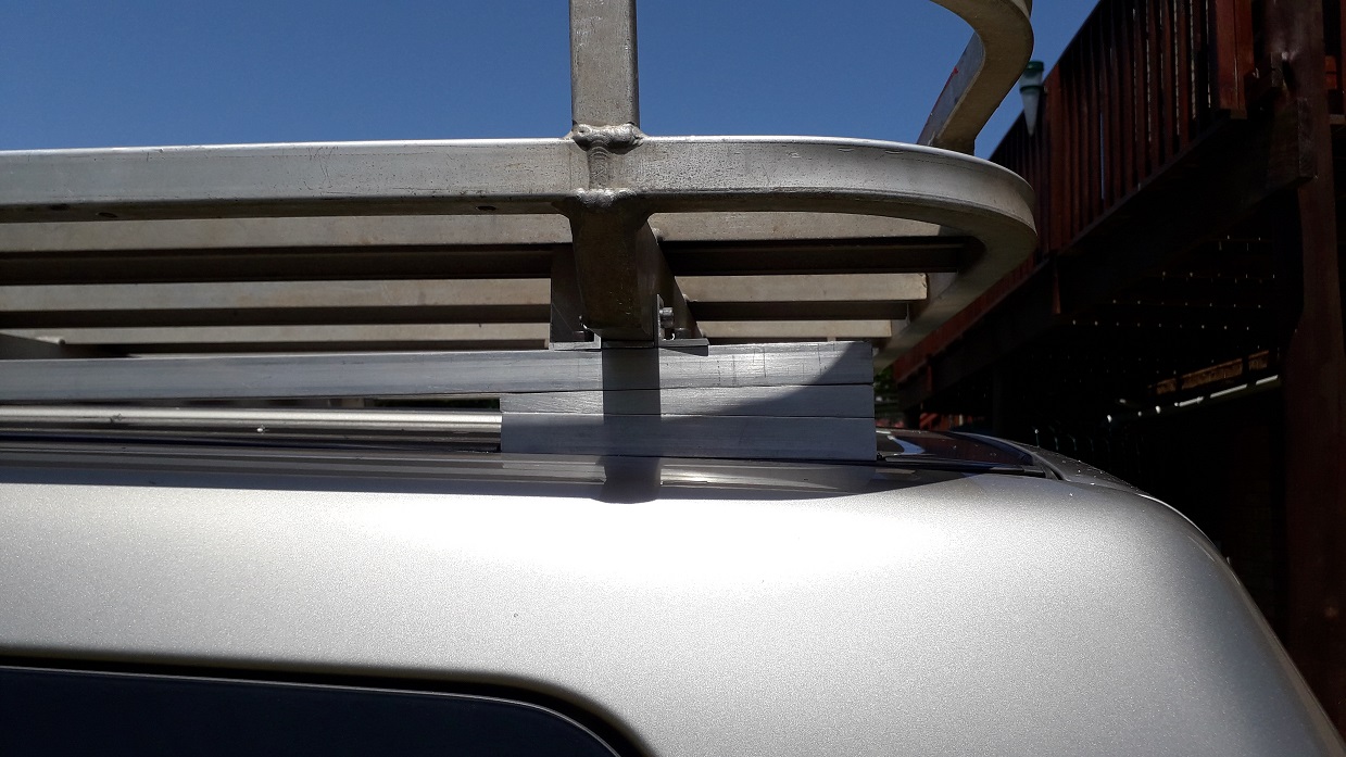

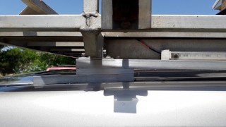

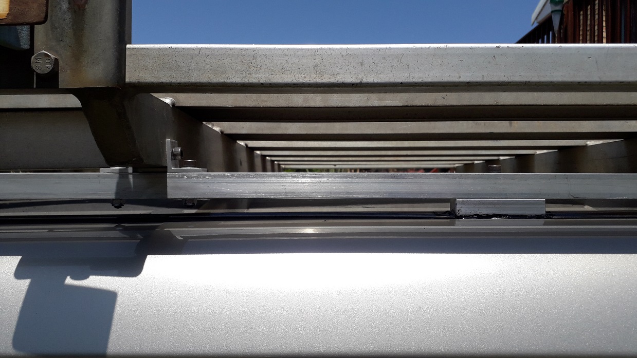

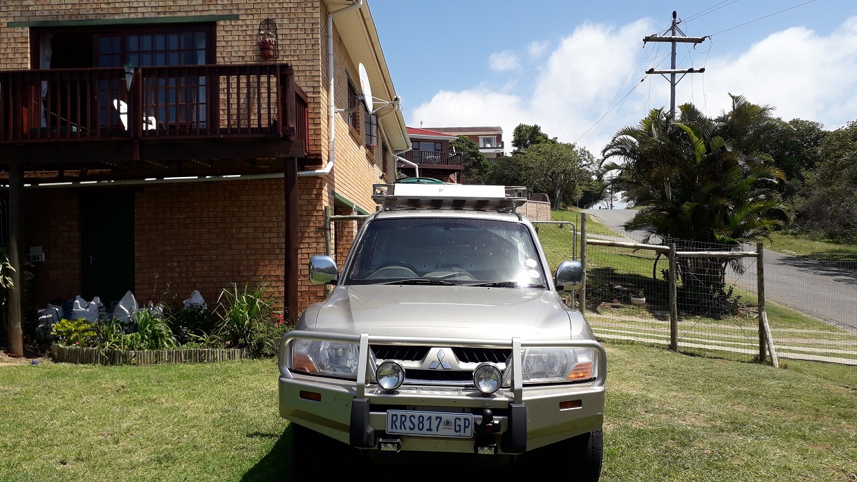

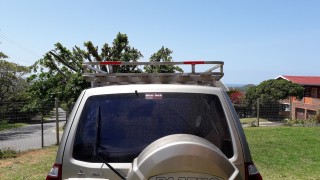

I recently transferred my roof rack from my old Nissan Sani that I had custom made some 18 years ago and which served me well. I debated mounting them on the existing rails but decided that they weren't ridged enough. I ended up stripping the roof lining to remove the old and attach the new. I used 20mm aluminium square bar to form a solid level rail and fabricated posts or feet also from 20mm square bar all using the same mounting holes as the rails. See attached photos.
Good luck with your build.
