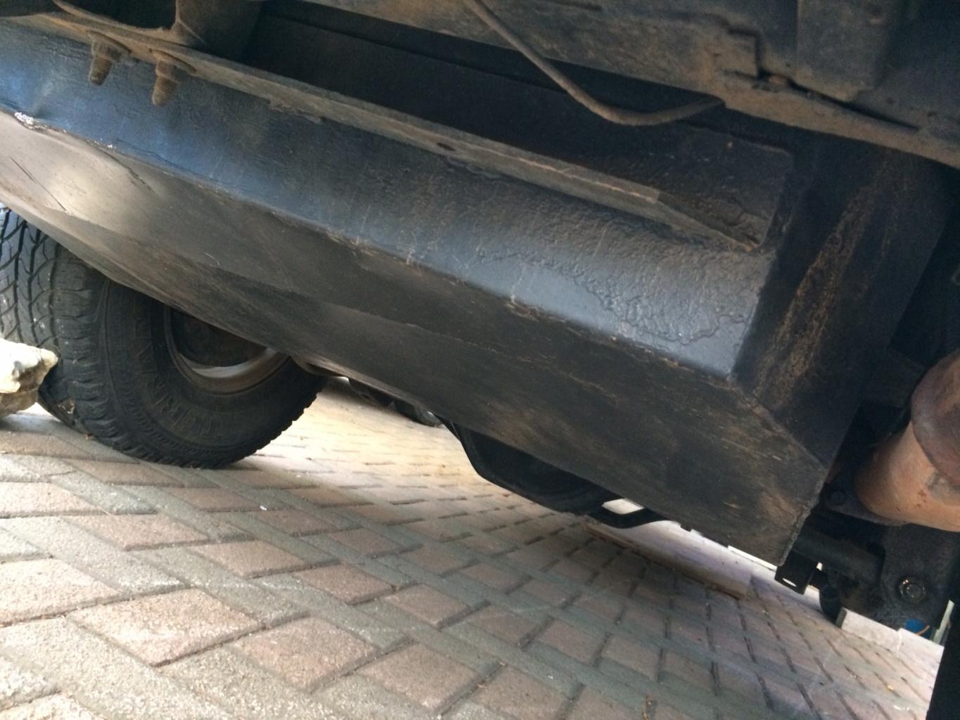

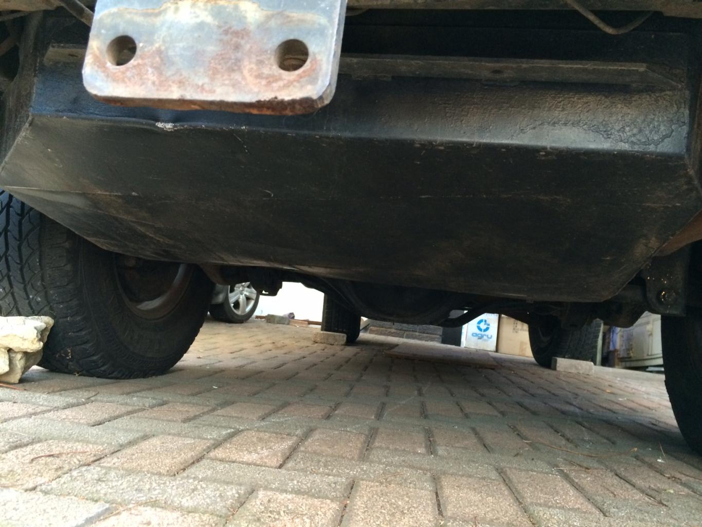

Taking a look at the under rear part of the vehicle, the retrofit bigger, long range fuel tank can be observed. I do have reservations as to how close to the ground this tank is.
Should there not be some sort of protection for the fuel tank??? "or" is the fuel tank deemed to be strong enough due to construction thickness???
Here are a few Pix of the tank from the rear.

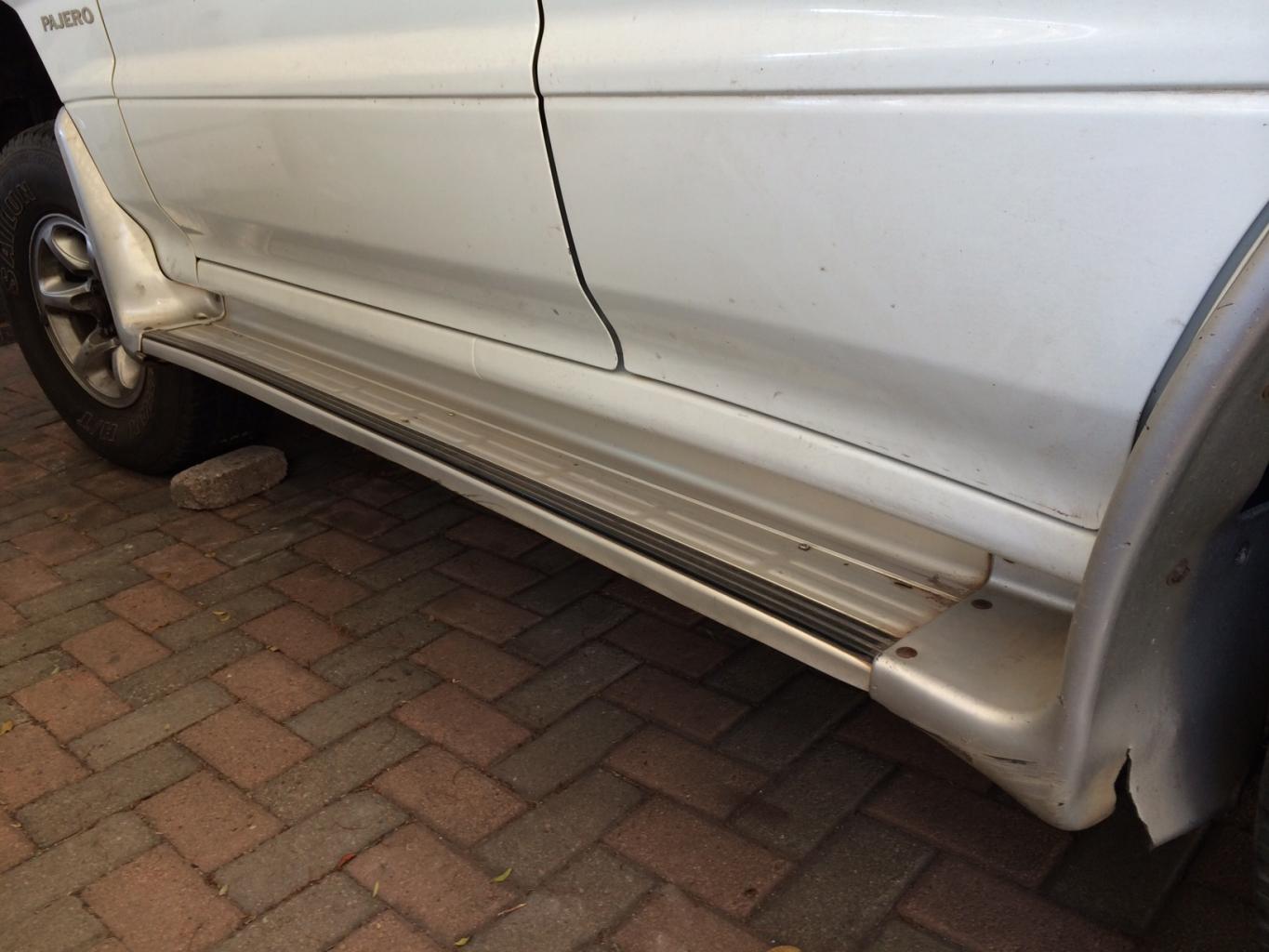

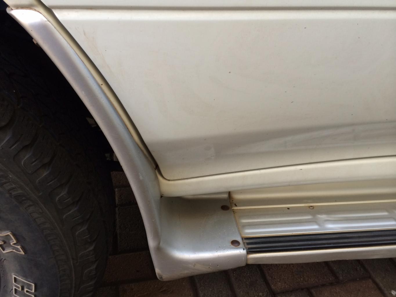

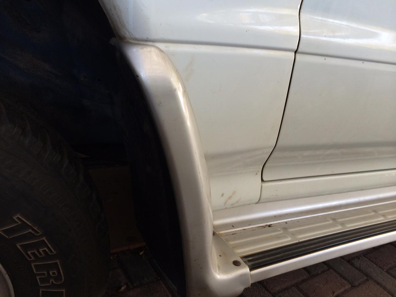

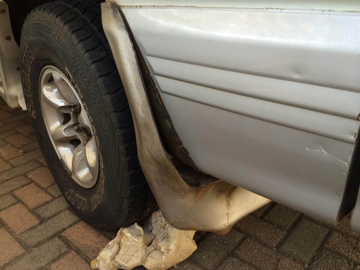

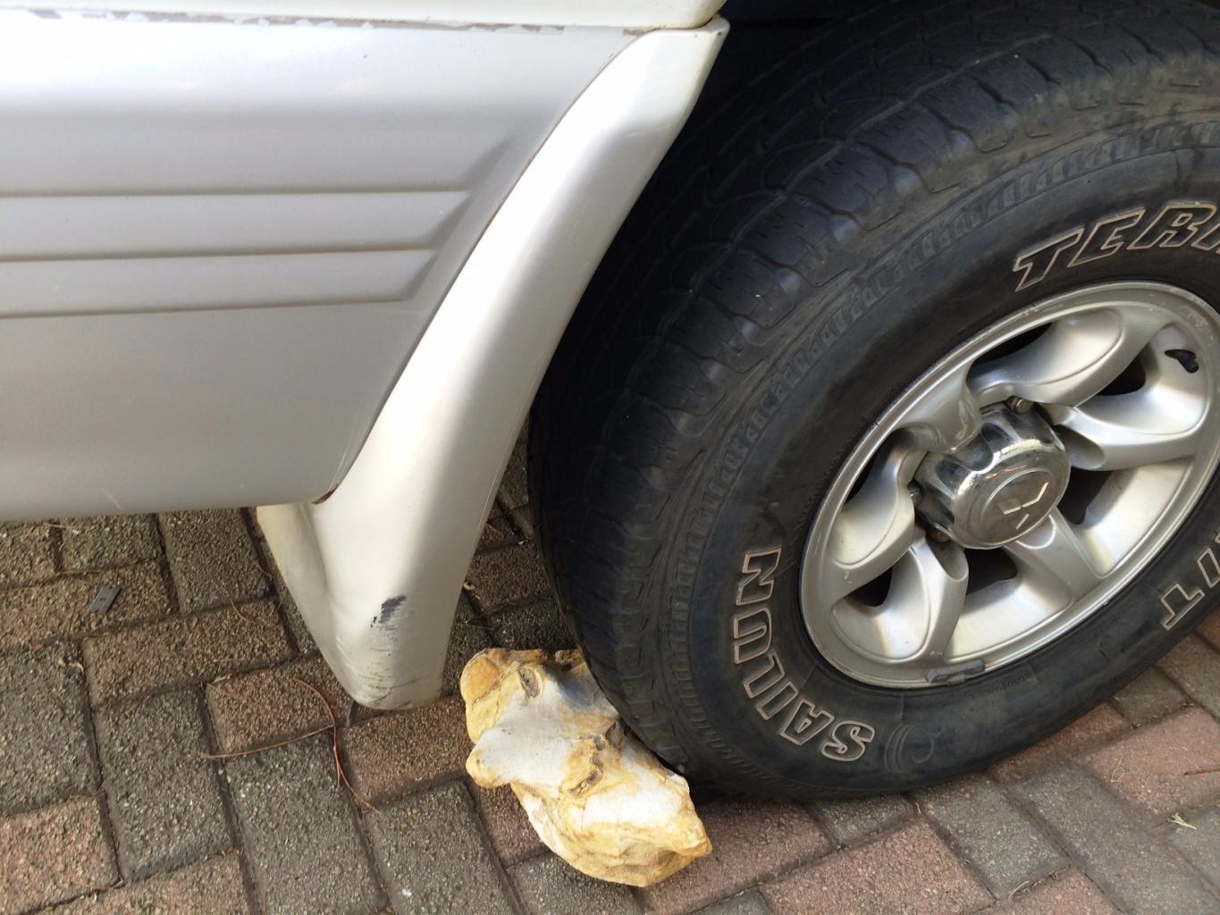

The running boards on the Pajero are in a reasonable condition. Except for one or two of the fender covers (if that is what they are called? might be mud flap covers???). The damaged ones, especially the left rear, is deformed due to the fender been dented on the underside. Hmmm.... Thinking rock sliders!
Here are some Pix of the current running boards and fender protectors. Will pull them off over the weekend if it is not too windy and cold to see what improvements can be made.
The first pic is of the worst cover. Left rear. The rest not too bad.

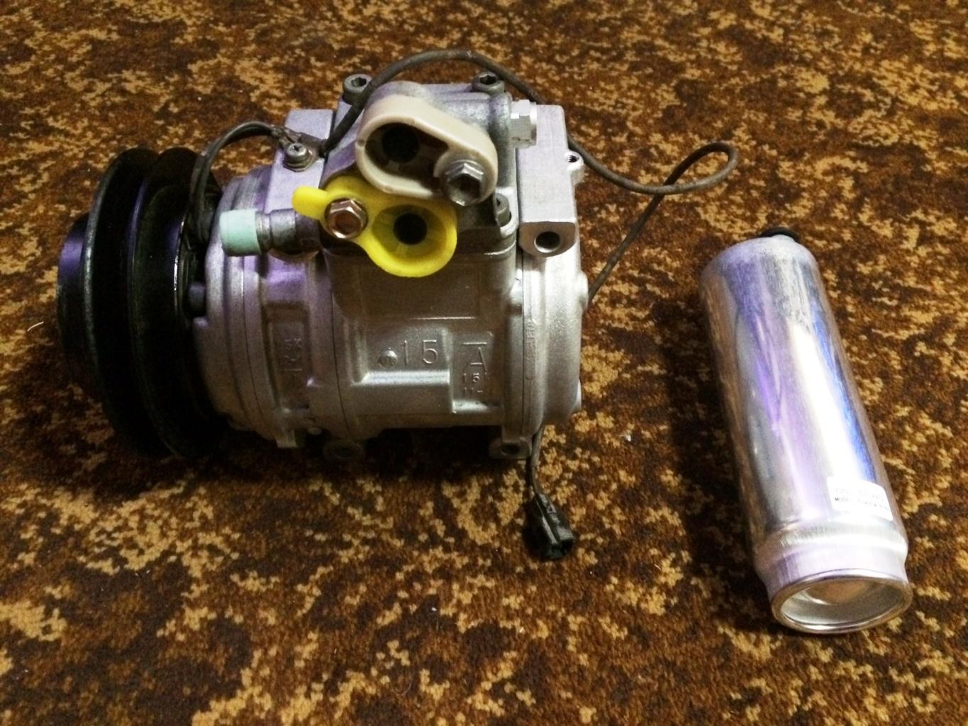

Got a call from the AC guy today. The compressor and dryer is sorted and ready. So will collect tomorrow and add to the collection of reconditioned components. All the reconditioned and painted components have been wrapped in bubble wrap, stored ready for assembly.

Picked up the AC compressor and dryer this morning.
The piping and radiators will not be connected on assembly. This will be done by the AC guys when they check and fill with gas.

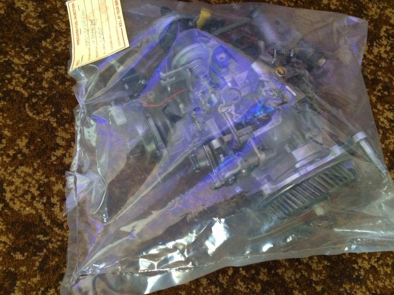

Got a call from the fuel injector guys today. The injector pump is sorted and will be collected tomorrow. Still no news from the machinists. They are in a similar area to where I will be collecting the fuel pump. Will pop in to the machinists and give them a gentle shove.

Short post today. Will update later when posting issue is sorted.
Injector pump sorted.

I only managed to collect the injector pump today. As can be seen in the previous post, it is nicely sealed and packed ready for assembly.
