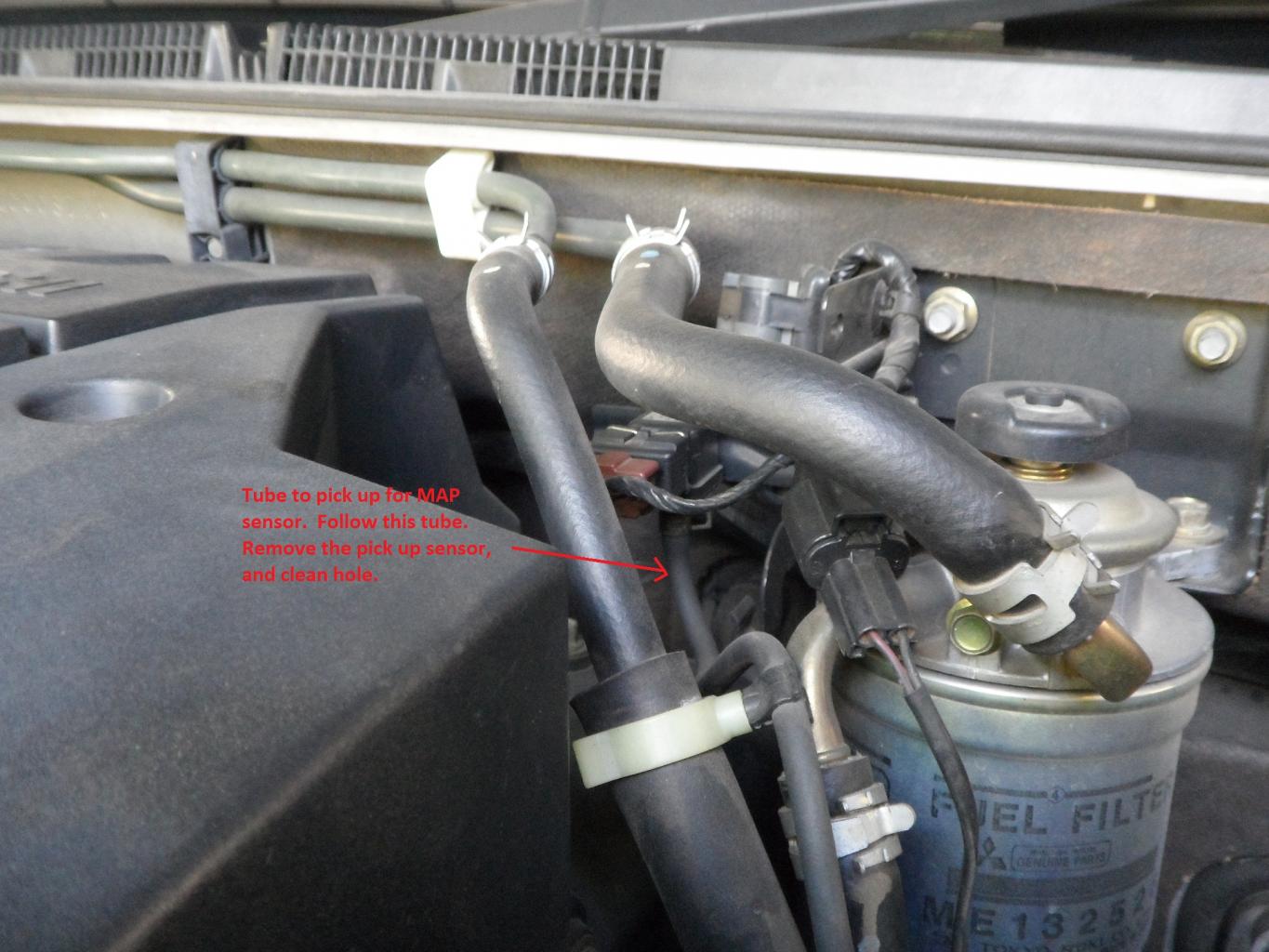

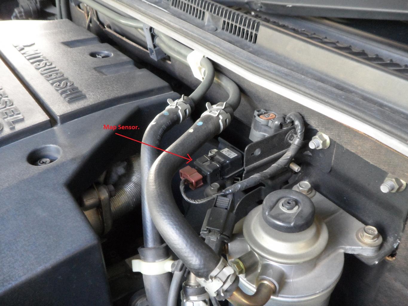

ate the traction control and abs lights go on and the car does not accelerate. It will stay in the gear to to which it changed until I let go of the accelerator.Only then will it increase it's speed slowly. I have a 2006 5 door D I D.
I have two mac's saying it is the sensors and two others saying it is the diesel pump. Same problem somewhere? Can someone help please?
