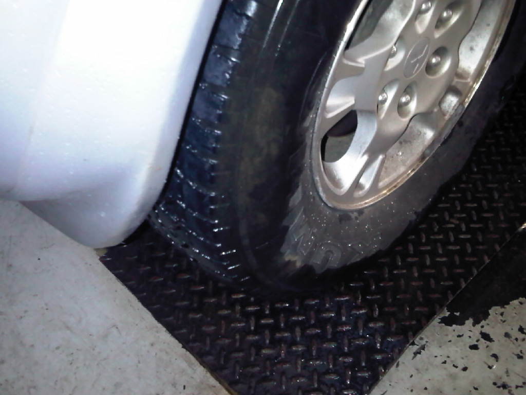

Not today actually but yesterday. My tupperware has always been loose and not very neat up to the stage where I have seriously considered removing it completely. (You will find my thread on this).

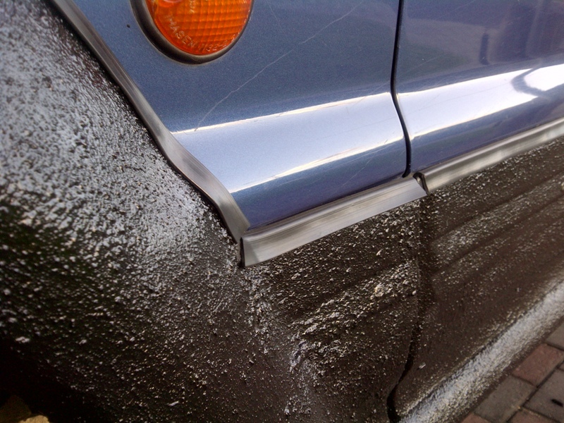

On the Damon trail the one panel came off completely and I have been driving around with this "gap"on my rear door for quite some time now. Well during the past week I sat down and replaced the rubbers that is between the panel and the metal. The slots where the plastic clips that holds it on has been damaged to a state where it was not usable and I driiled holes though the plastic at the same spot and used 40mm peel rivets and just "stuck"them to the car properly.
Repainted them with the same Durabak I used the last time to cover the rivets and I must say the result is very acceptable.

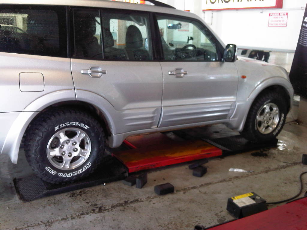

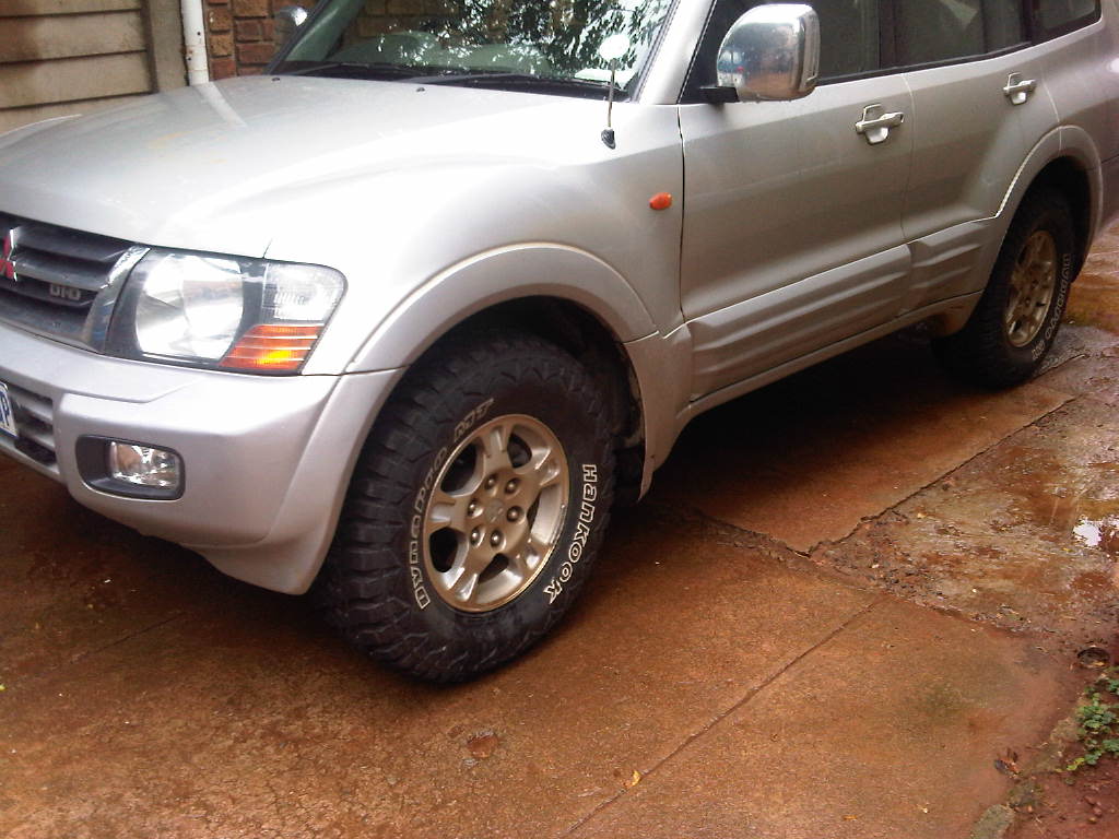

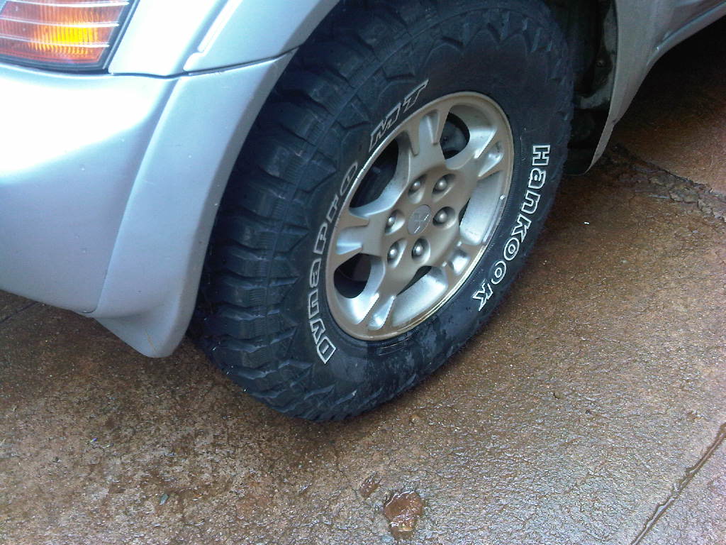

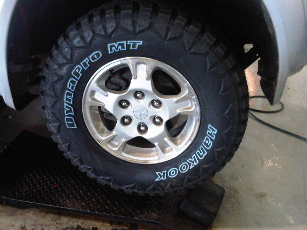

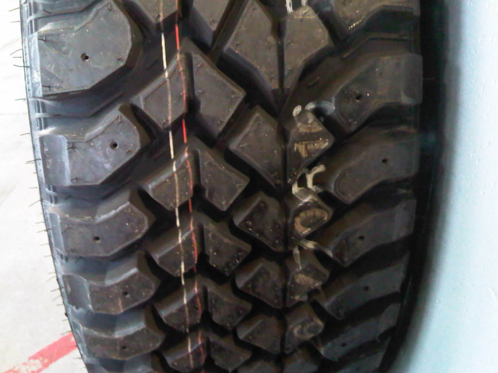

Fitted Geolander G012's all round. Went for 275/65/17 as I could not get them in 265/70/17.
So far I have only driven on tar and find them a bit softer than the Pirellis, but it is too early to tell. They seem fine in the wet, though.

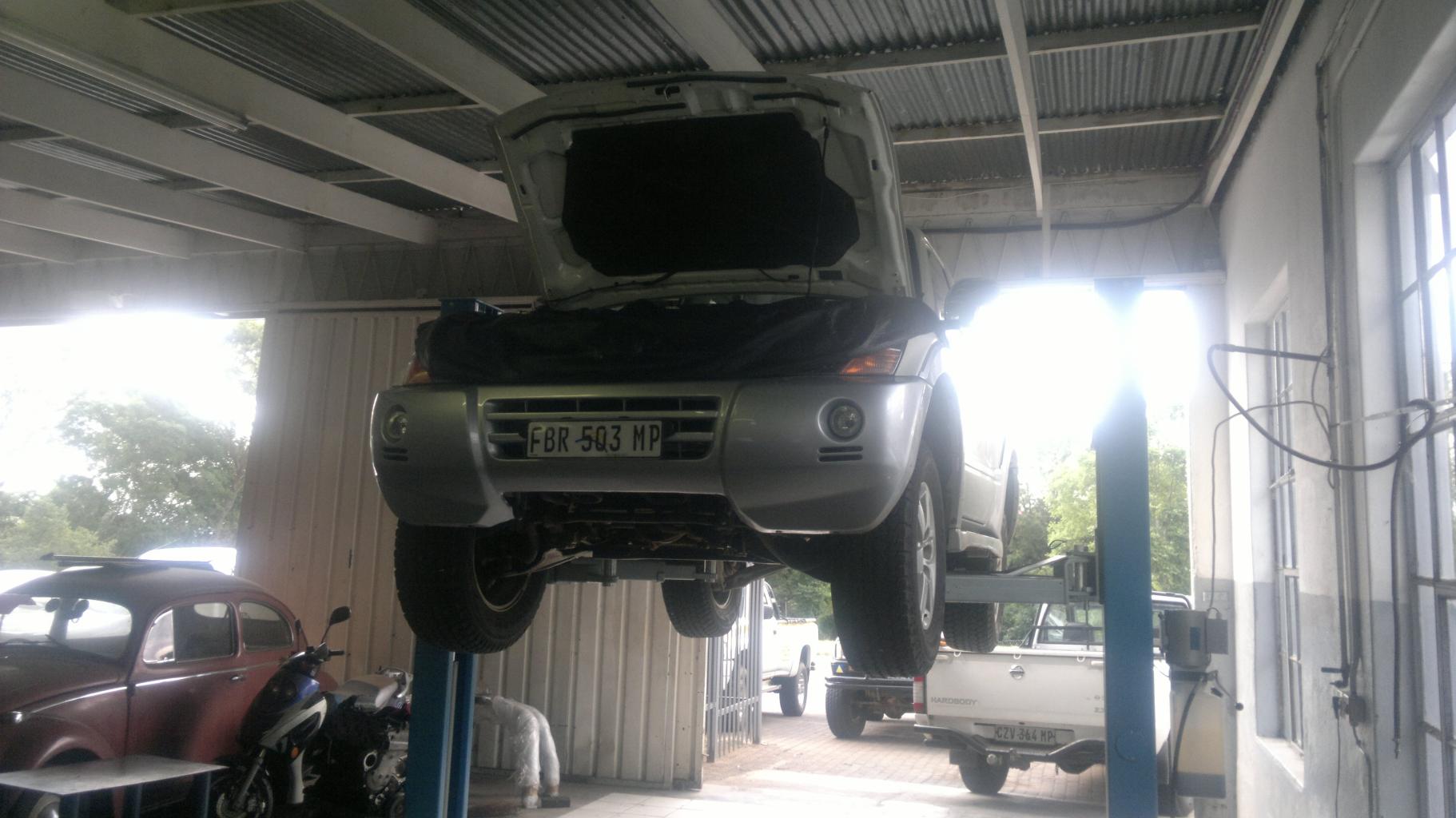

Fitted new L/H rear hub with handbrake shoes this weekend on my pajero got some water in to the hub!
