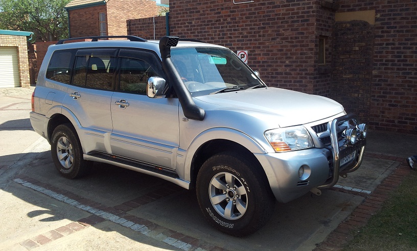

Re: Gen3 Snorkel Installation
@Nismo
We wont believe you until we see the photos......
Pretty Please
Pic
Hi Nismo,
Thank you for the pic :D
Looks great!!!
There seems to be a gap between the body and snorkel where the snorkel attaches to the body? IS this the angles of the photo and shadows playing tricks?
Regards,
There is a gap, it is about 10mm gap.
The top is about 15mm as I couldn't get the top bolt fastened, but I will try this weekend again to tighten the top bolt.
