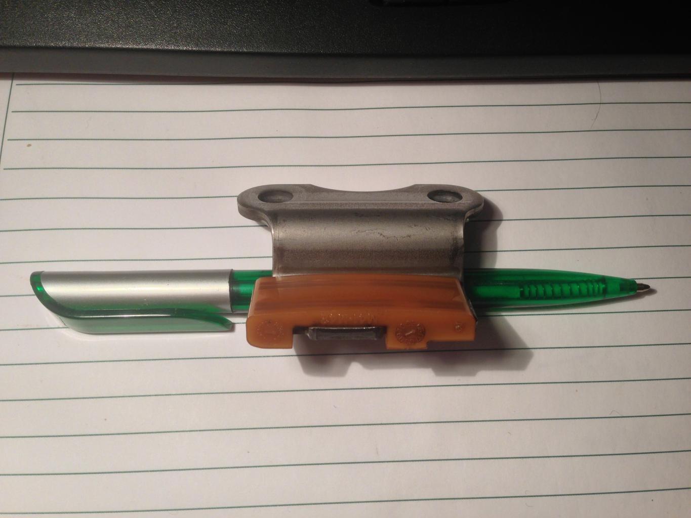

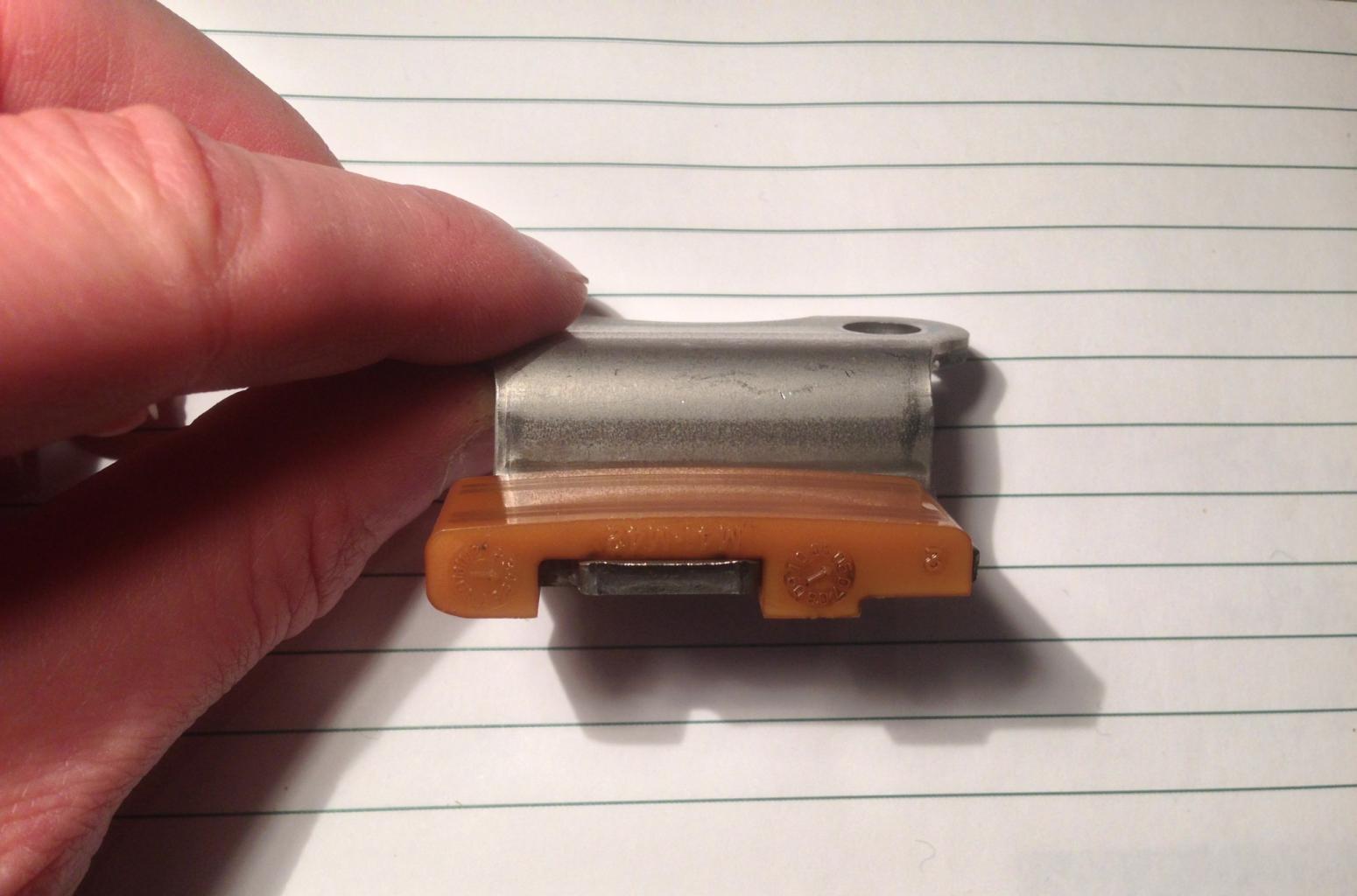

Final update:
All is good that ends good: I have my Old Paj back. She drives like before. OUF !
As a closure of this I sent a picture of the upper chain guide I just had from my mechanic.
As you can see, fortunately it has not been used that much.
TX again to all of you that helped me or at least tried to !
A.
