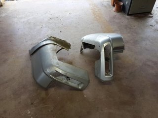

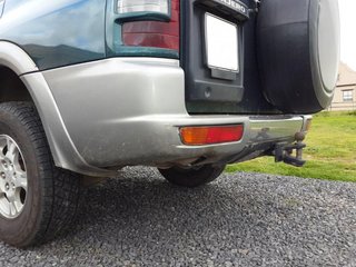

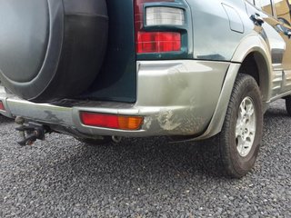

Its been a while since I did any work to my pajie, I was having withdrawal symptoms ;) so I stopped off at barnetts spares in stikland yesterday to see if I could find some rear plastic bumpers that I damaged a few months ago when I tried to do the "geut" at the top of matroosberg damaging my bumpers somewhat...
Right rear bumper
Right rear bumper
Left rear bumper
Left rear bumper
I found two reasonable condition bumpers I need to have resprayed and then I can fit them for, they cost me R 600 for both. I will probably fit them later this month once re-sprayed.

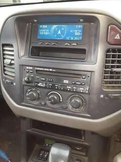

While I was there I found a 2004 3.2 did SWB which was totalled with the on board computer still inside. I bought it for R 850.00 and fitted it, it works seamlessly and is much nicer than the original black & white LCD that came with my 2000 model Pajero.
New diplay
New diplay
It has compass, barometer, and has much more info that can be displayed simultaneously. I think it is a nice upgrade, and now I can fit an aftermaket MP3 radio and not lose fuel consumption and range funtionality as the display button is on the unit itself.

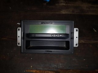

Old unit
Old unit
I still have the old unit which I fixed and is working 100% as per a previous post to sort out the loose solder connections which caused loss of pixels and time. Free to a good home, PM me if you are interested!

Wonder where I can get a 2004 center display. That upgrade is great!
Was it just a simple plug and play affair?
Yes, took me all of 10 mins to do the swap, two screws above radio and pull off dash surround and simple swap the two units out.
