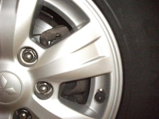

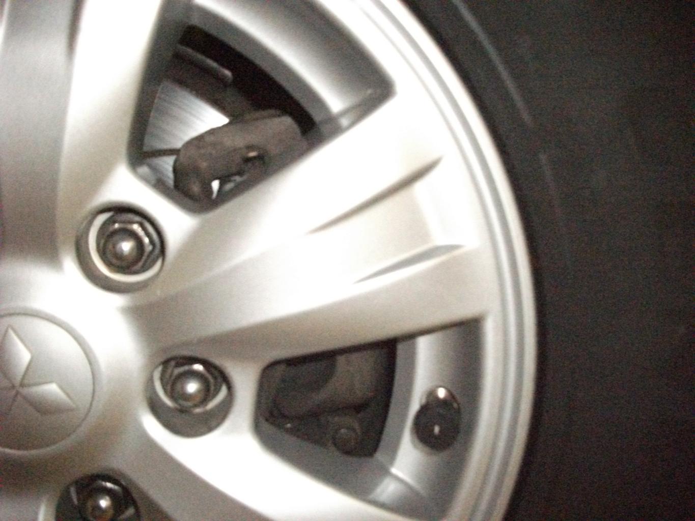

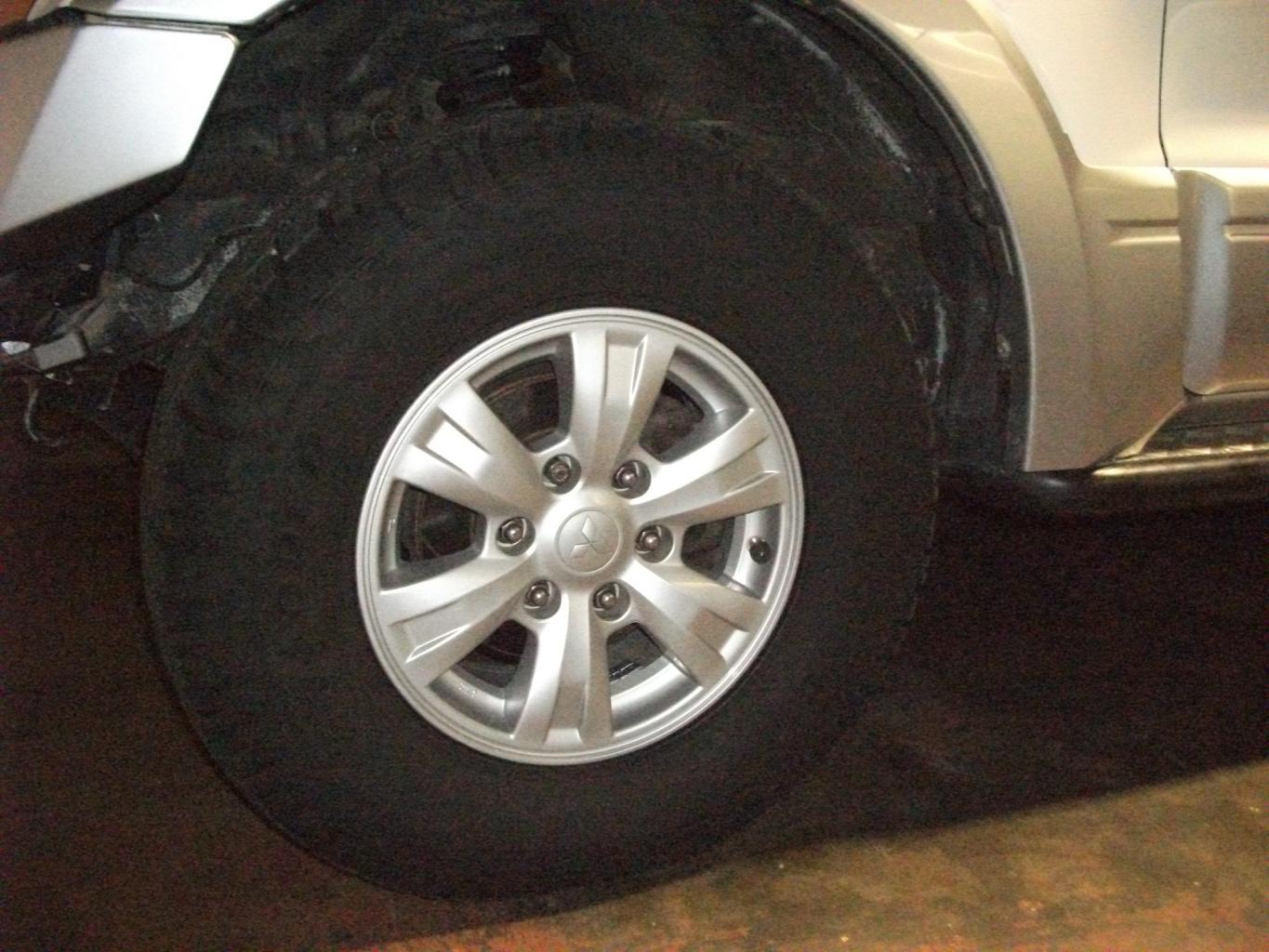

They fit my 2003 GLS. They are ET38 vs ET46 for Pajero, so "stick out" 8mm further, which is hardly noticeable.
Re: Triton 16 rims
Have you got the original GLX rims on your Pajero pfgrobler?
Re: Triton 16 rims
Nope, he actually has very nice looking rims on his Pajero.
