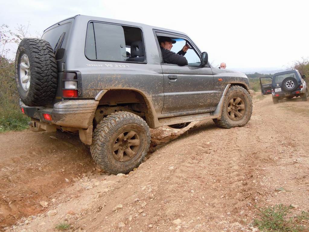

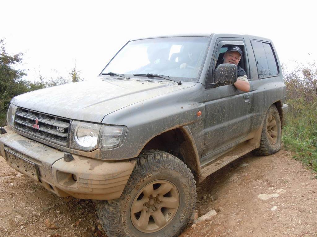

Hi Nino,
be honest, my feeling is really good. It could be also combination of Ironman suspension and Cooper Discoverer STT tyres. I'm using these tyres primary for off-road (for on-road I have Silverstone 31x10.5x15) , but no problem to drive hundreds kilometres on the tar, my cruising speed is usually about 120km/h.
There are of course changes in indicated speed (the real speed is a bit higher than indicated). The engine you can feel as less powerful but still enough (in compare with my Patrol 2.8TD6), and I have no experience regarding pulling power on these 33" STT tyres.
My only recommendation is to use rims with ET-30 due to better stability and tyres width 11.5" maximum (better is 10.5:)
Generally speaking, Pajero with Ironman suspension kit is more much better on-road and off-road as well, also with standard 31" tyres.
I'm using 33" tyres mainly for off-road, narrow tyre is better for Pajero.
34" tyres are too big and impossible to use without body lift.
Jenki

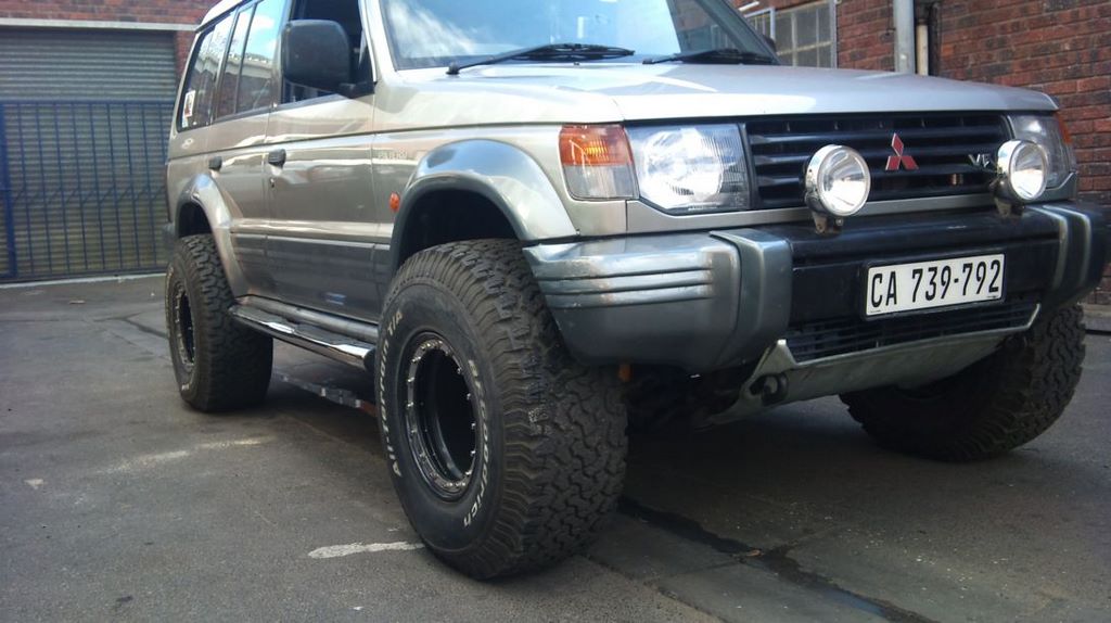

I've tried to use 34" tyres as well, but as you can see, don't fit.
You can see results here:
https://www.pajeroclub.co.za/forum/view ... 6&start=10

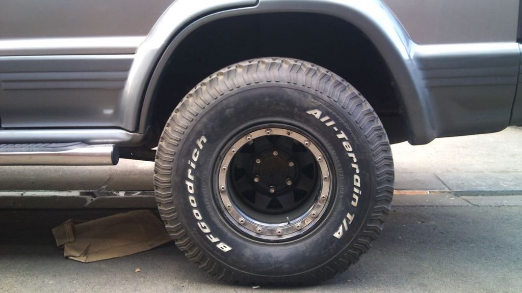

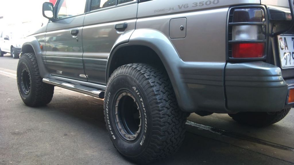

Jenki, I have a Gen 2 LWB with Old Man Emu fitted. I tried a set of 33" tyres, just to see if they will work.
In a straight line they run fine, but the problem comes when turning. The wheels start ripping the inner fenders apart.
Rear wheel
Rear wheel
Nico.

ghost_traffic wrote:Jenki, I have a Gen 2 LWB with Old Man Emu fitted. I tried a set of 33" tyres, just to see if they will work.
Nico.
Nico, the problem is probably tyre dimension 33"x12,5x15 (or 16) and value of ET on the rims. ET value has to be negative, to provide sufficient distance from the inner part of fender.
My tyres are are lent from my Patrol GR, the size is 285/75R16 (equals 33x11.22x16) and rims 8x16 ET -30 (with wheel spacers). This negative ET on the rims is very important (or you can use wheel spacers as me). It means, tyres are quite narrow and distance from inner fender is enough. Yes, there is sometime light contact in the case of full turn left or right, but it is never problem, in case of full turn the speed is minimal.
I'm definitely looking for narrow tyres for Pajero, the best could be 33x10.5x15 (equals 265/85R15) or 33x10.5x16 (equals 265/80R16).
Below you can see the real handling with 285/75R16 (33x11.22x16). It is not bad, but narrower tyres would be even better.
