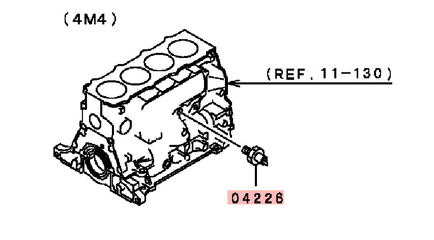

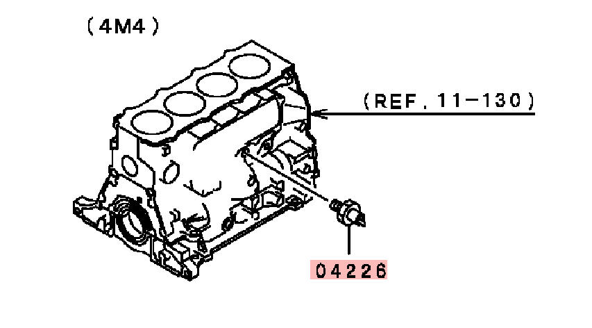

Can you guys post a picture or something what it looks like.
I noticed a bit of oil on the turbo side.
Do I have to drain the oil before I change the pressure switch?
Sorry for the dumb questions but we have to learn somehow

it's a pain to get to. Remove the airbox to gain some access. You can get there with a small extension, UJ and 24 or 27 socket.
Thread the new one first by hand as the thread is very fine and easily damaged.
If you have big hands, get a helper with small hands.
It sits almost exactly behind the turbo. Follow the single wire that leads to it.
No you dont need to drain the oil but believe me its not easy to get to the little bugger.
I had mine done on a lift wich make it a bit easier to reach.
