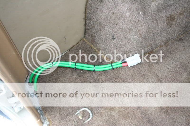

Features of my installation:
* removable battery box (due to no space in engine bay)
* 16 sq mm welding cables with soldered lugs.
* two fuses (to both batteries)
* Brad-Harrison type plugs in engine bay (see bottom right of first photograph) as well as in load area of the Pajero (still t decide whether to fit it to the body or not).
* (over-ride button and in-cab LED still to be installed)

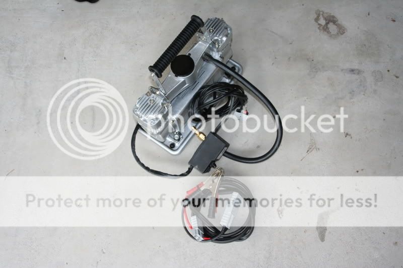

I converted my compressor to connect to the Brad-Harrison type plugs as well.
To make it possible to use it on other vehicles, I made up
* an extension chord (2m long, 6sq mm panel cable) with Brad-Harrison type plugs on both ends.
* a short cable with a Brad-Harrison type plug on one end and crocodile clamps on the other.
