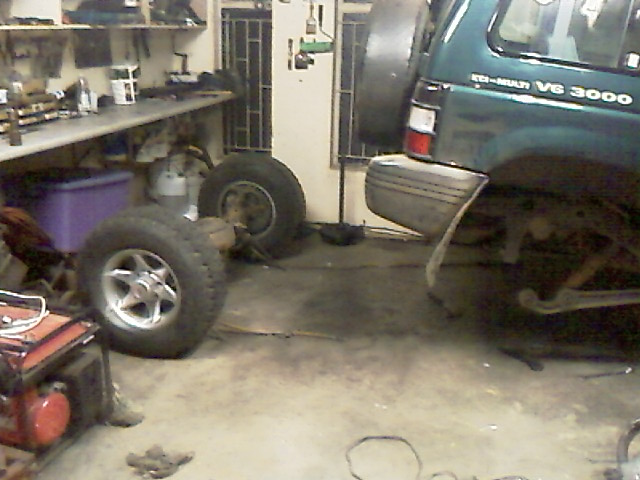

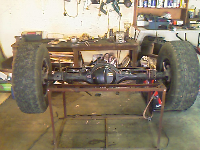

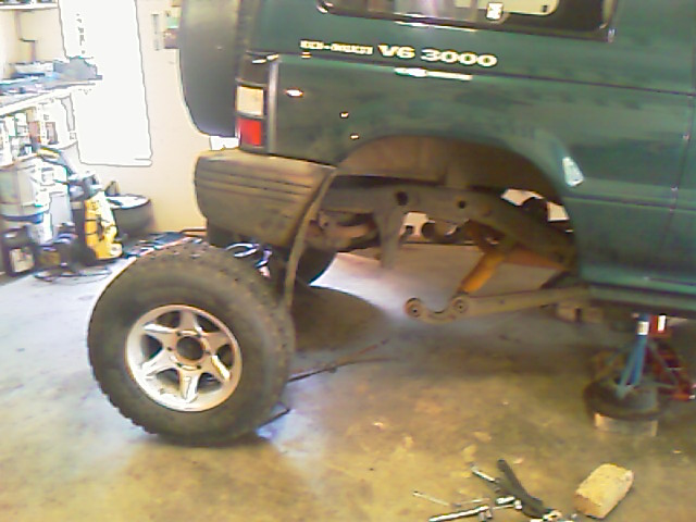

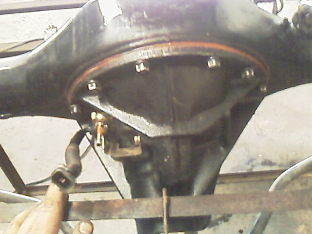

That is why me and so many other people like "vaja123" have gone through the exercice of fitting diflock to our Pajeros.
Vaja123 fitted a centre portion of a blister fender and did a very nice write up for it on this forum.
This weekend I fitted a different rear axle (Diff) to mine. The diff was from a LWB from which I removed the LSD centerportion, and fitted a lock diff centerportion. The reason why did not fit the lockdiff centerportion to my current diff is because the amount of holes differ SWB has got 10 and the LWB has got 12. Then I also discovered that the side shafts of the LWB is thicker. I also had to shorten the left side shaft by 16mm to fit on the difflock centerportion. The companion flange connecting the diff to the propshaft also differs in two ways, the splines for the SWB are smaller than for the LWB and the holes for the propshaft is on a different PCD.
All and all it is not such a big job and if I had to to it again I could probably finish it in a day.
I think the way "Vaya123" did it is the easier way if you can get your hands on one of this very rare blister fender SWB diffs.

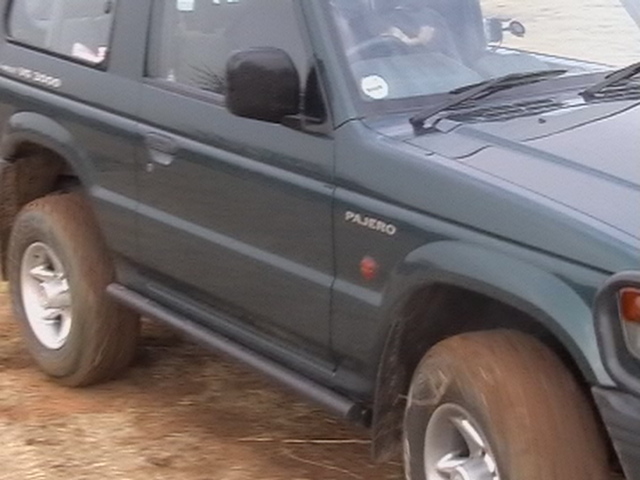

Rock sliders
Rock sliders

New lockdiff back
New lockdiff back
Difflock centerportion
New diff with difflock centerportion
Old diff out
Old diff out

Jaco Vosloo wrote:This weekend I fitted a different rear axle (Diff) to mine.
Hey Jaco – How long did it take to fit the diff (out of interest sake)? Looks like you have done a really nice job!

Well I was doing it all alone. Friday from 4pm to 9:30pm and Saturday from 7am to 15:30.
This excludes the time to check the diff backlash and shortening the side shaft and drilling new holes into the companion flange. (I have done this last weekend)
This is basically taking the old one out swap the brakes and put the new one in.
The most difficult part is to jack the car up high enough to get the wheels rolling freely out underneath the rear bumper.
It would also have helped if the car was clean before i started. Sand continuously falling into one’s eyes
