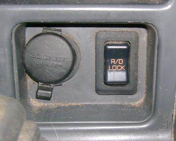

paw_by_paw wrote:...I have a 99 Blister Fender 3.5 and removed the diff the other day but with my limited knowledge just checked if all gears are looking good and not marks or uneven wear and put it back again...
Chris,
The Blister came out with RDL (Rear Difflock) as opposed to LSD.
You will find this switch:
here:
When engaged, this yellow light comes on in the dash:
Please read the manual on how / when to engage RDL.
