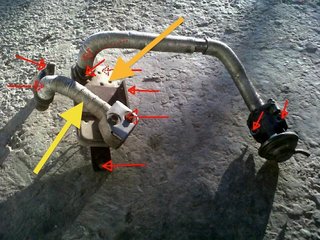

I am considering a EGR blank of, but I am still unsure how and where it should be done. I am also concerned about he effect - reading a lot of opposing views.
Also why are some people drilling holes? see http://www2.pajeroclub.com.au/forum/sho ... 727&page=2
I am also unclear if the pipe with the yellow arrow and the "box" with the yellow arrow should be removed. It look like the part with the yellow orange arrow is attached to the watersystem piping?
EGR with arrows showing doubts
Enjoy the weekend!
Llewellyn

I have just blanked off my EGR system. A question, is there a way of cleaning the Intake system without removing it and manually cleaning it? (Maybe a spray etc) What would you recommend regarding diverting the crank case breather from the turbo inlet?
Enjoy
Bez
Re: 2001 3.2 Di-D EGR Removal
Posted: Sun Nov 23, 2014 11:34 am
by 4ePikanini
Manifold has to come off to clean. Leave the breather.
