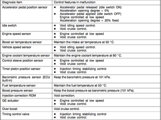

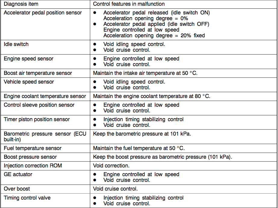

I'm busy tracking down the infamous Error 43 on my DiD and while checking all manner of things I discovered that the cruise control will disengage when (virtually) any error condition is generated by the ECU. Now, normally, when an error is logged you will get the traction control/ABS lights coming on or the CEL coming on depending on the severity. However, these lights don't appear to come on immediately if an error condition is created. I read somewhere that the error needs to exist for 5 sec or more or something like that.
But, the ECU will disengage the cruise control AS SOON AS an error exists. I have been using this to log the conditions under which my error 43 exists as its far more accurate than the lights. You don't actually need the cruise control engaged for this, just switched on. If an error occurs the green CRUISE light will go out.
Here are a few of the conditions under which the CC will be "voided" as Mitsu so nicely put it.
Bottom line. If your CC is switching off mid flight, check for codes. It might just be doing exactly what it is being told to do.
