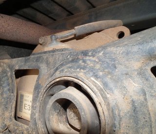

Hello Mooltjie in Paraguay. I see that you have had many replies already. Gerrit Loubser seems to have some useful hints. I do not, but last year tried to establish whether my Paj had rear diff lock. Several people thought not.
However, I took some photos at the time to record the physical facts but did not publish them. They may be of some interest in this discussion. The rear diff has a tube attached at the top, which I thought would be for the actuator, but it may just be a breather. I tried to find out where it went but failed. It simply disappeared into the bodywork. I opened the closed box under the R F seat, which is where Gerrit thought there might be an air pump, but found nothing obvious (as far as I can remember). Here are three photos.
Tube at top of Rear diff
