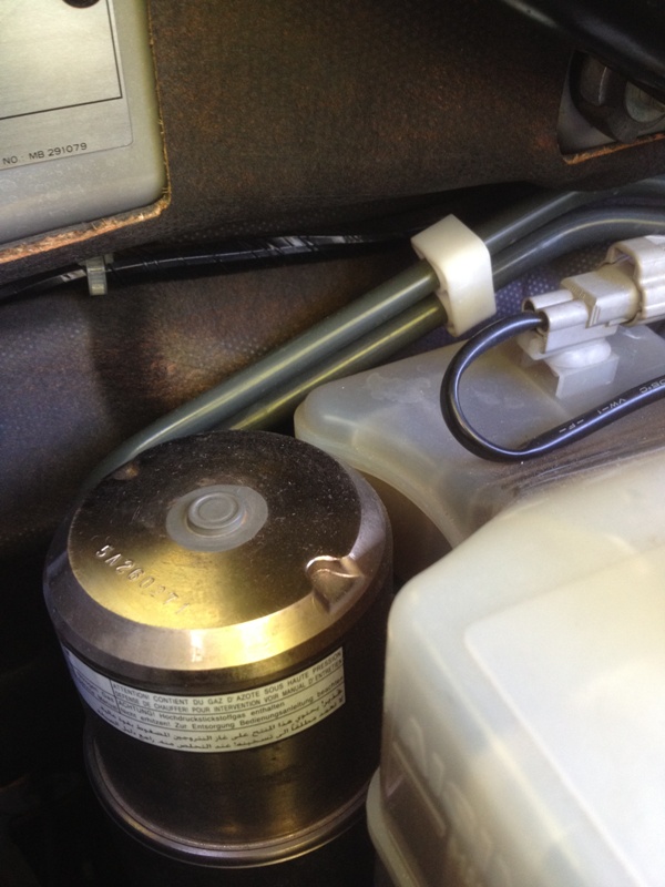

Check the black cylinder( about the size of a short fat aerosol can) in the engine bay on the firewall just in front of the driver steering. If it has a yellow dot or no paint on the top(I think but will confirm later) then it is still the old original. If it is a pink paint dot(again - I think so but will check) then you already have the recall item. Cost was around R3000 if I recall correctly if replaced outside the recall when mine was done many moons ago.
This is not to say it is your problem but if it sounds like a littlr bird chirping then it is 99% your problem.

Just to confuse the issue, I am attaching a pic of mine. If I have the right component, its not black and the paint dot is grey !
If I start the car and stick my ear close to the accumulator I can just hear it buzzing away for a short while and then it stops, so this all sounds normal.
I must clarify that the buzzer that I am querying is definitly an in cabin audible warning buzzer and not the noise of something going about its business.

I think your one is then the new one as the model year falls after the recall period in any case. If your buzzer noise is inside then it is definitely not your actual brake booster accumulator. It might still be something to do with the brake system though, but I have now dried up on ideas

Ja, that seems to be the right year for recalls from the info I have seen.
As a matter of interest please keep us posted on the before and after colour of the Accumulator and the paint dot on top. It may be useful for others.
