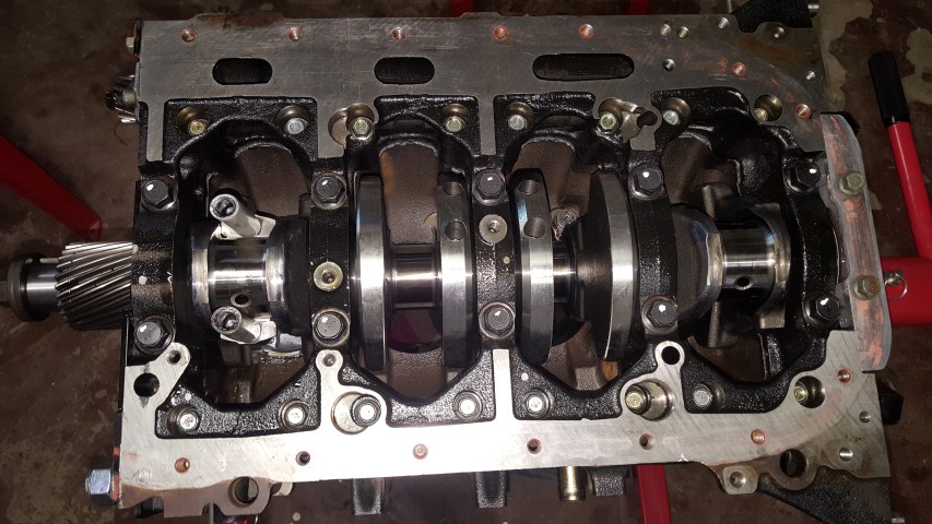

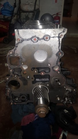

I applied the sealant, note the specific routing the manual stipulates around certain bolt holes:

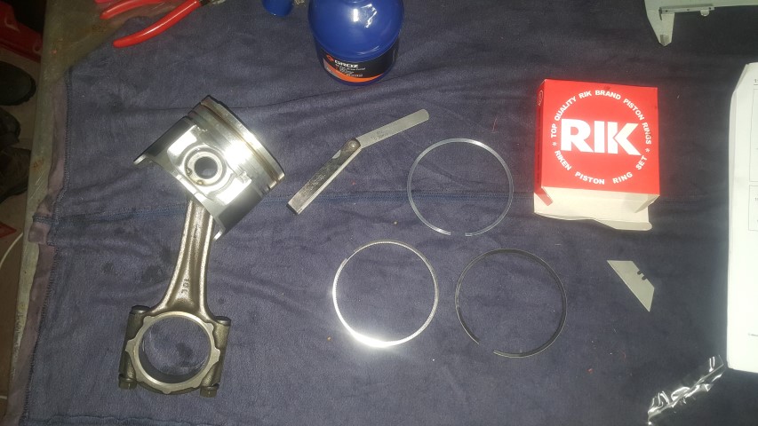

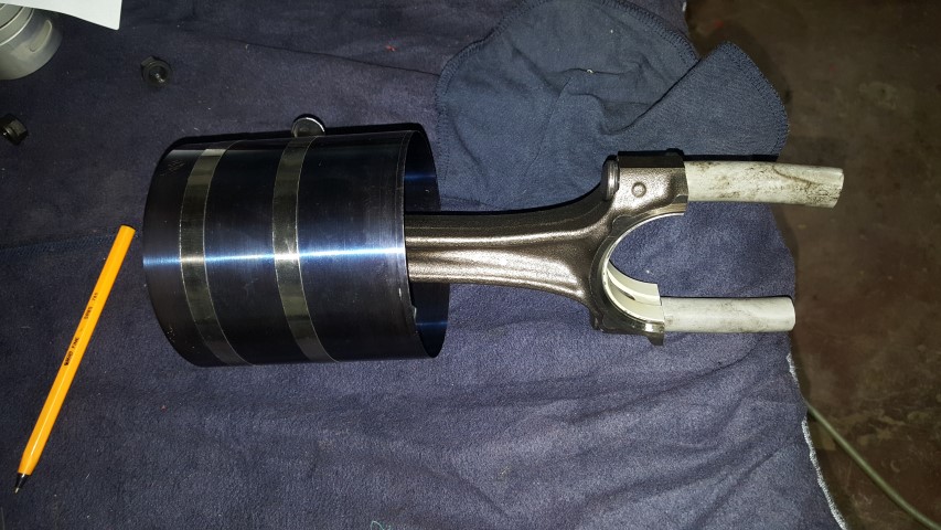

Once I checked the ring gap - (there was only one I had to file 0.08mm to make it fit) I fitted them to the piston. I then aligned the rings at 45 degrees to the gudgeon pin (factory manual spec) and compressed them with the ring compressor tool. The first and second rings ended up having the gaps 180 degrees apart.

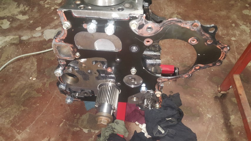

I then fitted the timing plate. You will have to find some additional bolts of right size and thread to hold it in place until the sealant cures, as it is actually held down by the cast aluminium timing gear cover plate.

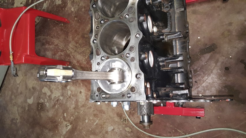

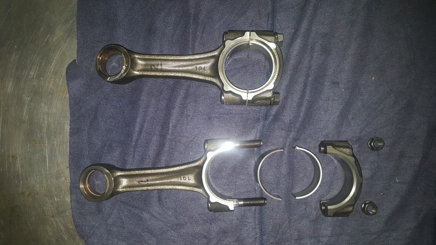

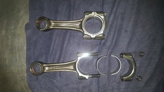

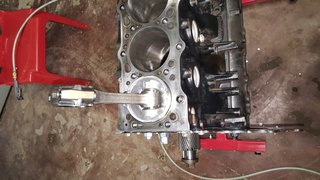

Old piston removed from conrod & new bearings

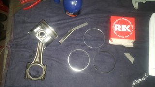

Feeler gauge, & rings

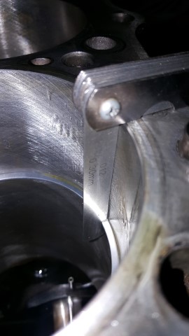

I then fitted the rings to each specific cylinder gap them correctly. The upper ring need a 0.3mm gap and lower is 0.4mm, I used the piston to insert the rings in order to make sure the ring is square in the bore.Last edited by Nick Gibson on Mon Oct 05, 2015 2:49 pm, edited 1 time in total.

I then proceeded to fit the pistons. The conrod and piston (piston has a dot) has a mark indicating the side facing the front of the engine. I made sure they all did. Note the rubber tubing I placed over the tread of the conrod studs in order not to mar the cylinder liner or crank shaft journals when installing.

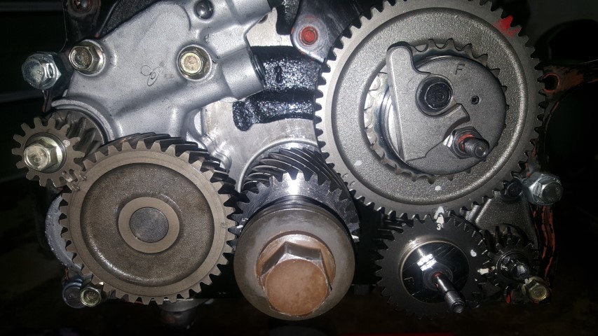

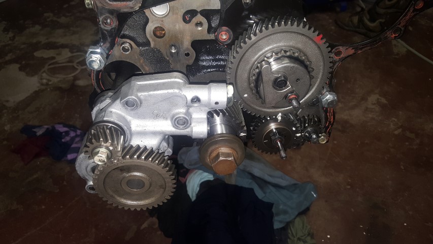

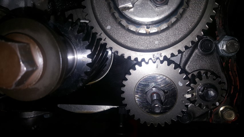

After all the piston were in and caps torqued up, I then did a mock-up of the timing gears, idler gear, oil pump, and upper balance shaft to make sure the timing worked out. Note the temporary bolts still holding the timing plate on.

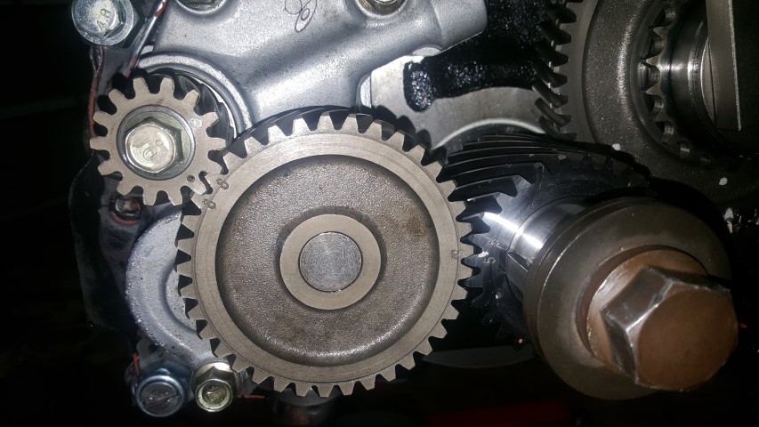

Once all the gears, idler gears, bushes were lubricated I installed them and double checked the torque values. I then installed the two timing chain guides - still in very good condition. The timing chain followed with the single black link on the timing mark on the lower sprocket - I unfortunately forgot to take a picture of this. I then pulled the chain up as tightly as possible and cable tied them to the two guides at the top for when I fit the cam shafts I do no lose my timing.

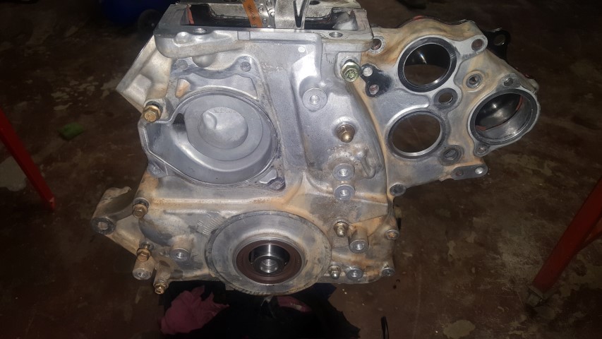

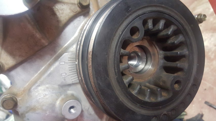

I then fit the timing gear cover, again with the correct amount of sealant applied. I also fitted a new front crank seal, again MUCH easier doing it with the timing cover and engine out of the car. Once the cover was fitted I had to fit the front main pulley. The spec says 323Nm on the bolt... Unfortunately my (borrowed) torque wrench only goes to 200Nm, so I did a quick sum for mow much weight I need to put on a 300mm power bar to get the same torque.
323 Nm = 32.93kg at 1000mm
Therefore = it is 109.76kg at the 300mm center of Gedore power bar handle.
(The power bar is 3.333 times shorter than 1000mm, thus you need 3.333 times the mass to do the same work on the shoter power bar)
I weigh 108kg.
Problem solved, i locked the rear crank output with some bolts and a crow bar and simply put all my weight on the power bar a couple of times.

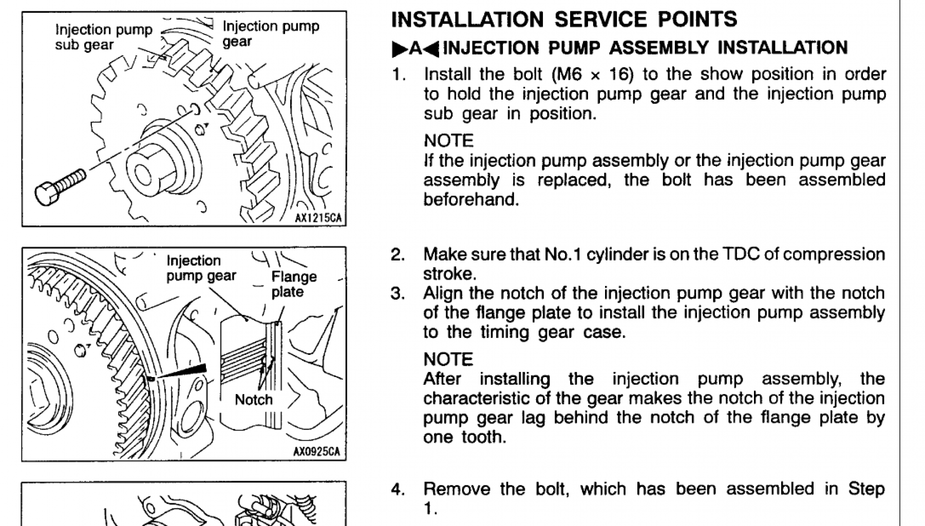

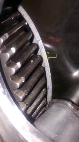

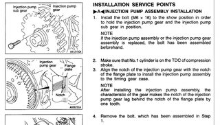

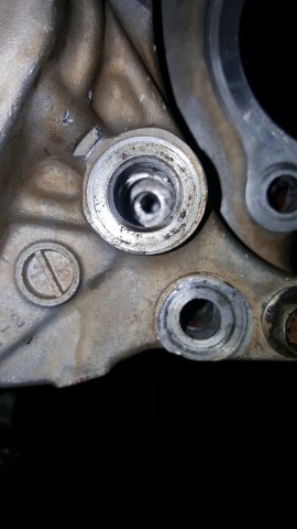

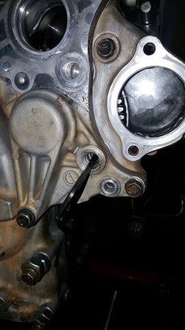

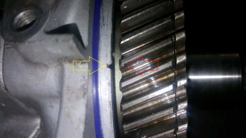

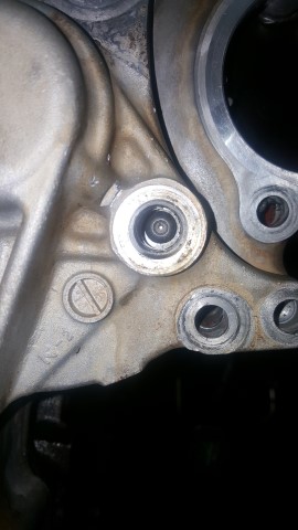

After fitting the timing chain, gears & case I had to fit the injection pump again. The timing setup & marks of the pump is CRITICAL to say the least so I could not afford to do it incorrectly. The manual states you need to be at 0 degrees TDC on the crank pulley -done when installing the timing gears. You then need to align a tiny notch on one of the teeth (Red Arrow) on the pump gear with a timing mark on the pump case (Yellow Arrow). The pump gear also has a thinner spring-loaded 'scissor' gear on the front of the main gear it to take up any back-lash between itself and the cam-chain sprocket idler gear. This part needs to be locked with a M5x16mm bolt to the main gear to prevent the spring from unloading.
See the manual on locking the pump sub-gear(scissor gear): I fitted a stainless steel M5x16mm allan head bolt for ease of access though the small access hole provided in the aluminium timing case, there is not enough clearance space for a conventional bolt with a mini-socket set. Once the bolt is removed, the hole is blocked off by a plug similar to a sump plug with a copper washer.
After doubly making sure my crank timing (O degrees) and pump timing was set 100%, I proceeded to fit the pump. Once installed you can see though the open port that the power steering pump is fitted into if you got it right. If you did the pump gear timing mark would lag exactly one tooth behind the case mark due to the helical cut gear turning as you push the pump into position. Once pump was fitted and timing checked (again) I had to remove to M5x16 bolt from the hole provided in the aluminium timing case.
