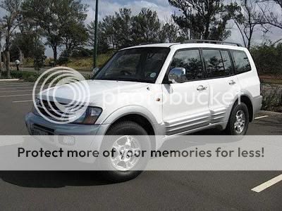

I need advice, I am planning to drive 2 hours to go see this pajero:
Its a 2003 model with 288K on the clock, the owner says he has only used it on long distance trips, he's had all major services done with agents and smaller services done by an independent mechanic but it is all logged and stamped in his service book. Is this mileage too high? I saw slightly older models with less mileage in a similar condition, should i rather consider those?

based on what I've seen you can find a car with much lower mileage - 150 - 200k range for a 2003 model.

ok, i'll give this one a miss then
