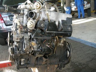

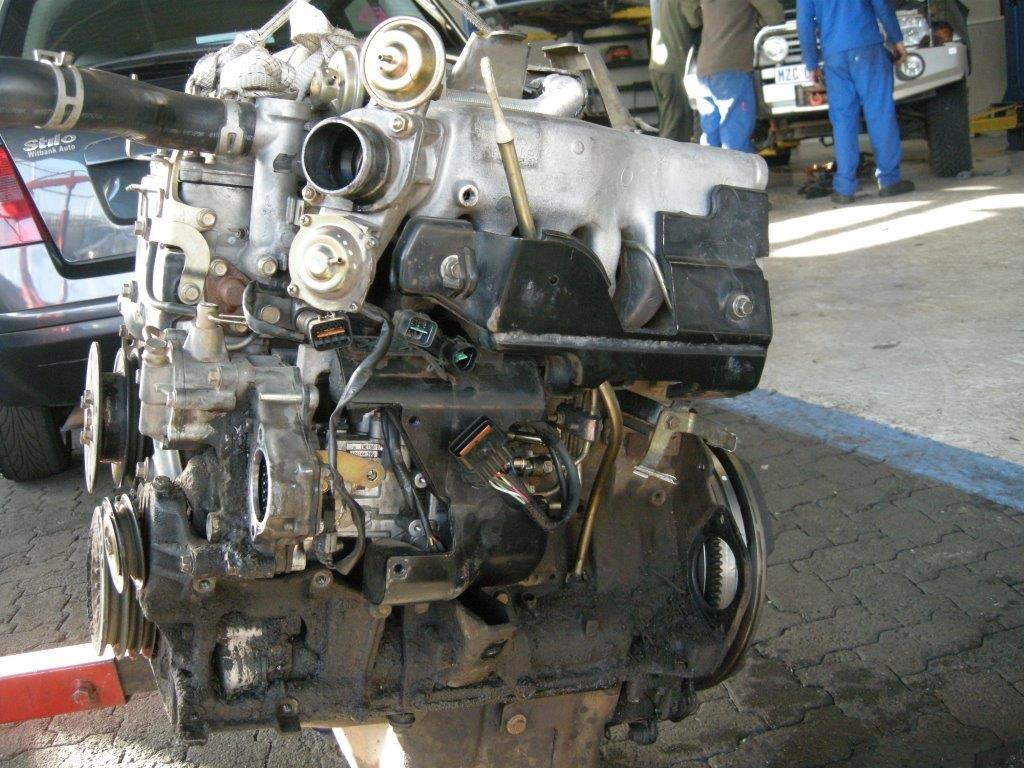

These are the photos so far that they sent on to me last week when they took out the engine.
They have indicated that the #1 piston has a crack/hole in it and the cylinders still look pretty decent and within spec, but will await 'official' report before they quote.
