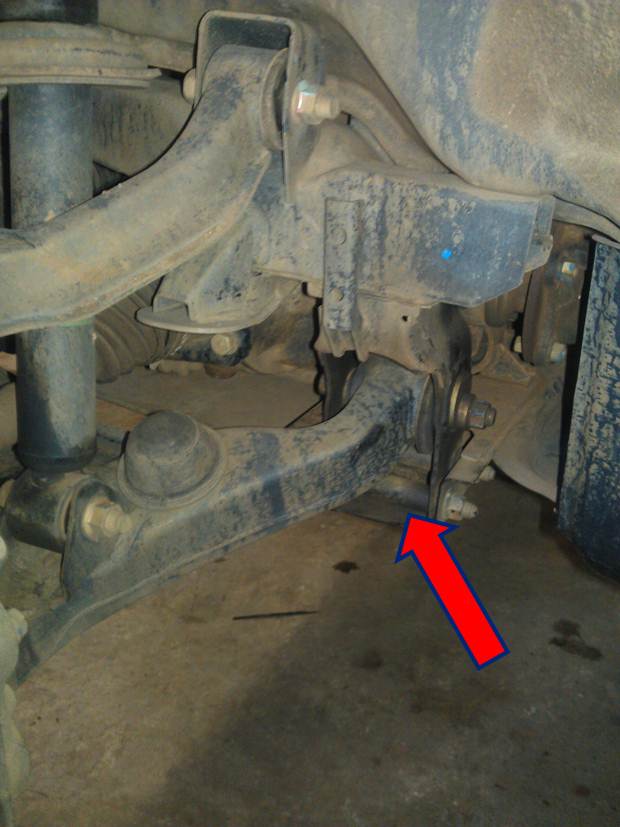

Went to Mikem to get my spacers fitted. The following came up:
Normally, the droop stop is caused by the shock extending to its max. Now, after fitting the spacer, it seems the control arm hits this bush/bolt thingy (on the cross member).
Looking at it, I can see that its never made contact with that in the past (what you see is just settled dust/mud)
Those of you who've had your spacers install - does the control arm now hit against this?
Also, this means that the shock must be forced in - which is possible to do. But how do you get the shock out?? Is it possible to do without breaking the bolt that holds the shock?

Hectic - that is not good
What does Uys have to say about this?
In contrast... with an OME kit, the shock does not move down - it remains in the standard location, so it will still limit the droop.
