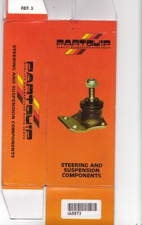

I have started to replace my idler arm and pitman arm as they where worn. I am having problems sourcing the correct pitman arm for the gen 1 pajero, I got one from Midas for the colt rodeo (part number IA5573) but it does not fit. Do you maybe have a part number for the pitman arm you have on your pajero?
Thanks.

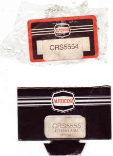

Attached find the image of the packaging of the Pitman Arm I fitted.
What year is your Gen1?
Take off the Pitman Arm and get them to find the correct one (I can only guess that yours has either earlier model or later model's equivalent)
Gen2 Pitman Arm (bottom) and Idler Arm (top):
Gen1 Pitman Arm:
Gen1 Pitman Arm:

Mine is a 1990 lwb 2.5tdi.
Thanks for the photos :)
I bought the same arm as the one you have posted (IA5573) and it would not fit/mesh with the splines which is weird. I ended up going to the stealers and got the Colt rodeo one and it fitted perfectly but it was hell of expensive :o almost 10 times more expensive than the pirate part.
