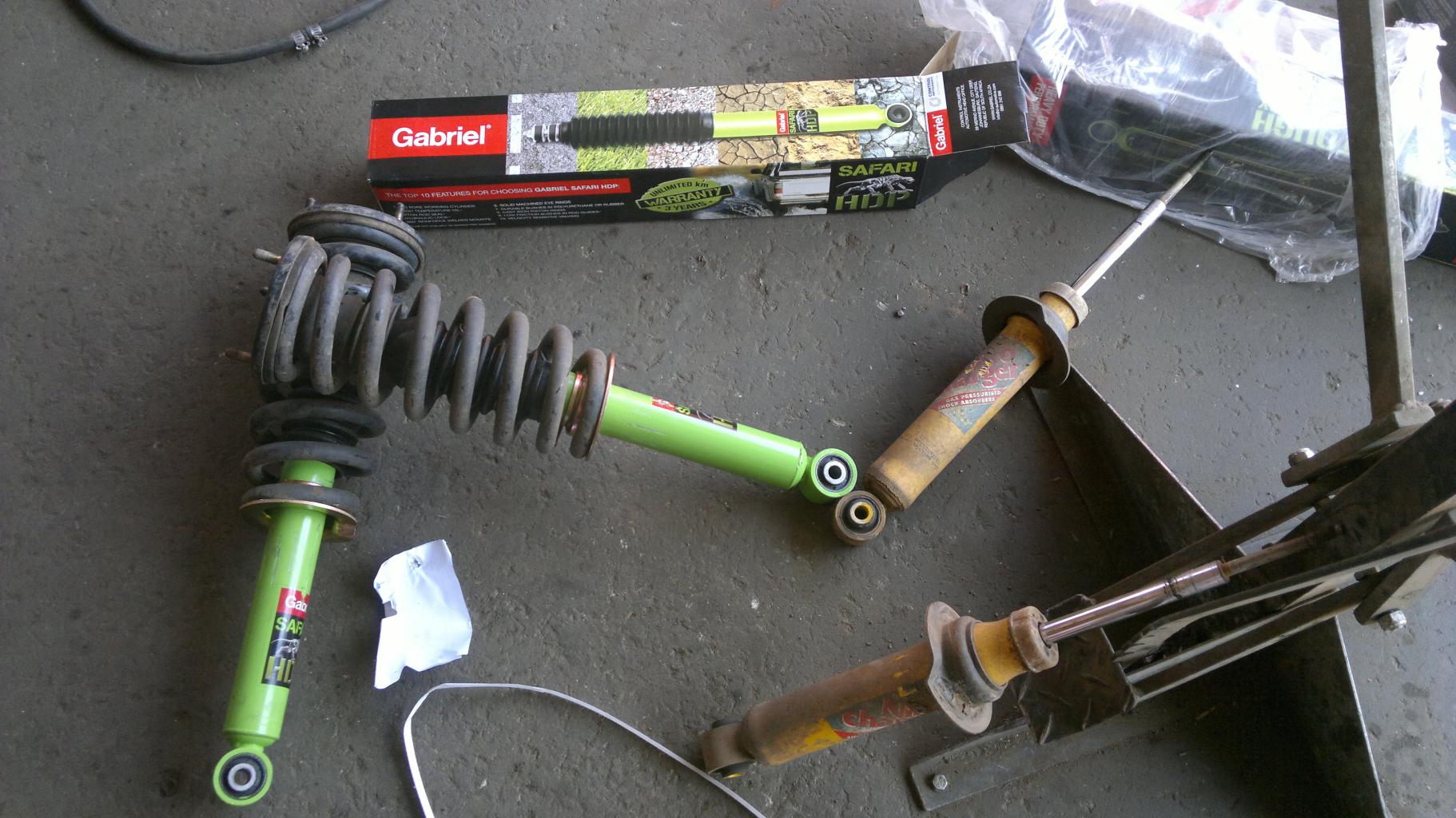

Thanks CATS, nice pics, very helpful indeed.
The circlip, what spaces are they apart and can that be used to gain the height increase up front instead of spacers as per a review I am busy with for gaining some ride height both front and back.

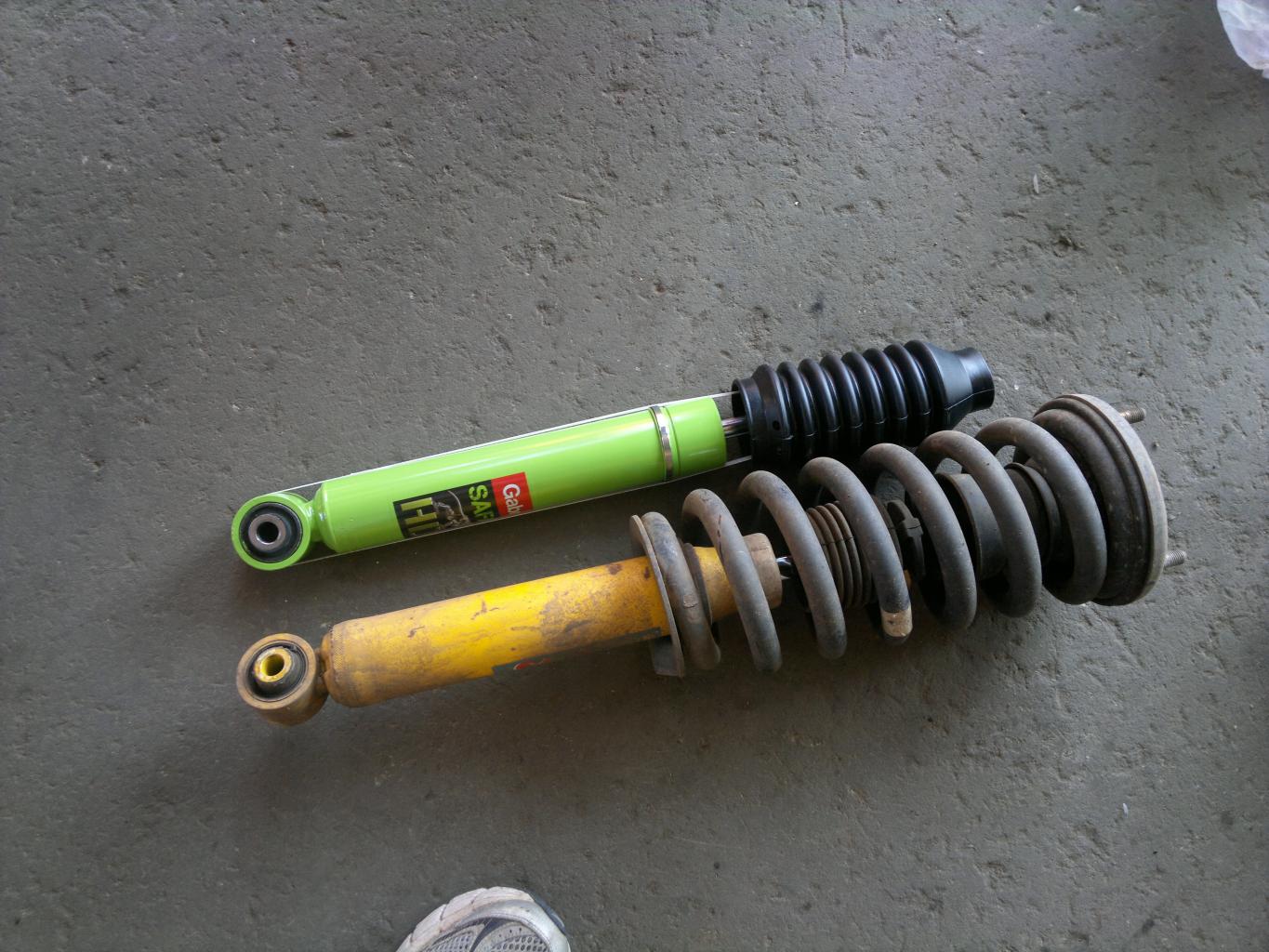

@CATS: Do you still have the Ironman coils in? Would be interesting to see if the shocks work with the slightly stiffer coils.
On a general note: Are the shocks for a specific car model tuned for that car's springs or is it a more one-size-fits-all type solution?

Yes the Ironman coils are still in. The shocks seem to be a more one size fits all type and not geared to a specific suspension setup unfortunately. This is one of the things that I like about the Old Man Emu setup which gives different options regarding normal, medium or heavy duty. IM and HDP make one for all.pierreandre wrote:@CATS: Do you still have the Ironman coils in? Would be interesting to see if the shocks work with the slightly stiffer coils.

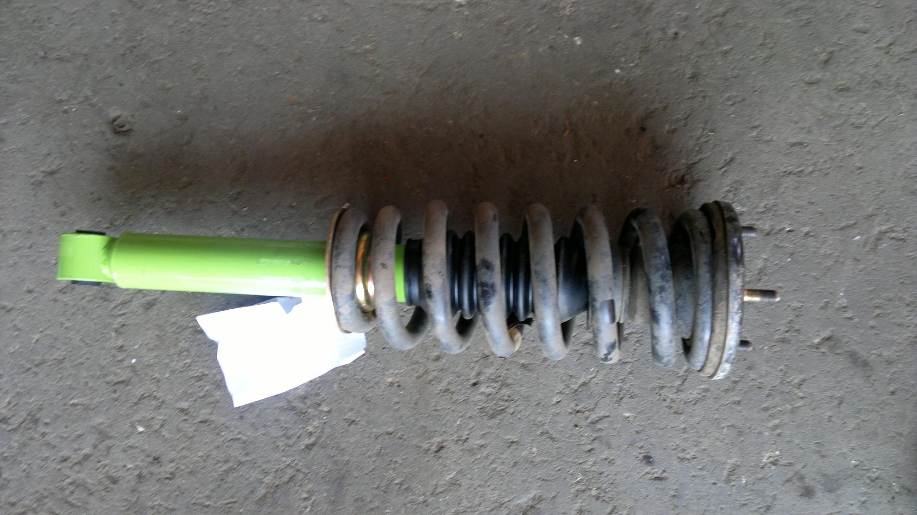

The circlip space is about 16mm apart and there are only two settings available. According to the leaflet that came with it the higher setting will give a lift from normal height. - See the one photo of the document(not so clear unfortunately)Davidvan wrote:Thanks CATS, nice pics, very helpful indeed.

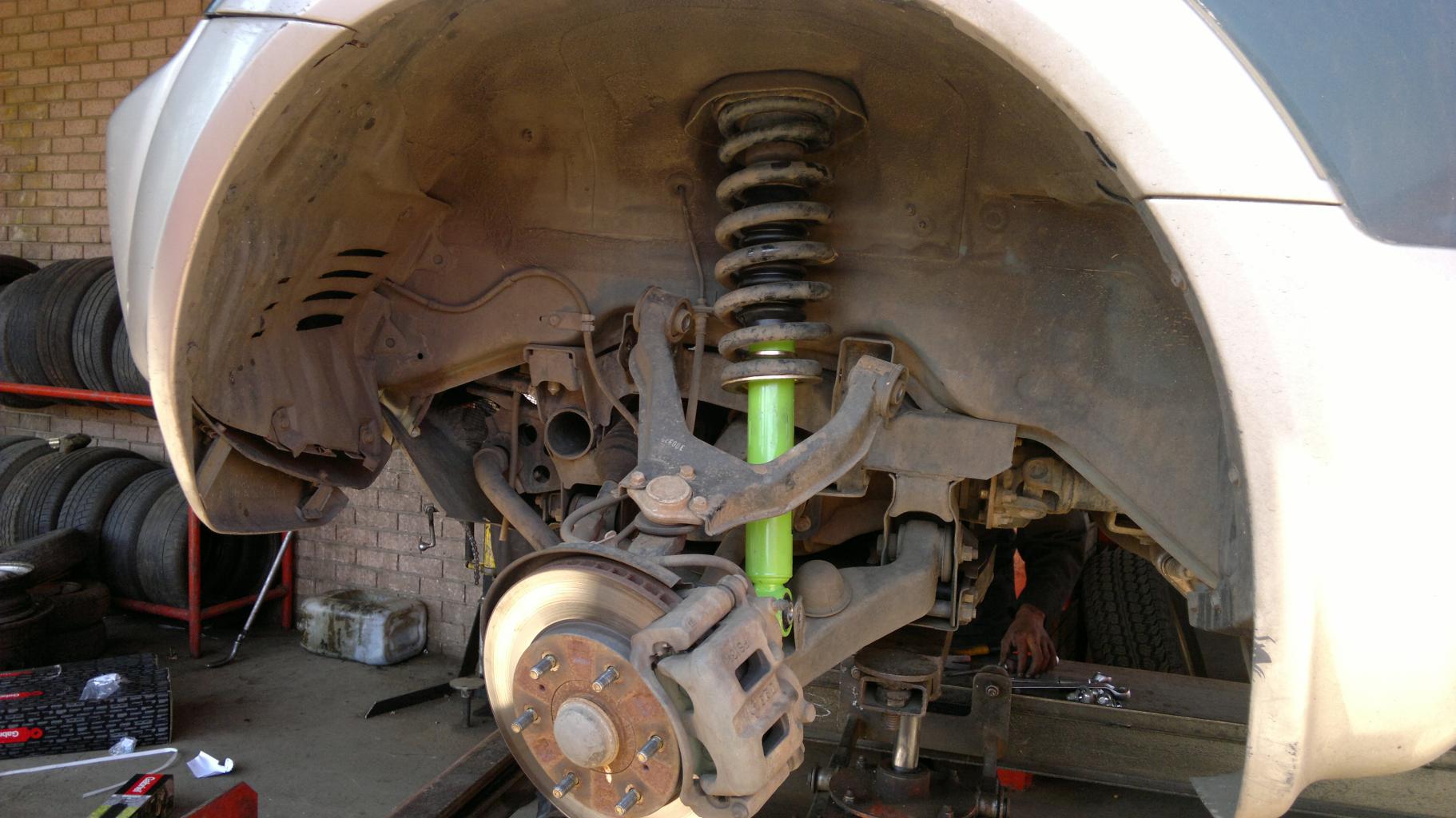

So I had the front ones fitted as well now and have been driving around for the last week over the normal traffic calming bumps and mini circles. So far I am impressed in the damping and rebound of the shocks and could notice a definate better ride from my old shocks, which has not done too much mileage when replaced.
It was decided to not put the front shocks on the higher setting and thus increasing ride height on my particular vehicle due to the fact that I already have Iron Man coils in which is slightly longer than the original coils thus already lifting the vehicle by about 3-4cm. The fitment center also said that the Iron Man coil was VERY hard to compress and that he was worried that if we fitted the shock on the upper setting that the coil would be too stiff and damage the shock. So ride height is still the same as before on my vehicle. Of course height is not determined by shocks in general, but in this case where this particular model has a setting on the front McPherson setup to push the coil up, it will actually give a slight increase in height. If the standard coils are used I would definately investigate this handy feature on the Gabriel HDP shocks.

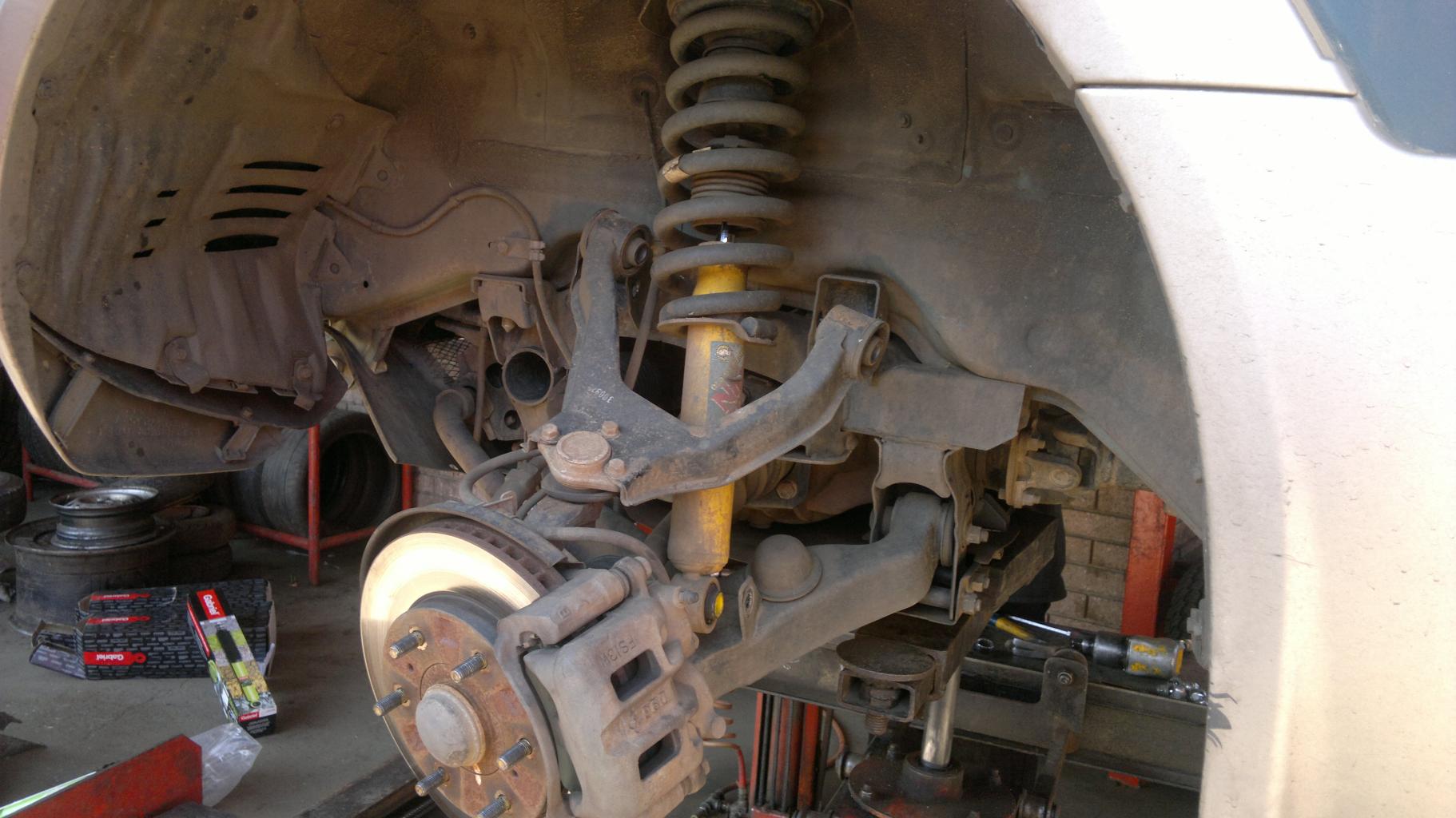

So Saturday came and off i went to the local wheel fitment center.
Had HDP Gabriels fitted on all 4 corners of the Pajero. I still had the old OME coils is and it fitted without out a problem and without loosing any lift. still 545mm from wheel arch to wheel center.
