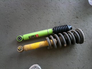

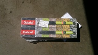

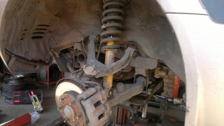

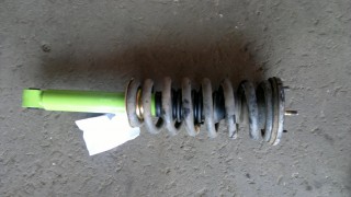

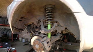

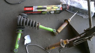

Like i said, i had new shocks fitted front and rear to the Pajero over the week end. The same shocks as CATS did.
Must admit, that the shocks that came out were shot. Could push the front shock in with my thumb and the rear ones were not putting up any resistance when you compress them.
The new shocks fits perfectly and it settled at a ride height of 545mm from wheel center to wheel arch on all 4 wheels.
Would say R4700 well spend as i took it on a 100km drive and SWAMBO took it to work this morning (120km there and 120km back) so will have to wait and hear what her verdict is on road holding.
I cant complain yet as from where i was with the old shocks to the new shocks already shows a 100% improvement.
now only time will tell.
New HDP shocks
New HDP shocks
OME shocks being taken out
Old Front OME vs. New HDP Gabriel
Front HDP Gabriel fitted with OME coil
DHP Garbiels fitted with OME coils vs old front shocks
New HPD shocks going infront
