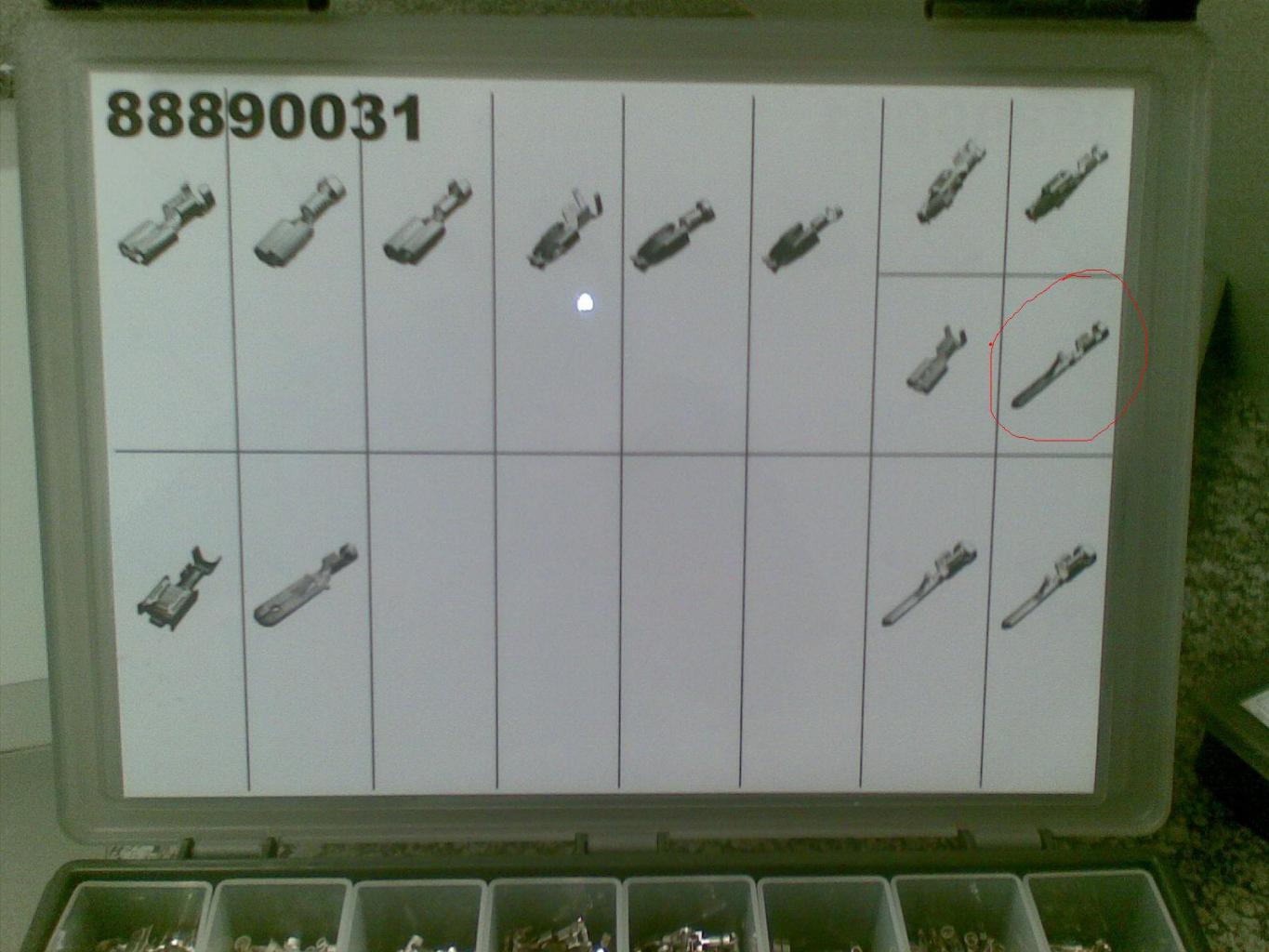

Hi wilddog
you say : "I was using globes before this mod, so the wiring was already there. You can buy the terminals for the existing connector at Volvo trucks countrywide."
Any change you can provide that part number from the Volvo Trucks? I woul dlike to see if I can get them.
What would the wiring look like when I want to connect all up?
Hi Jaco,
The advice I give is for Gen 3 as I do not know enough about the other Paj models. I'm sure there would be someone else that can advise on other models if needed.
The wiring for the taillights is already provided on the Gen 3. When you remove the taillights you will find the wiring and plug. The wiring that is being used is for the reverse lights and fog light, but the stop and taillight wiring terminates at the plug (There is no terminal or wiring coming out of the plug) because the stop and tail part is not used on the SA models.
So you need the terminals to do a nice job and to ensure you can remove the taillight if you need to without having to cut wires. The terminals come in a case. The case number is 88890031 the picture shows the exact position of the terminal in the case.
