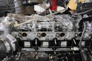

Head ports cleaned up and injector pipe seals removed (decided to replace because they had been weeping oil)

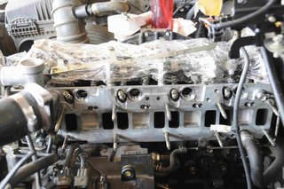

New injector pipe seals and inlet manifold gasket in place

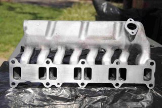

So this is what was hidden under all the gunk at the EGR inlet port of the manifold.

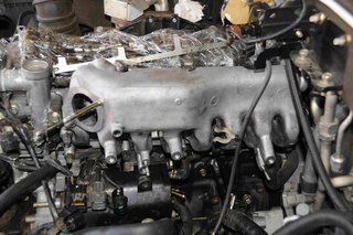

Inlet manifold reinstalled.

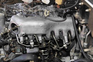

Injector pipes reinstalled (Oh &^%%&&* forgot to tighten #2 pipe at the pump and ended up doing this twice. Of course #2 pipe has to be fitted before any of the others ...)

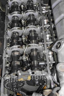

All ready for the tappet cover. See how nice and clean Delo 400 keeps the top end.

It wasn't too difficult to clean the throttle and EGR valve but the manifold is another story - and don't do it in the kitchen sink because you may be sleeping with your beloved (pajero) in the garage thereafter. In the end I contracted the cleaning of the manifold out to Alpine Turbo and they got it cleaner than I could.
