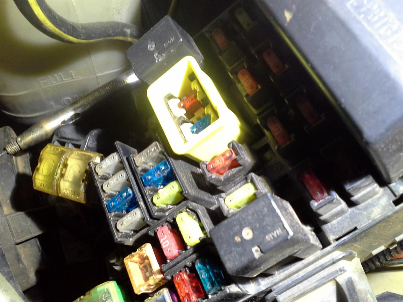

Re: Radio/sunroof/interior lamps/LCD screen not working
Engine compartment fuse box. Yelow discoonector box for accesories.two fuses, 20A permanent power. 10A power when ign on.
There is power on both.
There must be a unit/relay computer box that gets power from the fuses and feeds all the accesories.
Any ideas?
