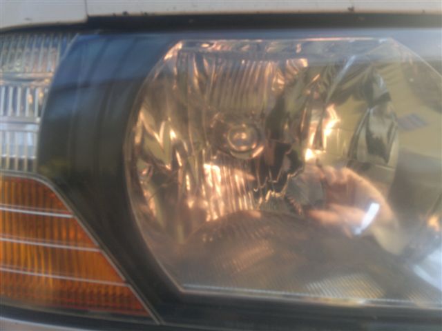

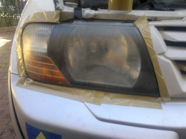

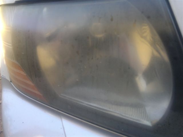

Yesterday I changed the Beast’s lights from this
To this!

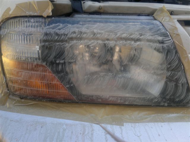

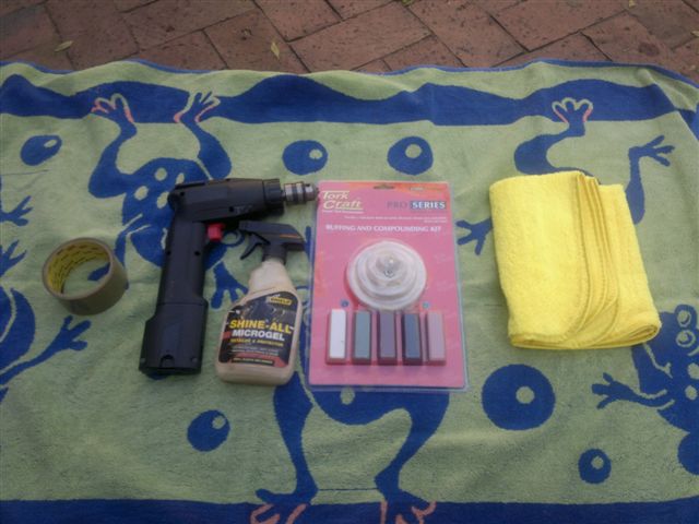

After many years of hard work, sunshine, dirt roads and being caught in a sandstorm in Namibia, the Beasts headlights had started to look a bit dull. The plastic had yellowed and the surface was pitted and faded. Could not source the plastic cover on its own, and new headlight units are in excess of R 2 000 each. My mechanic recommended brake fluid and toothpaste, but when I asked him what flavour toothpaste he got all huffy and refused to elaborate. Go figure. Anyway, some research showed that you can get off the shelf restoration kits, but the one I found at the spares shop was R 570.00 Luckily I found a buffing and compounding kit for R 150 at Builders.
Step 1, mask the headlight. If you open the bonnet, you don’t have to mask the bonnet. (Lesson 1) Step 2, give it a proper was, getting rid of all the oils and tar. I used pine gel.
Step 3, polish using increasingly finer compounds. I used the cordless drill, as I was worried about melting the plastic if using too high a speed. Wet all the time.
Step 4, wash again and seal once dry. I sealed mine with wax, but next time I will do a lacquer spray coat.
There was a fine layer of flaky plastic on the top surface. On the second headlight I scrubbed this off with a spongy pot scourer, but this left fine grooves. I was in too much of a hurry to get these out properly, and the battery on the cordless was getting decidedly weak. Don’t try and rush the job (Lesson 2).
So I now have much improved light at night, and the Beast looks more like a beauty…. For 150 bucks and a couple of hours elbow grease.

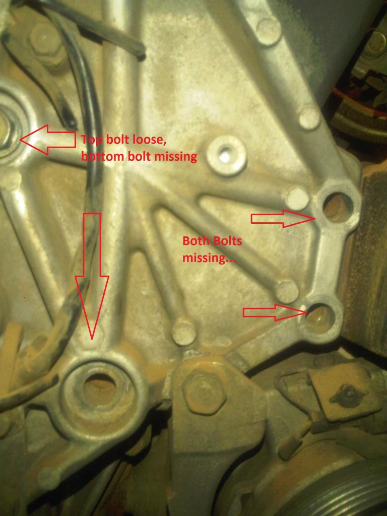

Seeing as I had some time of my hands Sunday I decided to sort out an irritating "klunk" noise on the back of my Pajero. Turns out it was the upper shock/damper mounting that had some play on it causing the sound to travel through the chassis.
I could not tighten the top nut anymore to take up the play on the insulating upper and lower rubbers, so I removed the shock and found a small tubular spacer (31mm long) on the upper shock thread that kept the two big washers a certain distance apart which was stopping me tightening up any further. I simply ground the spacer shorter (26mm) to allow me to tighten up to top shock nut to take up the play in the rubbers which was causing the "klunk".

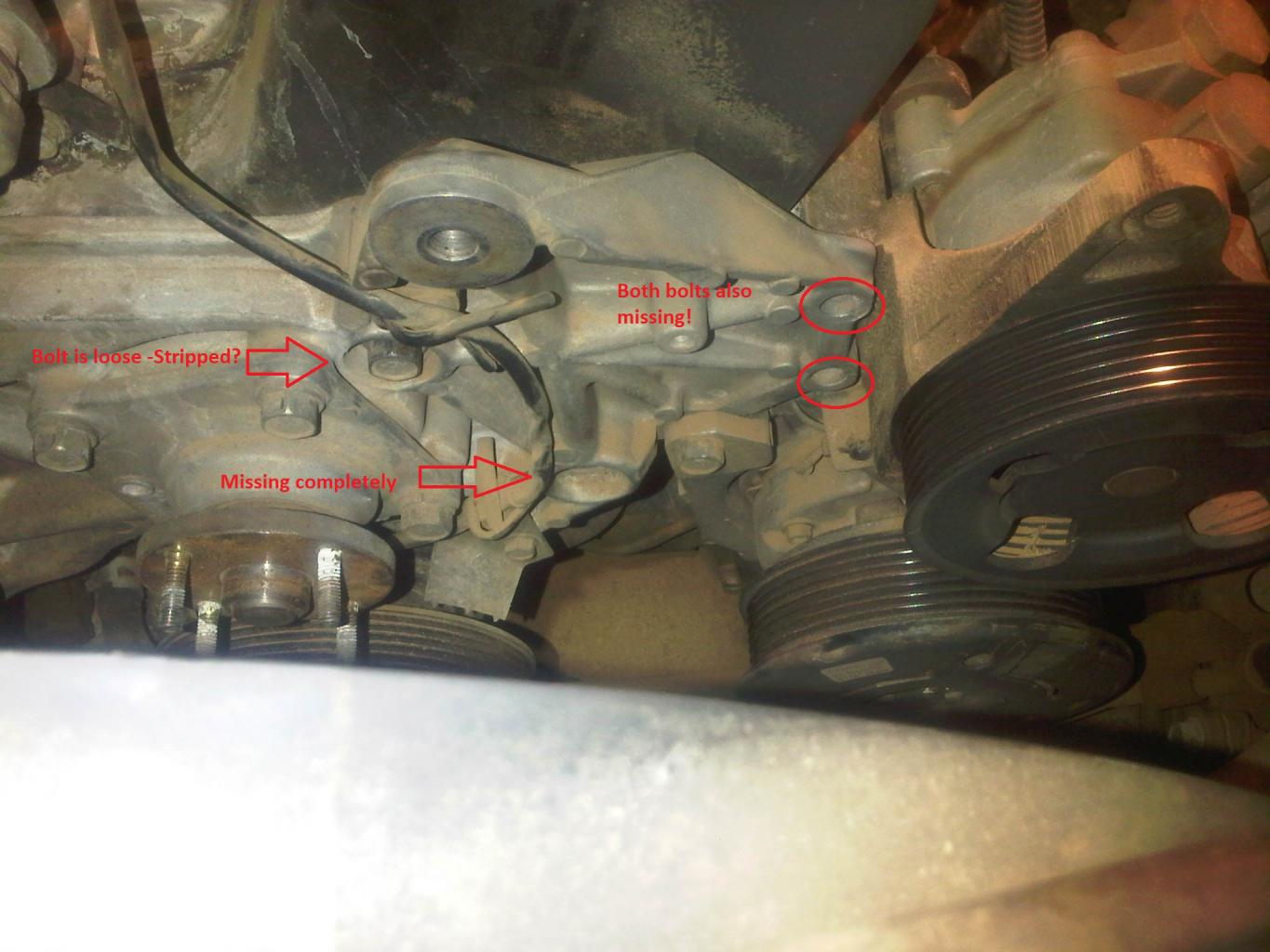

I also have a "whine" noise emanating from one of my idler pulleys on the accessory belt. I removed the belt to have a better look and removed both plastic and steel idler pulleys to see which one was the culprit. Once they were both off I saw that the cast aluminium accessory holder that is mounted on the front of the engine had a loose bolt. I removed the viscous fan (what a PITA!!!), to have a better look and found one bolt stripped and 3 missing; see pics. It also seems as if someone had cut a new thread onto the loose bolt (coarse thread, not fine) but this has also since stripped as I cannot torque it at all
I am worried now as I only have 3 bolts holding the accessory holder on now, I will phone mitsu to see if they have the bolts in stock. Any ideas on how to tap a new thread if they all are stripped, the two bolts are long 110mm, other two shorter at 60-75mm?

What about using a thread-forming liquid? Permatex and Loctite, amongst others, make this stuff. If you search those product names + "thread forming liquid" on Google / YouTube you will find available products and How To videos.Nick Gibson wrote:Any ideas on how to tap a new thread if they all are stripped, the two bolts are long 110mm, other two shorter at 60-75mm?
Good luck with finding / achieving a suitable fix.
