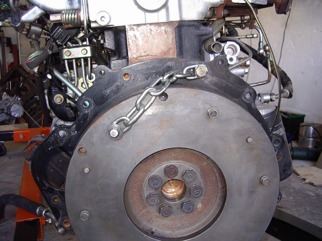

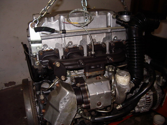

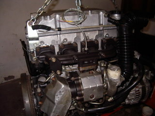

I don't have an opinion on the DMF vs solid flywheel, but I can offer my experience ("A man with an experience is not subject to the argument").
My Gen1 has a hybrid drive train, made up of standard Mitsubishi components (the beauty of working with a Mitsubishi!):
  • 3.2 Di-D engine
  • Solid flywheel ex a 2.8 Pajero/Colt
  • Clutch assembly ex 2.8 Pajero/Colt
  • 5spd manual transmission ex a Gen2 Pajero
  • SuperSelect Transfer case ex Gen2 Pajero
  • diffs ex the original Gen1 2.5TD
Everything was bolted together, without ANY modification to any part/component.
The solid flywheel has served me well (it's now 5yrs!)
It is smooth and 'soft'.
I have used the Pajero from long trips to tracks and 4x4 trails, and have never had one problem.
I attach photographs of the flywheel etc.
Here I have an opinion: Me finks that flywheel is 'thick' enough!
