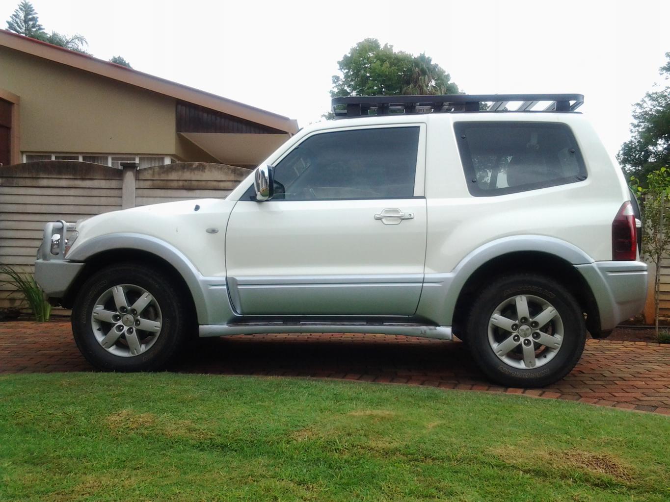

Ground clearance front bashplate was 180mm
Ground clearance at back 260 mm

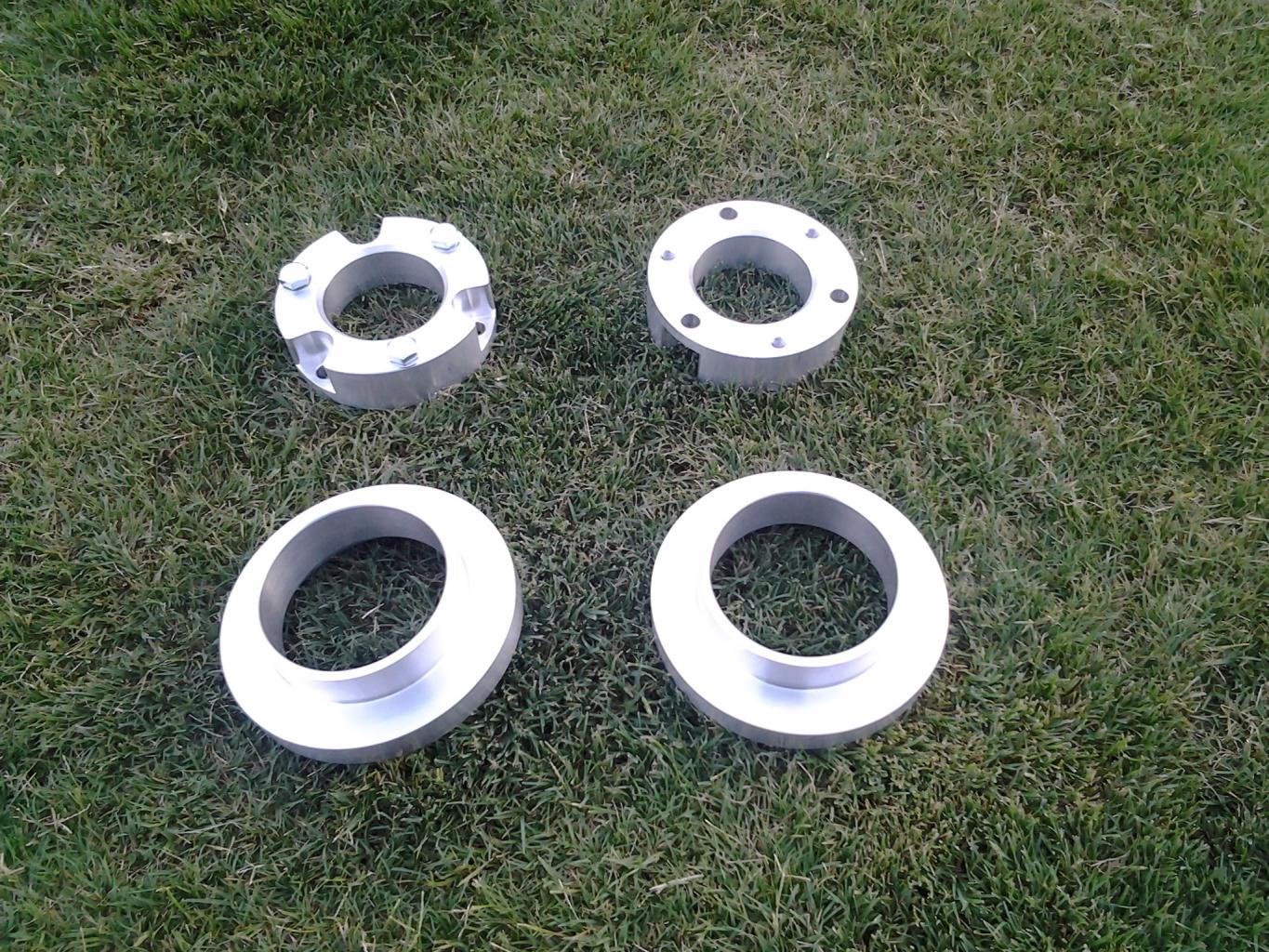

Bought these from Stofpad
35mm front and 25mm at the back

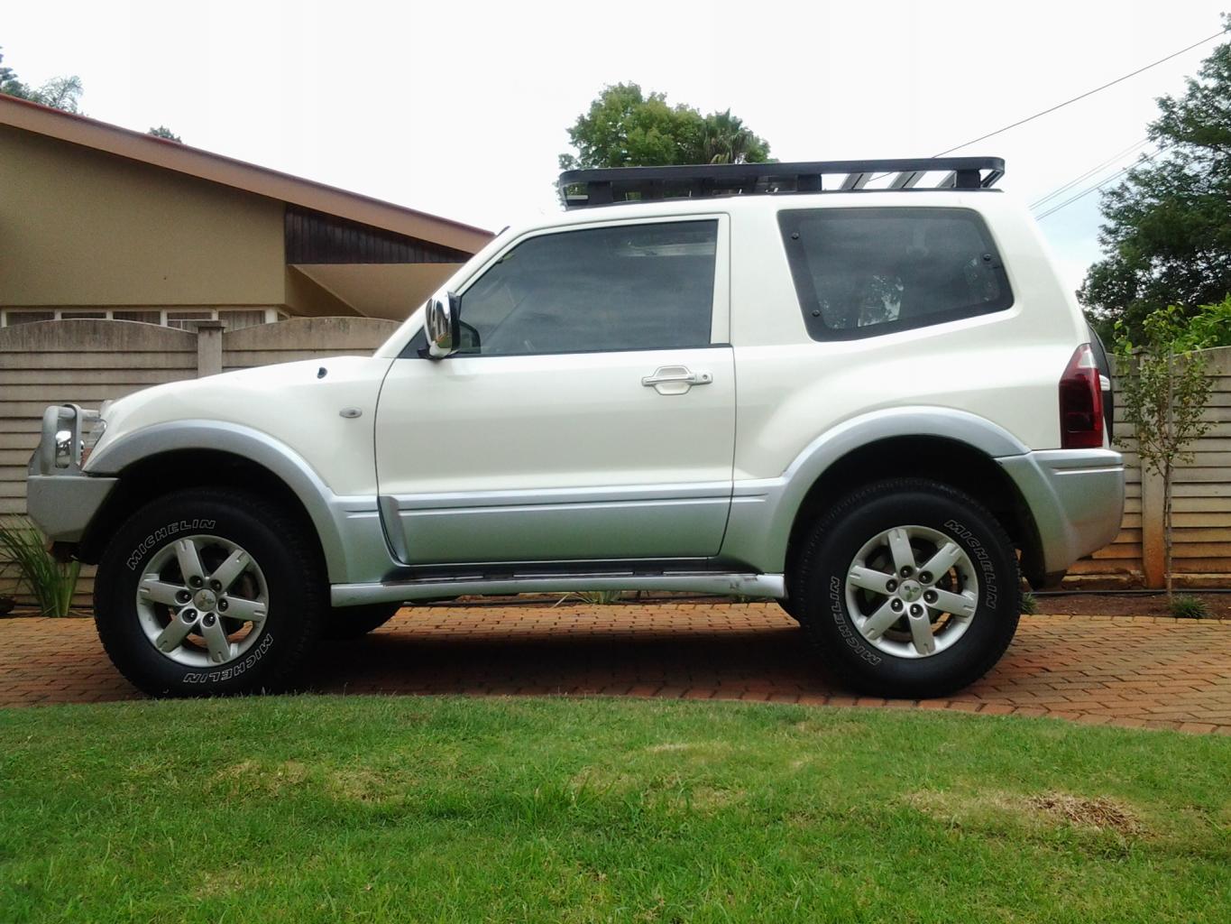

Bought some Mitchelin 265 70 17 tires
This is how it ended up
Ground clearance front 290 mm
Groundclearance back 320 mm
