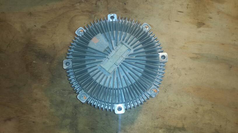

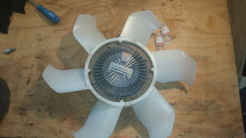

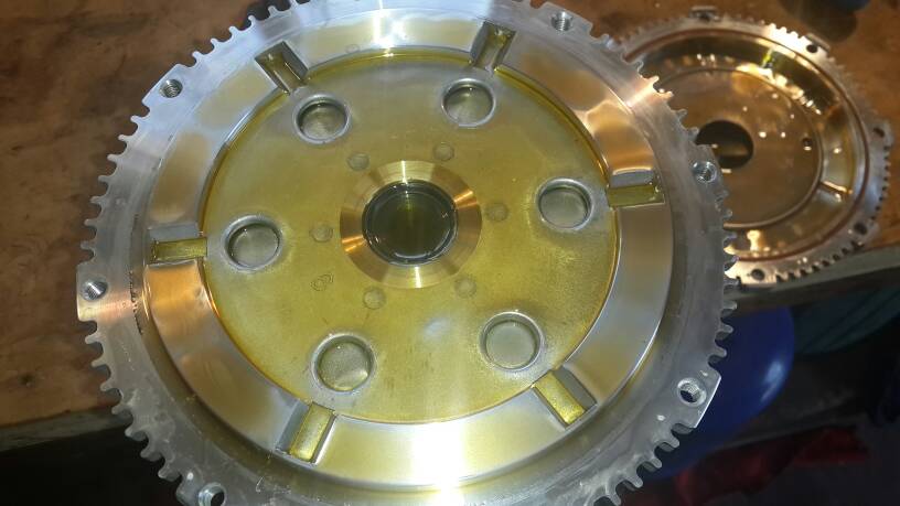

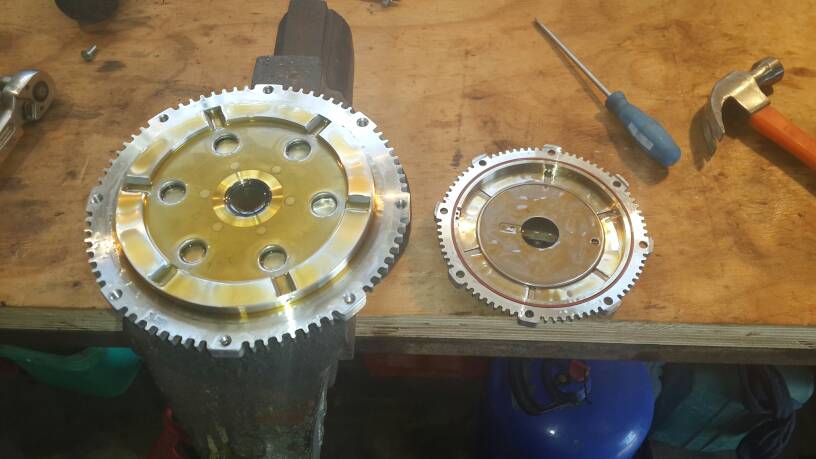

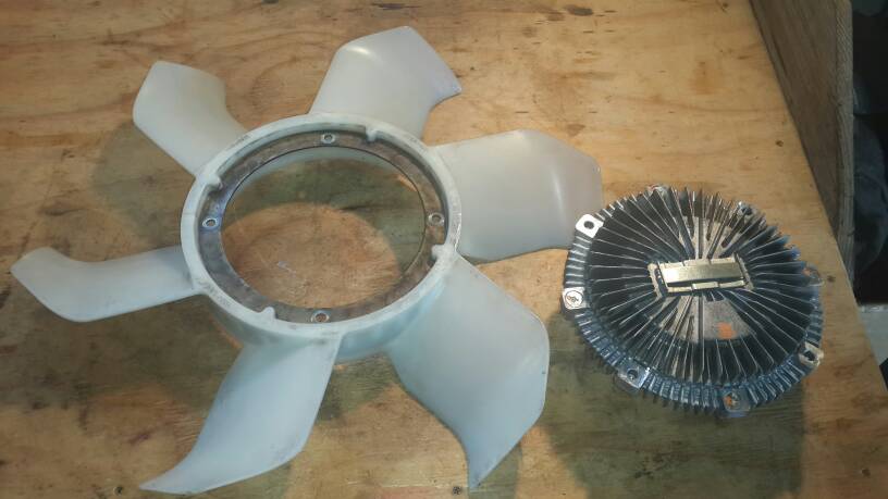

I had some time to work on the viscous coupling on the fan, i have been suspecting that it had been under performing for a while now as my over heating issues have been getting progressively worse after fitting my aftermarket burnco bumper a year ago.
I searched for the viscous fluid everywhere, and only managed to find some 10000cst silicone oil from toyota. Midas, autozone and other spares shops have no idea what I was talking about. I bought two tubes of 18ml for R158.00 each.
I removed the fan and viscous coupling from the pulley and gave them both a good clean with prepsol.
I then carefully opened the hub and emptied the two tubes inside. There was very little silicone inside once opened.
I put it all back together and and back in the Pajero.
It seems alot stiffer when turned by hand now but will only be able to test properly once my brakes are working again.
If this does not resolve the overheating problem I will have to have my radiator rodded by silverton.
