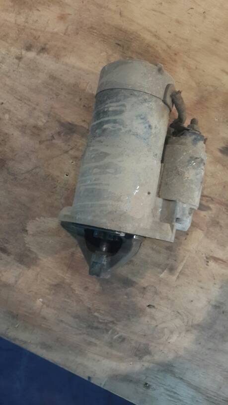

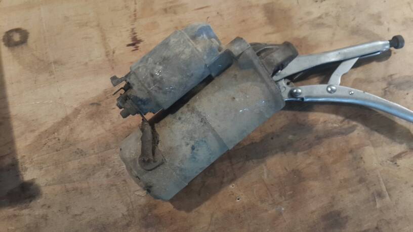

Had a chance this afternoon to pull the Pajero's starter motor due to an intermittent non start fault, just a click.
Thought I could get the the solenoid contacts cleaned up, but found it to be a sealed unit, will have to order a new one. Here are some before and after pictures of it being cleaned.
Starter pulled, very muddy and grimy.

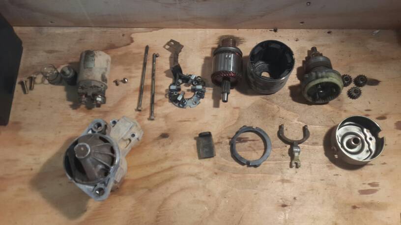

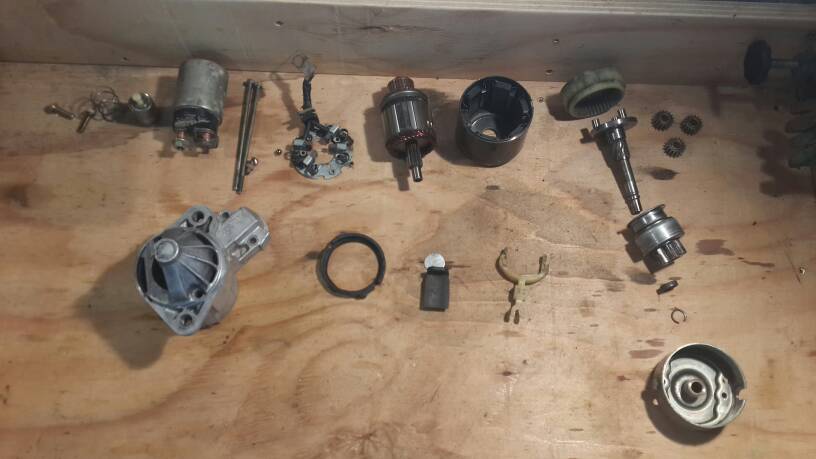

All taken apart and ready to be cleaned, inside the case was quite oily and the reduction planetary gears needed a clean and re-grease. The bendix shaft was all gunked up and wasn't moving freely when moved by hand, I can only imagine how the solenoid struggled.

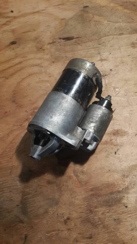

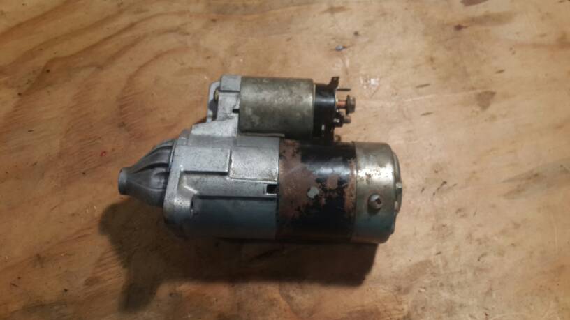

All cleaned up with prepsol, only the armature and brushes done with Spanjaard 'elektrokleen'. I also tried to spray some into the solenoid to try and clean the contacts as it is sealed, but no luck.
Word of warning, the shaft has an overrun clutch on it on it should not be immersed in detergent (I found out too late, should have read the FSM first....), as it is prepacked with lubricant in the factory. I hope mine lasts as I had it in a tub of prepsol for 5 mins, but so far so good.
All done and ready to reinstall.
