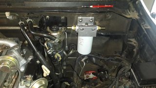

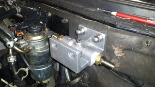

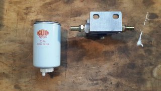

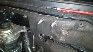

One of the first things I wanted to do was to add another finer diesel filter plus water trap after the OEM filter for some peace of mind an extra water trap. I phoned around to various filter suppliers (Donaldson, UDF, Racor, etc), and after speaking to Tim at the Durban based GUD filters technical department, I eventually settled on a GUD CF16 filter head and a GUD Z314 diesel filter which does 3-5 micron at 85% or 8 micron absolute filtration. The Z314 filter is designed for common rail large capacity truck motors, so the flow rate and filtration is more than good enough for my older generation diesel motor.
Filter plus head.
Filter & Filterhead
Filter & Filterhead
I bought a meter of 12mm fuel line and 2 barb hose adaptors to suit the filter head and some jubilee hose clamps.

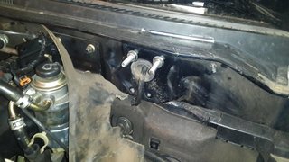

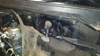

I found a place on the firewall where I could remove a rubber grommet to access the back of the firewall steel sheet metal. I then drilled 2 holes to install bolts, they are then fitted though the grommet hole to act as studs to mount the filter too. I spaced the filter with two extra nuts on either stud to allow for the firewall insulation to be reinstalled.
Grommet & Firewall
Grommet & Firewall
Grommet & Firewall 2
Grommet & Firewall 3
Filter Head mounted
Filter Head mounted

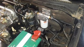

I then took the outlet pipe from the OEM filter off the injector pump and fitted it to the inlet of the new filter, and then took the outlet of the new filter to the injection pump inlet again.
Filter fitted
Filter fitted
All plumbed in
All plumbed in
All in all cost me about R550 all in for the kit, it not a UDF filter but it works well enough for me at a 10th of the price.
