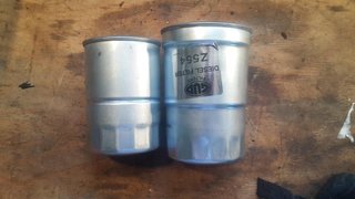

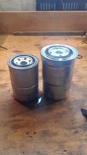

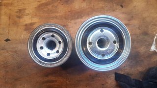

I had a bit of time to work on the Pajero on sunday.

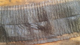

I replaced the diesel fuel filter to try and sort out a hard hot starting issue. I was actually surprised at the size difference between the two, the GUD (made in ISRAEL nogal) being much bigger. Will see if it helps with the issue this week, the element seemed to be quite dirty.

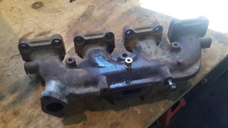

I also replaced the exhaust manifold with a well seasoned second-hand unit due to a crack in it at cylinder no. 2. I also installed a EGT probe at the same time. The manifold replacement is quite a job... The whole EGR system has to be removed, you then have to remove the downpipe of the exhaust and work your up due to the way the turbo is bolted onto the manifold. The whole turbo/manifold/dump-pipe assembly is then removed.
It took me about 3 hours to get the rusty 9 year old nuts off the exhaust and manifold (lots of penetrating oil helps), and all the coolant and oil feeds to the turbo are removed and tucked away. I then had the manifold and turbo unit out to swap the manifolds around.
"New" manifold with 1/8" NPT thread tapped for EGT.
Had had already drilled and tapped a 1/8" NPT thread into the 'newer' manifold for the brass gland to accept the EGT probe - from MadMan. I drilled it in a position to measure the temperature where all the exhaust gasses combine before entering the turbo.
Another 2 hours later it was all bolted together, with copaslip on all the stud threads for easier removal in the future. I will connect the probe to the MadMan later this week and start monitoring the temps.
