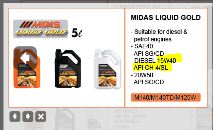

Side note: I am using the Midas liquid Gold 15w40 for break in, which is a API CH-4 spec, not too bad I thought. It however loses viscosity when the engine is warm as my cold idle and warm idle oil pressures are different by about 1.5bar...Will change to DELO400 ASAP when engine is run in at 1000km interval..
