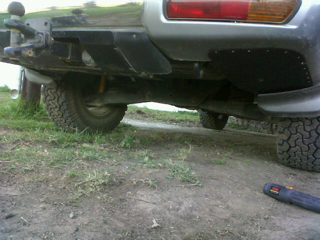

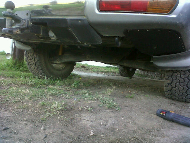

So I decided to tackle the right rear bumper's inherent weakness and danger to be ripped off seeing as I'm going on a nice outing soon.
https://www.4x4community.co.za/forum/sh ... hp?t=79406
After - still want to put a bolt (or 2) and nut by the wheel's fender
