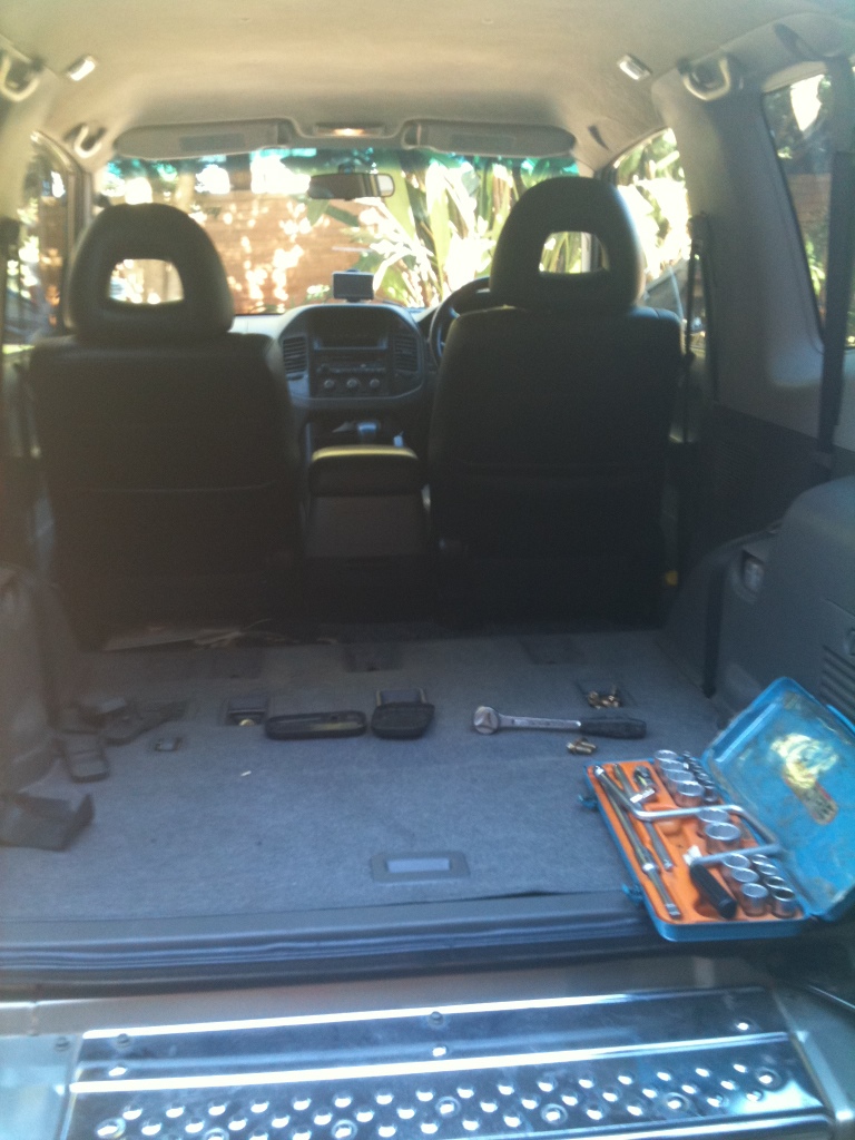

I want to remove my second row seats for my Botswana trip to increase my limited loading capacity. I havent had time to realy look how and if this is possible.
Any pointers or tips how to go about?

I had a quick look this morning, looks simple to remove these seats.
Two bolts on the seats self and another on the shock.
Any comments or advice?

Yip, very easy. The seats are heavier than you would expect. Their removal also leaves holes in the floor. You can screw the bolts back into their holes, but there are "locating studs" that also go right through the floor. Presstick solved that problem for me.
PS: the shock is fully mounted/attached to the seat, so does not have it's own bolts.

I removed the arm rests as well.
Who said a Shorty doesn't have boot space?
I like the extra space so much, that I still haven't returned the seats.

No comment on the potential pitfalls, so I suppose I can just lever the plastic covers off and then start undoing bolts (if they are at the base of the seats, of course) and continue until the seats are loose
Do you have advice on what to do with the exposed bolt holes after removal
I would hate for dirt road dust to come in there
Curly

Yip, just prise the plastic covers off. Replace the bolts back into their original holes. The other "locating holes" will want some covering-up. I saw my buddy had cut a little plastic cover and bolted it back in place. I just push prestic into the holes.
