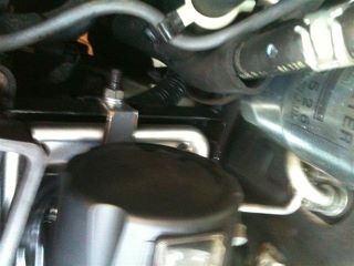

Just before my Botswana trip I mentioned that I had build my air compressor into the space for the spare battery in the engine compartment. Someone asked for photos, so here they are...
The photos below is for a general idea where in the engine compartment the compressor was placed.
The standard compressor (exactly the same as the ones sold at 4x4 shops was bought at Midas as a Xmas present to myself for 40% less than the 4x4 shops sell them for) was put into a frame.
The frame is attached to the body with three bolts so that it can easily be removed when I can afford a dual battery system.
The compressor shifts into the frame and is held in place on the one side by a bracket which the compressor's standard feet plate fits into and on the other side by one makeshift bolt, also for easy removal. I was sceptical about the strenght of the makeshift bolt holding the compressor in place but during my Bostwana trip I used the compressor several times without any hasstle or dissapointment.
Below is some photos of the brackets.
Bracket 2
Bracket 2
Any questions welcome.
Please dont tell me my engine is dirty, I know... ;)

I have gone through a couple of cheapies and the last time decided to get an ARB unit which has performed faultlesly now for a couple of years. It is not the fastest unit out there, but I would rather prefer reliability than speed.
This is where I mounted my unit. It is a tight fit but works well with the ARB unit. The new ARB units are even smaller so should be easy to mount in the same spot. This is in front of the driver side just behind the airfilter and just before the brake fluid unit. Made a frame of aluminium with a few bends and use existing bolts to fasten inside engine bay. The pipe stays in there as well. If I recall correctly I had to move the small black fuse/solenoid box situated there slightly by bending the mounting plate, but can't recall 100%
