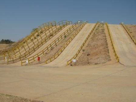

Attached pic show all the inclines available. 45°, 35°, 27° and 22° (with a chicken run)

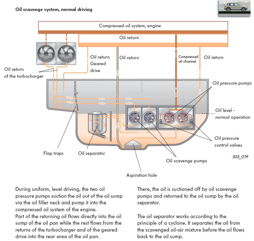

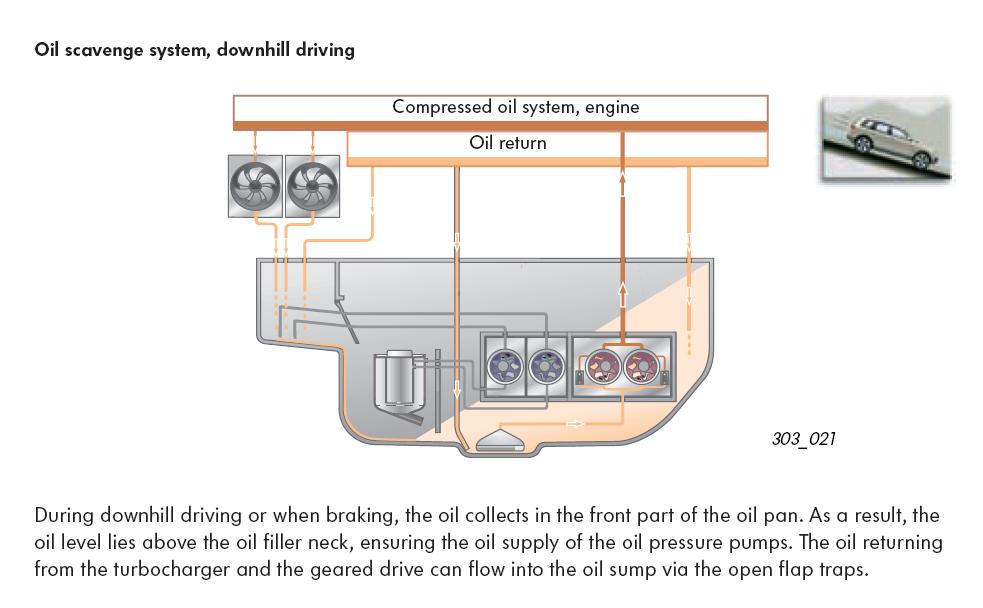

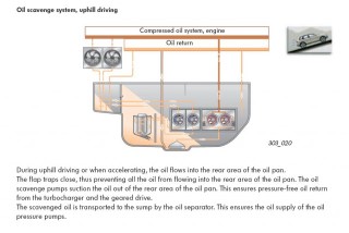

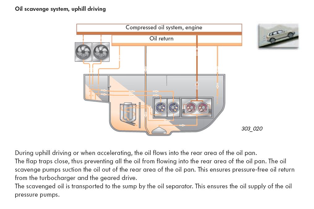

Interesting point.4ePikanini wrote:My biggest fear is oil starvation in the pajero.
(you will enjoy this bit of technical wizardry)
This is how VW solves the 'problem' of oil starvation on the V10 TDi engine.
During normal (level) driving: During downhill driving: During uphill driving:

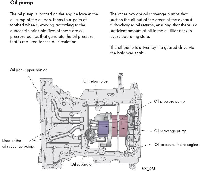

The oil pumps:
Functioning of the oil scavenging
system in different driving states
In order to ensure functioning of the compressed
oil system, with the correct filling level in all
driving states, two oil scavenge pumps are used.
The following examples describe the oil
scavenge system in three different driving states.
