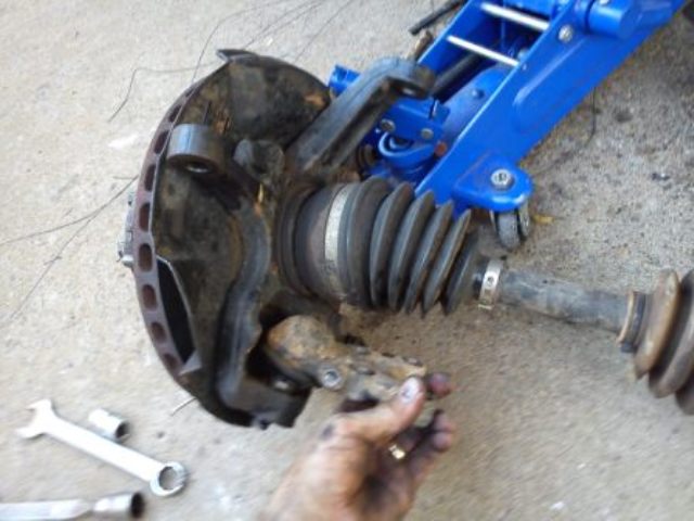

Photos
Some photos of my labour

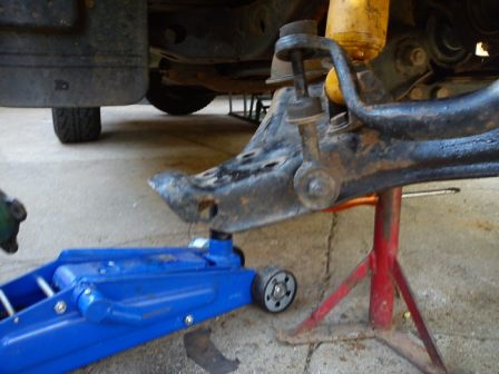

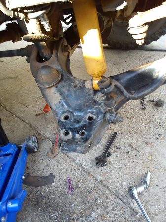

Suspension arm is closed over as seen from the side

Cobvs wrote:Some photos of my labour
Your battles are your punishment for using a "Free State Micrometer" ! :lol:
Those are "inappropriate tools" in any decent workshop!

Mmmmm Free State Micrometer - alias shifting ... did not have another 14 spanner to remove the CV from the side shaft. Its also useful as a persuader ... :mrgreen:
