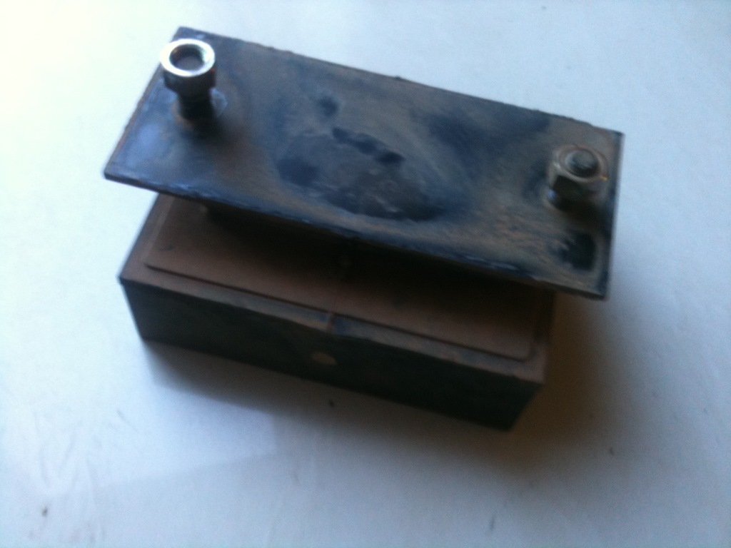

Hi Gerrit
I decided to do a little investigation of my own after reading your replies. I activated the video recorder on my cellphone and placed the phone under my Paj to record the front prop as I very carefully drove it(my insurance have already paid for a phone that I had parked an 8 Ton truck on 2 years ago).
I recorded the front prop turning as I drove over my phone slowly in 2H.I called another technician at Mitsubishi who confirmed that the front prop does turn in 2H but is not driven by the engine at all. After a discussion about my vibration problem, he advised me to remove the vibration damper just before the rear prop. I removed it and the the vibration is gone.
Apparently, Mitsu removed the damper on later models.
I have included a pic of the vibration damper below:
