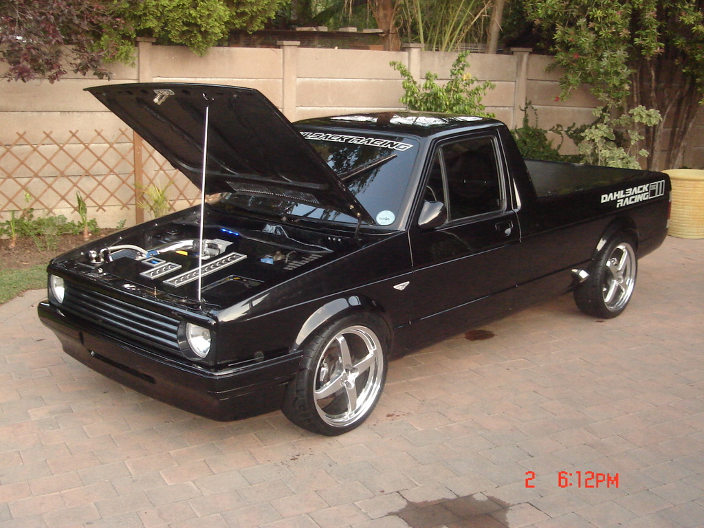

Be careful, I had a problem with my VW bakkie once where the battery on the remote went flat. There is no point in phoning a locksmith...
My VW bakkie SOLD
My VW bakkie SOLD
To many of these Autostyle modifications is rubbish. Believe me I had allot of them screwed on to my bakkie.
