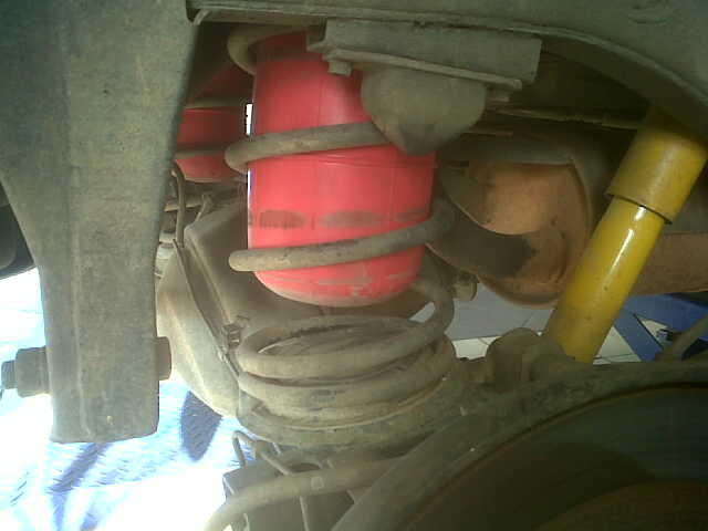

My 1997 Pajero 3.5 Lwb's rear end was starting to hang quite low when fully loaded and when Venter Bush Baby was in tow. I went the air lifters way and I've put in the Airlift 1000 kit (under R2000 from Gremeltech, Cape Town 0215114615) with 2 seperate manual airvalves in the rear bumper. When I got him back last night from the guys who did the installation (Specialized Air & Clutch, George 0448781306), he looked liked a bulldog with his rear end standing way up in the air :lol: . I checked the air pressure which was on 1,5bar and 1,3bar :?: , so I lowered the pressure to 0,5bar as recommended and now he looks good :D Can't wait for our next camping week-end, mid May, to see how he handles the trailer :?:

The first pic is of the Pajero before the "airlifters" were installed, I've not towed the trailer after the installation of the "lifters" and the second one is proof of fitment of "airlifters" when I've had my tyres changed.

In the Jan/Feb 2011 "Wegry" mag on pg 12, Mr van Heerde from Hopefield, wrote that he had "air helper springs" fitted to his Land Cruiser 60 Series. He said that he had the system installed with a t-piece between the 2 airbags so that when he do some serious 4x4ing the air could move freely between the 2 airbags, he did the "Road to hell" close to Goodhouse when he found that he is losing traction to such an extend that he had to completely deflate the airbags to get traction again. He eventually had the airbags taken out and the company who did the installation and the specific airbag company refunded him his money. He had no wheel articulation :!: :roll: :o
I've taken what he said into consideration and that is the reason why I had 2 separate air valves put into my setup. I am planning on doing the Baviaanskloof on the week-end of 8-10 Apr where I will definitely do some of the 4x4 routes. I will then see what the airbags do and how they influence my PJ's traction. The reason for the 2 different air pressures I had after I received the car back was only because the guys who did the installation wanted the airbags to get properly into place. :D
