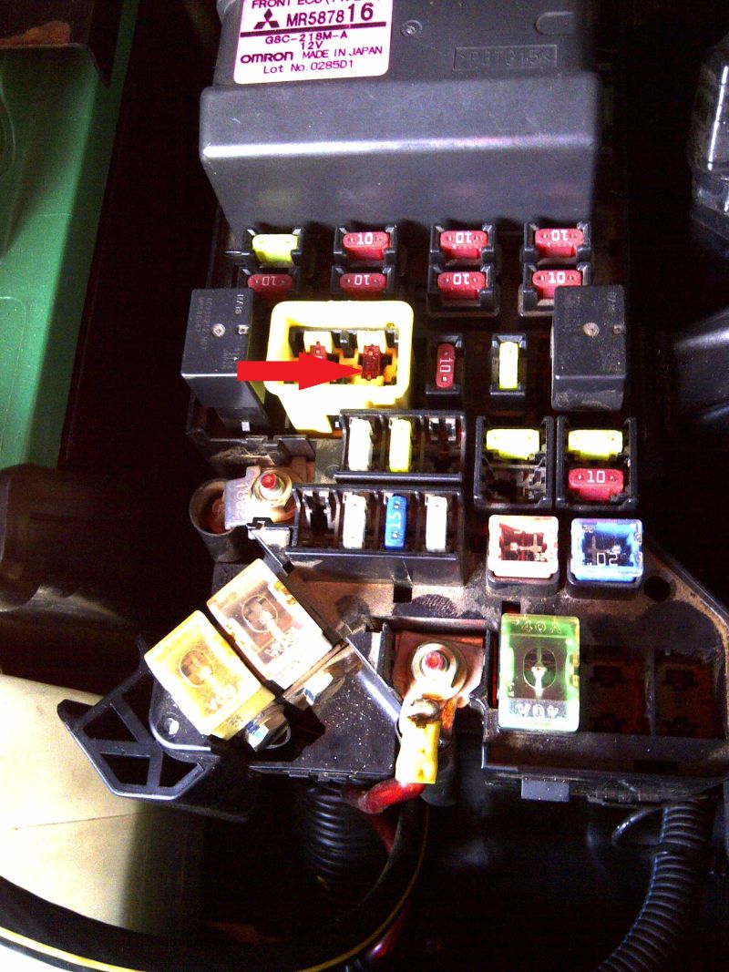

Hi. I appear to have the same problem after replacing the rear door light with a led version. Central locking, radio and display dead on 2001 did pajero. Cannot find any blown fuses and no fuses effect all those items.
I removed the led, disconnected the battery for a day, but still same problem. Does anyone know how to reset ecu for faults, as might be disabling circuits in some sort of safety mode? Any advice would be appreciated. Regards Bennie
Hi, attached is a image of my faulty fuse, not too sure if this will help, good luck!
Thanks a million. Everything works fine again. Was blown rear light fuse, but not sure how this could effect the rest - was real pain driving without central locking and radio. Leaving light disconnected for now... I owe you a beer - give me a shout if you come to Windhoek.
