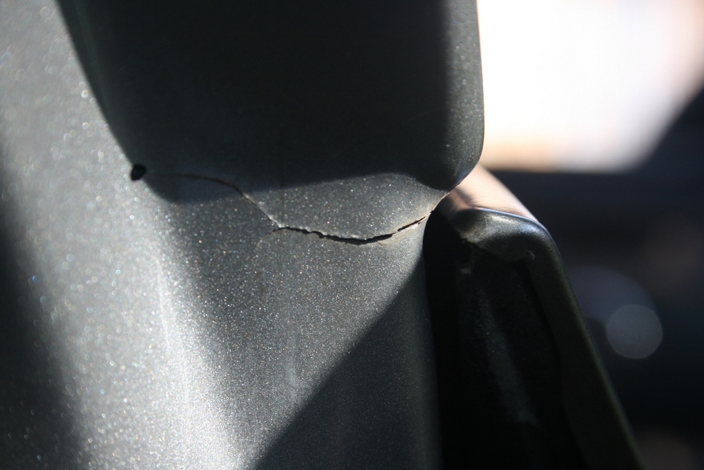

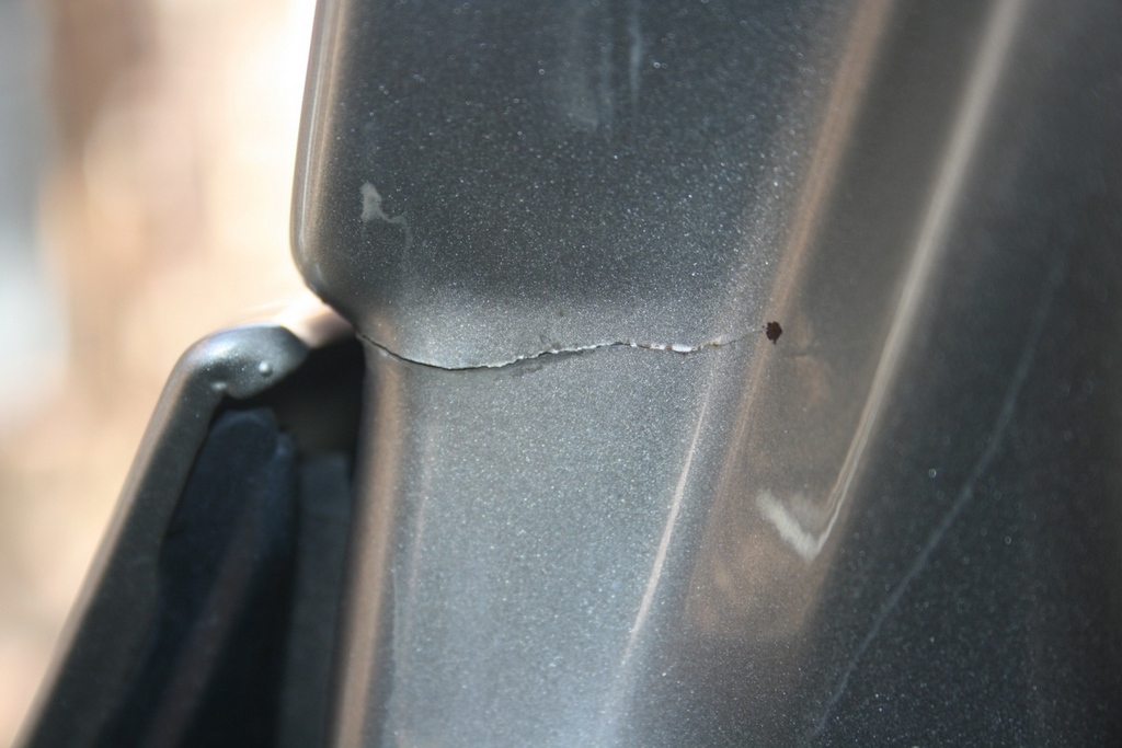

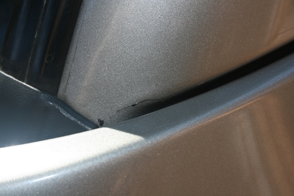

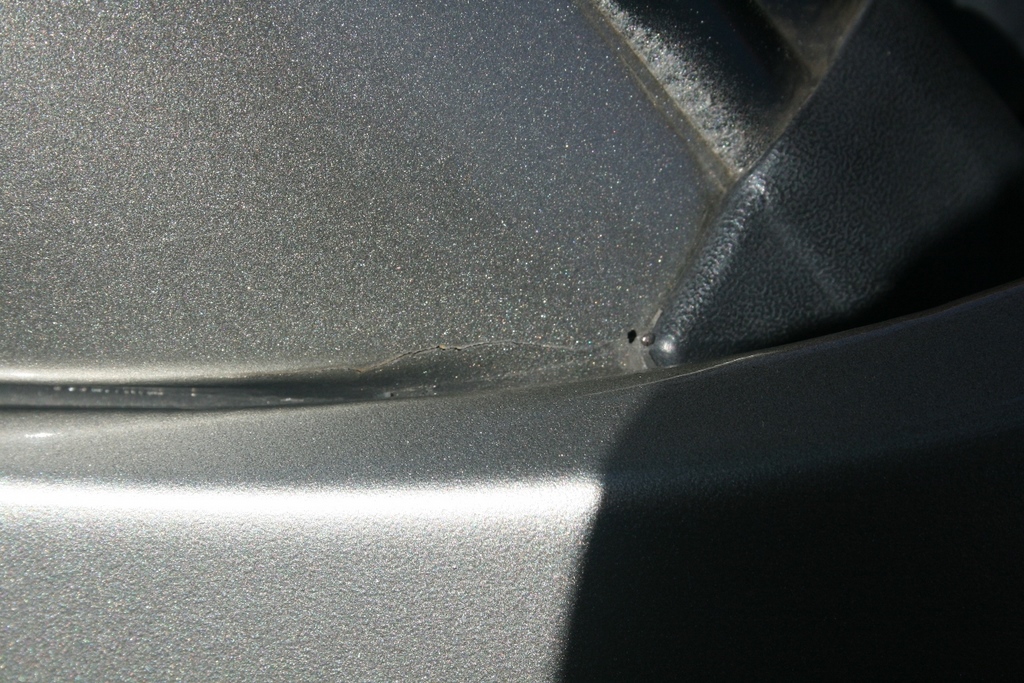

A gen 3 SWB did is cracking on both front pilars right behind the mirrors. Did anyone experience similar problems? The vehicle was never in an accident before.

I am the unfortunate owner :( of the vehicle that Herman is refering to. If I can figure out how to post photos, I'll do so tonight, I'm new to this forum :)

Thanks for the thread, I'll definitely read through it. There is no indication that my vehicle was ever fitted with a roofrack, therefore heavy loads could not have been the cause.
Re your previous comment, I am in Centurion but the only fitment centre that can possibly know about it is CCD, where my son-in-law works. He is actually the one who first saw the cracks.
Right
Right
Right
Right
Left
Left
Left
Left
Re: Cracks on pilars
Thanks for the photos. I will check mine as well and report back.
