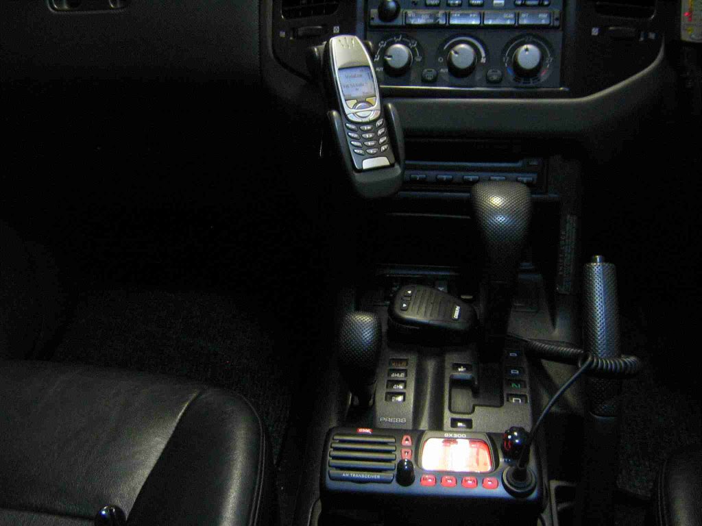

Hi Guys! MFCW. Fitted mine in the tray in front of cup holders. Works perfectly and when radio removed it looks reasonable. Check photos! Hope this helps!Wit Olifant wrote:If you remove the cupholders in the centre console, the GME fits very nicely in there. I simply made a little bracket onto which to mount the GME so it's easily removable for when I swop it between vehicles. There is already power available from the plug inside the armrest box, and the antenna cable should be more than long enough.

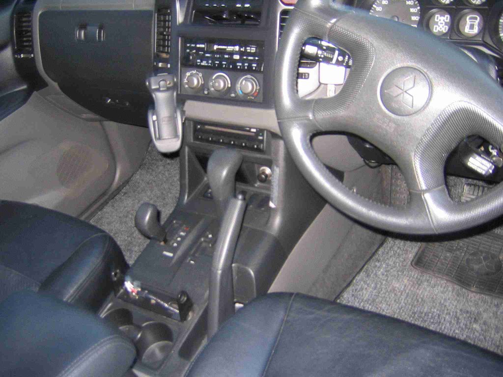

Sorry, forgot to include photo without radio fitted. RegardsBlister wrote:Hi Guys! MFCW. Fitted mine in the tray in front of cup holders. Works perfectly and when radio removed it looks reasonable. Check photos! Hope this helps!Wit Olifant wrote:If you remove the cupholders in the centre console, the GME fits very nicely in there. I simply made a little bracket onto which to mount the GME so it's easily removable for when I swop it between vehicles. There is already power available from the plug inside the armrest box, and the antenna cable should be more than long enough.

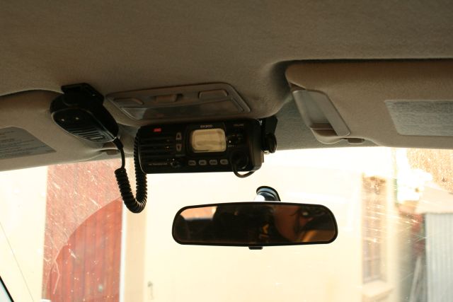

On my GLX 2006 model, I simply made a small plate, inserted it into the roof lining above the mirror / lights, and pop rivitted (with a fat rivet) the bracket to it. Now my GME GX 300 has a neat home, easily viewable and at ear height for sound quality. The mike catch I simply screwed (self tappers) into the roof lining above my left ear, a distance away so that the curly wiring is almost flusg with the roof, and NO interference with the mirror. This works well (just wipe down the lining now and then due to grubby gloves!).

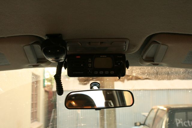

After fitting the drawer system and before leaving for KNP, I had to sort the comms. Well, I opted for the roof in front of the rooflights and think it turned out quite ok.Antenna is mounted on the nudgebar, next to the spots. The GME's bracket is fastened to 2 aluminium backing plates through the rooflining.
