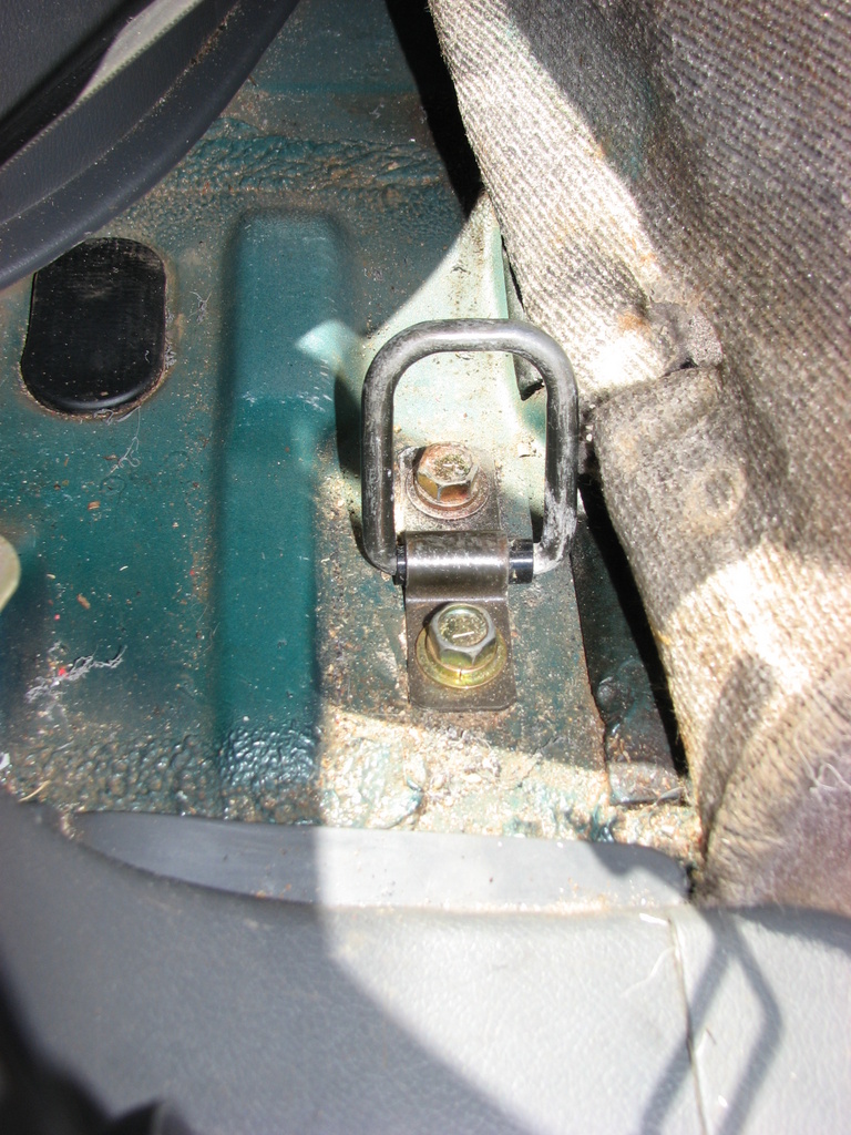

The Pajero has 4 heavy duty tie downs in the back and I thought I'd exploit the 10mm bolt-holes into which the tie-downs are mounted. I hate drilling new holes into vehicles and this arrangement suits me fine.

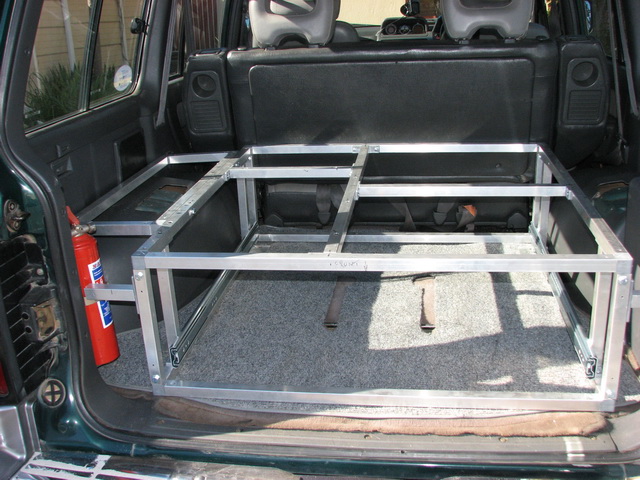

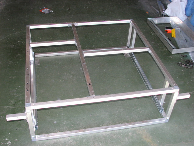

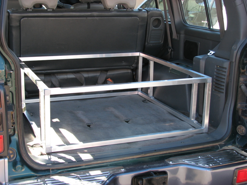

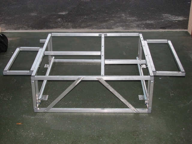

The picture below is of the basic frame, checking for fit before I started putting it all together.
The frame is now complete, and the rails installed. The two little "arms" are the supports for the wooden covers to neaten everything up. The bottom left (in the picture) "subframe" is where the fridge slide will be bolted onto (you can see the holes for the 10mm bolts).
The frame inside the Pajero. You can see an additional frame on the left hand side. This is to support the flooring which goes over the wheel arches. The idea is that the wooden flooring covering these is removable so you can tuck small things out of the way. I had intended to mount the compressor inside the gap, between the wheel arch and the door but my Max Air compressor is too big.

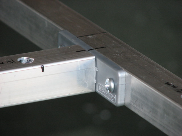

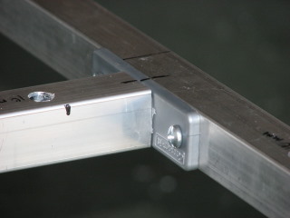

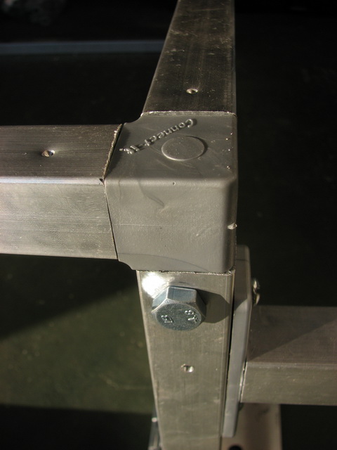

OK, just some detailed shots. Below is how the Maizey Connect-Its work. The bit that slides into the aluminium has a small hole. The idea is you whack a punch into the aluminium where the hole is. The resulting "dent" hold the connectors in place. I didn't like that idea for the verticals so drilled straight through the connectors and used 8mm bolts instead.
This is the Connect-It brace piece.

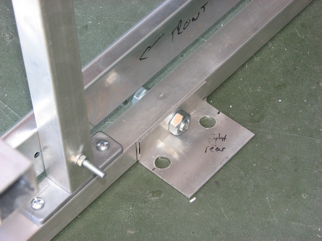

The shot below shows the bracket for bolting the whole shebang to the floor of the Pajero.
And this is now where I'm at. The completed frame from the back, together with both the side pieces. You'll notice i added some braces to add some lateral stiffness.

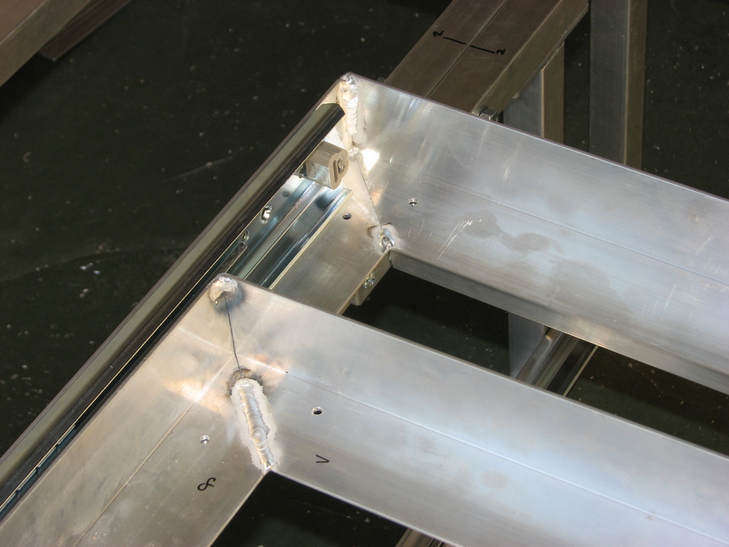

I have cut all the materials for the fridge slide and the draw itself. I had intended to bolt all that together, but I enlisted the help of someone at UCT to weld that up for me (so will cost me a couple of bottles of my best Pinot Noir)

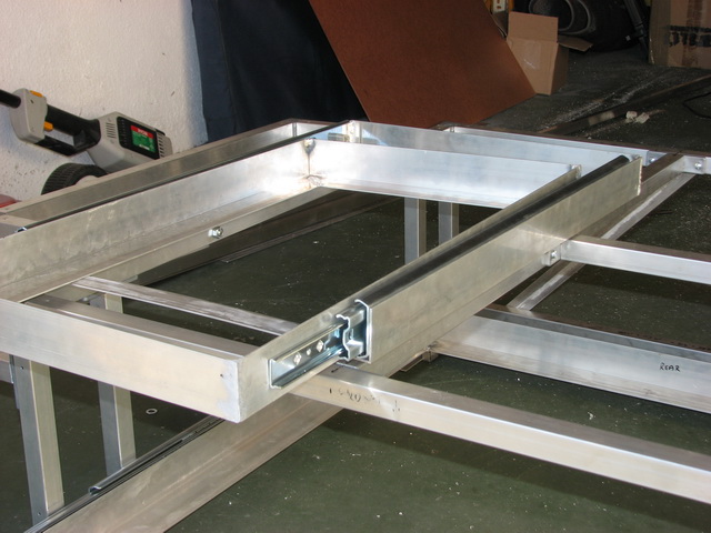

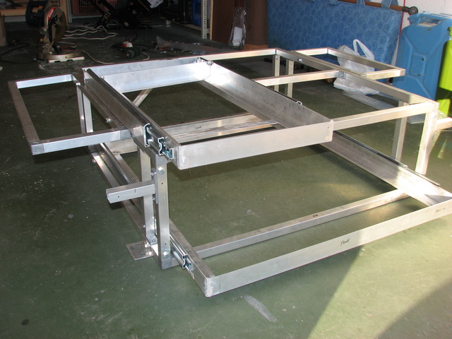

So here's an update on my packing system. The frame for the drawer itself is complete, as are the two frames for the fridge slide.
I built these frames from 50mm aluminium angle. If it was from steel, maybe I could have gotten away wiht something smaller, but it's pretty robust, hides the slides, and strangely, is a little cheaper then smaller profiles from other vendors.
This is just a general view of where I am at now. The slides and everything haven't been screwed together yet - things are just resting in place
Slightly closer up view of the fridge slide. The fridge will be held in place with turnbuckles inserted into holes in the frame.
A close up view of the corner of the fridge slide

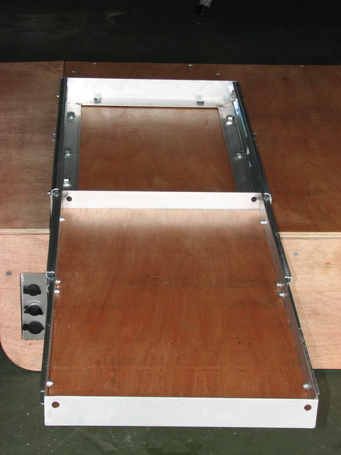

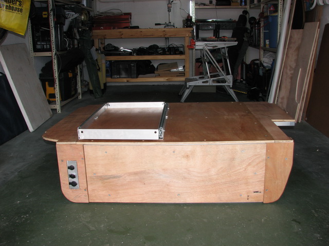

The framework was completed a while back and this is how it looks now with the plywood installed, and cut to shape.

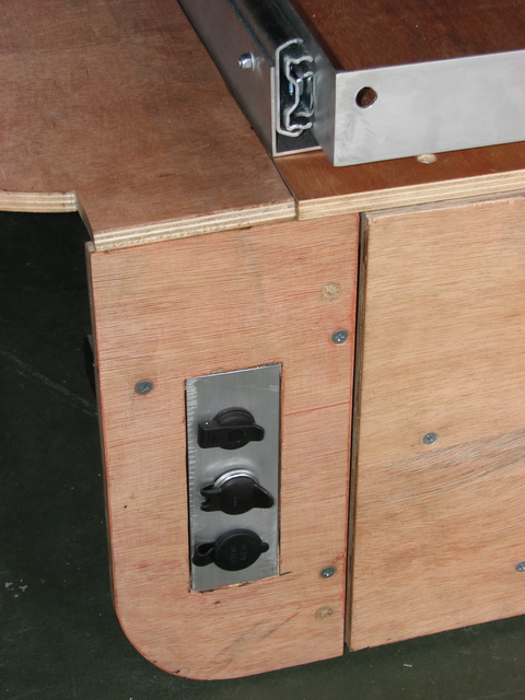

The gap between the draw and the edge on the right was measured perfectly when in the vehicle, but as always, something becomes a little misaligned when it's all put back together :evil: , so will have to shave a little off there. On the left are two hella's and a standard ciggie lighter socket. Above those will be a Brad Harrison for the fridge (detail below)
The aluminium plate which houses the plugs will form a common ground to make wiring a little simpler, but will be covered with carpet so you don's see it.

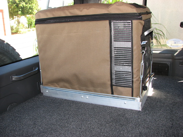

Just some detail of the fridge slide, bolted down with 8 10mm bolts. The idea is that the fridge slide be easily removable if I need to.

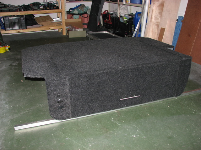

I wish I could invest in a real workshop :oops: , but I'd have to buy a decent house first....
Anyway, I have finished the carpeting, and am pretty pleased with the results.
In the background you can see the fridge slide which will be installed tomorrow. Really, all that's now left to do is actually install it in the vehicle, and connect up the electrics.

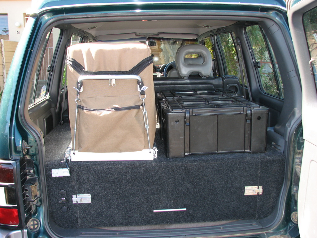

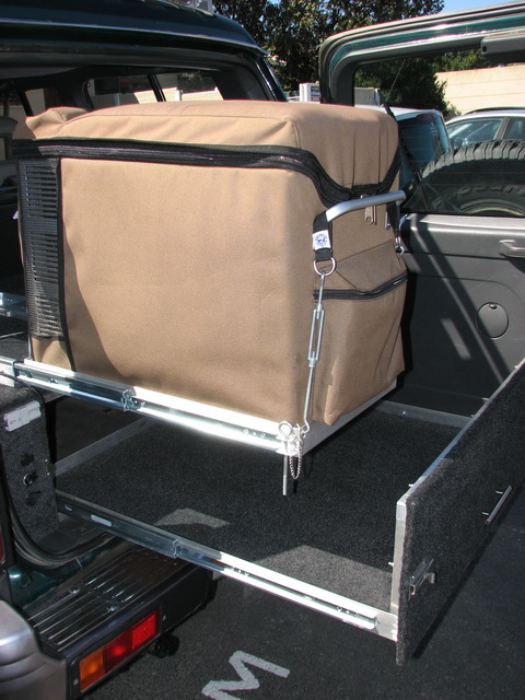

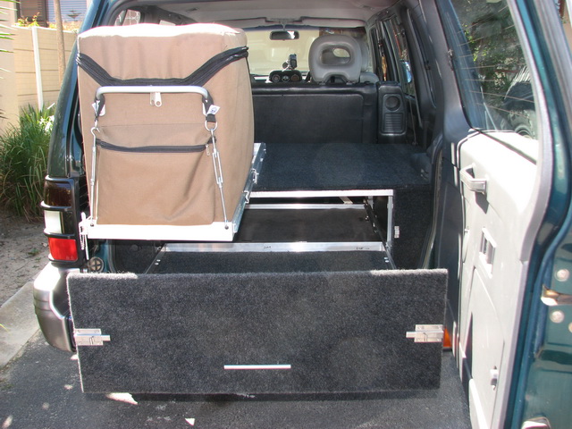

I have finally finished :D :D :D
It's taken much longer to get this project done than I originally thought it would, but tadaaaa!
This is just an overall view from the back with fridge and drawer out
And from the side

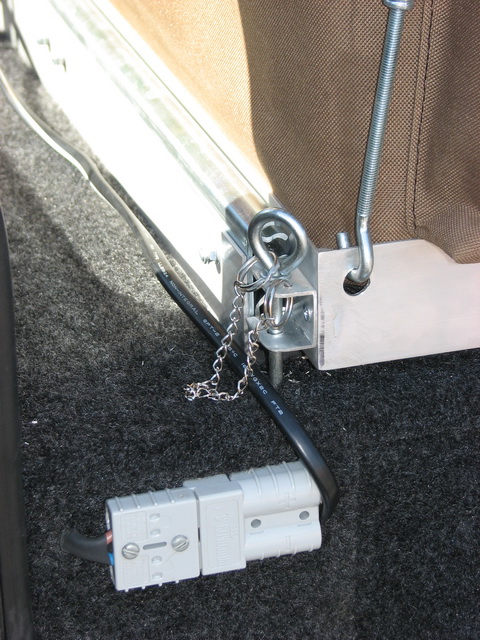

And a view from inside. Not much clearance between the door and the fridge handles :shock: but it worked out OK. You can see how I've secured the fridge to the slide using turnbuckles.
