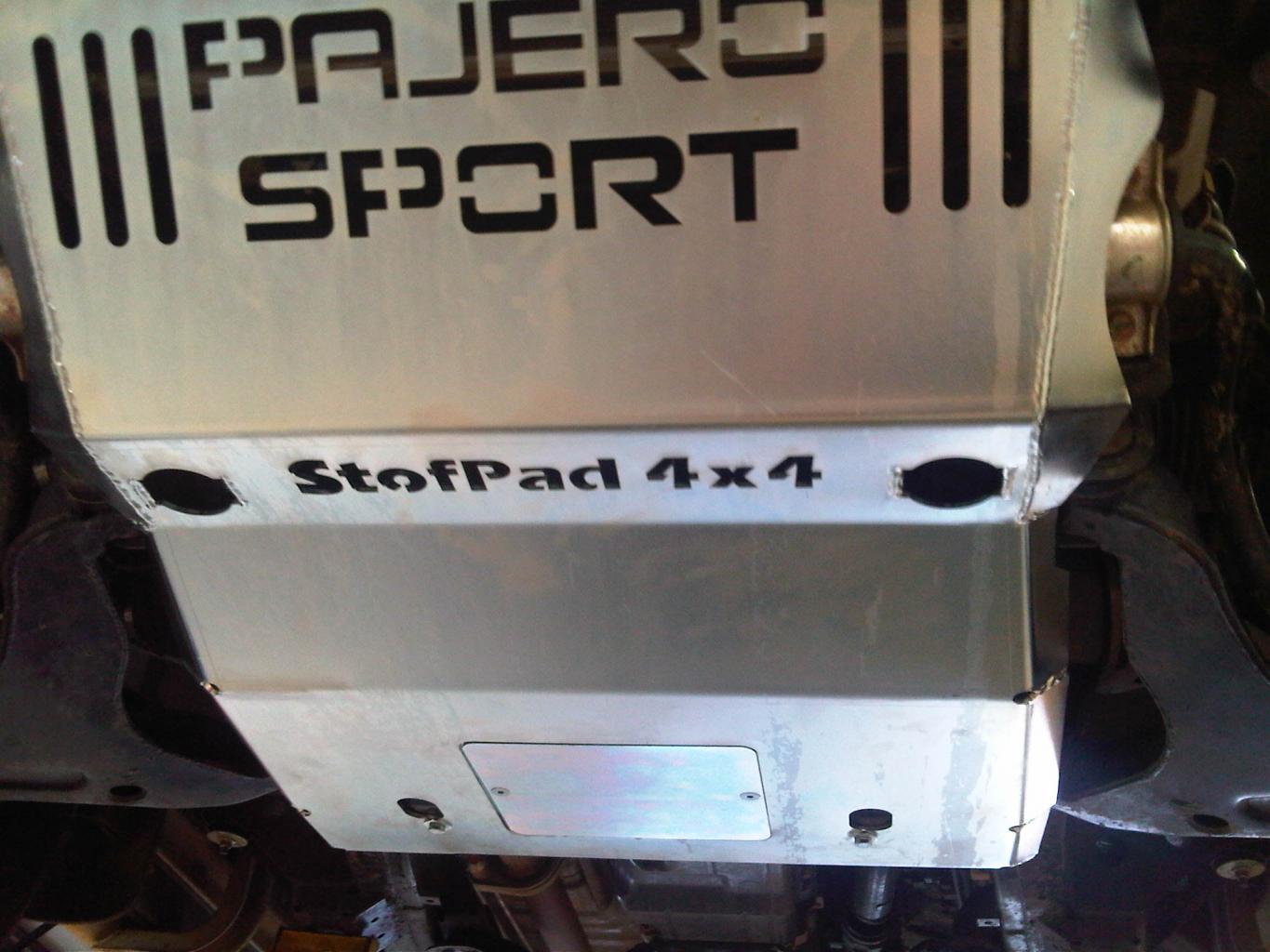

Would the bash plates be supplied by Mitsubishi ?

Uys @ Stofpad 4x4 makes the bashplates. Mitsubishi doesnt have what you are looking for.
Look here: https://www.4x4community.co.za/forum/sh ... 96&page=11
PAJERO 3.2 LWB GEN 4 AUTO
Lilylou
Re: Essential/nice to have accessories/modifications
That looks really good!!!!
